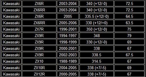

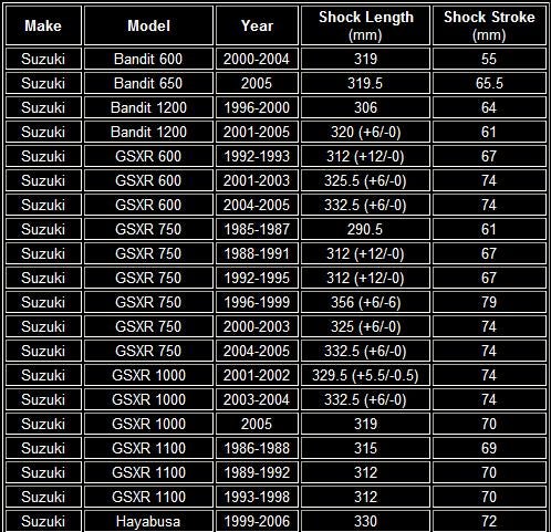

Shock Length Chart
Thanks to PP from Oldskoolsuzuki .This chart is a useful starting point for anyone wanting to replace the standard shock in their bike. You will obviously need to match up length and stroke of your bikes shock as closely s possible - be careful though, this chart does not cover top and bottom shock mount types, reservoir type and position, spring rates or internal valving

im not exactly sure how to read this. i know a 1993 gsxr750 shock and a 2004 gsxr1000 shock are different but are they close enough ?

FYI - a 626 will perfectly mate up with a 04+ SV650 with just a little cutting into the battery tray.
also the dogbones are very easy to replicate to jack the arse end up.

a zx10 shock on a sv is a direct bolt on. at least for my 03 sv.

a gsxr 1000 07 will fit a gsxr 750 94 , but you will have to make some spacers becouse it is bigger in the coil diameter and it will not go throw the wishbones. It will work just fine whit spacers
