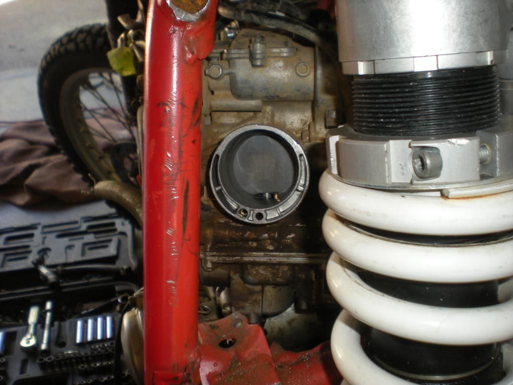

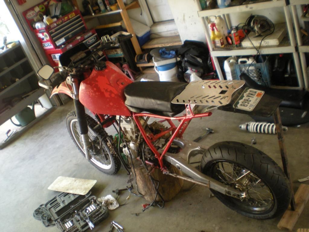

finished up the fab on the subframe today so now my crf seat and the husaberg shock fit.
ground down all welds and cut off the unnecessary bits

threw the front shocks on just to see how its gonna look
