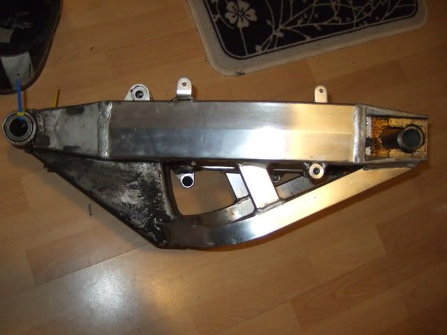

another thing
yes i am very slightly obsessive compulsive, i work on bikes (not for a living) a lot,
going to stretch a busa arm , which can prove to be a bone of contention with newer streetfighter builders who think they have no place, well as far as i'm concerned ...........they do
but that being a whole can of worms lets leave the lid on it
this is the starting point

suppose i better get my lazy arse in gear
thats the arm squared up
and parallel to the pivot tube

and started machining up 14" lengths of aluminium

excuse the lack of detailed shots , nothings welded in and i'll take more
i machined the slots , and pockets for the adjuster blocks
then machined the 60mm long stubs that insert into the arm
which i have no pic of but i'll get one
on the upside tho , they fit

the adjuster blocks are milled , just need the holes in them
and the hole for the adjuster rod is through the extension

realise this is over so here's the final instalment
just got the adjuster blocks to counter bore
