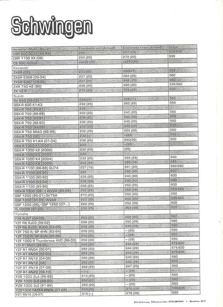

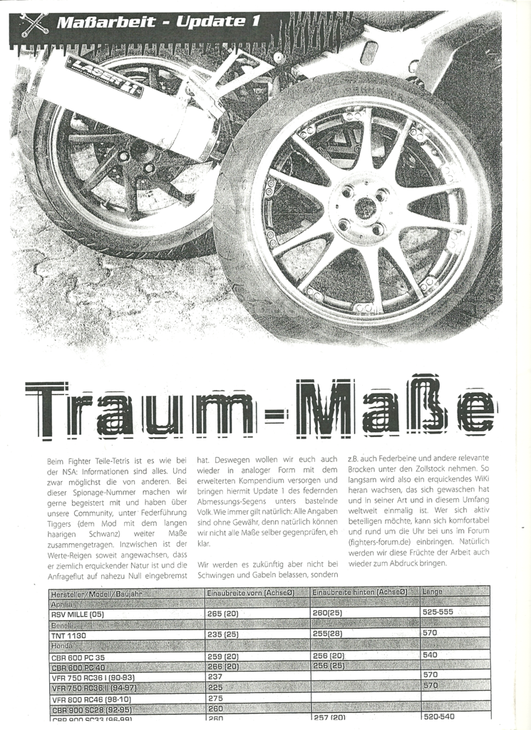

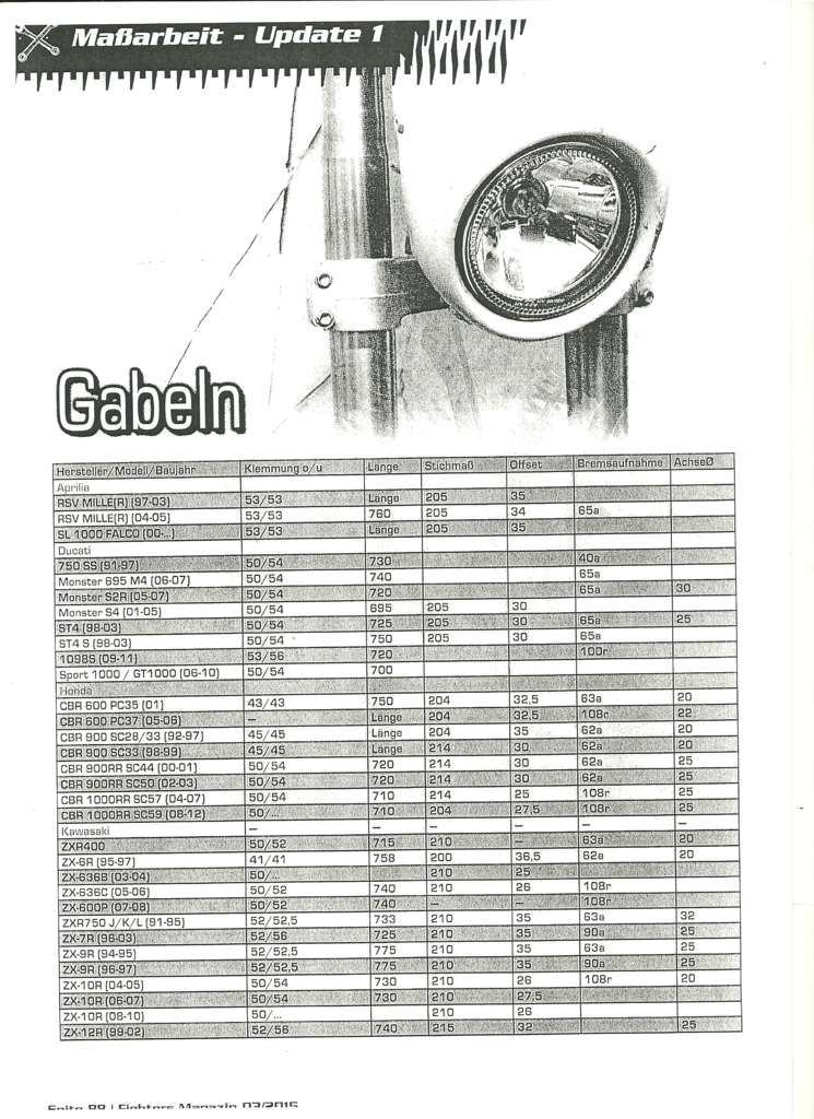

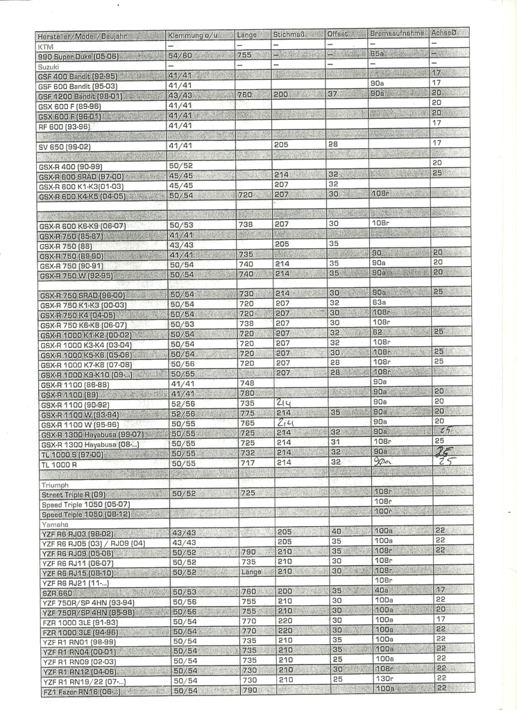

Just found these in a local Fighter Mag.
Forks
Gabel is Fork
Klemmung o/u is clamps top and bottom
Länge is length
Stichmaß is width
Bremsaufnahme is brake mount
Achse is Axle
Schwinge is Swingarm
Vorn or Vorne is Front
Hinten is rear or back
Einaubreite vorn is swingarm pivot front
Einaubreite Hinten is Rear Wheel mount
(Einaubreite is a typo for EinBaubreite)
AchseØ is axle diameter
Any other German translations needed let me know

Very useful data. I see it mostly includes sport bikes, though.
I'll have to take myself the dimensions of my NC700x
