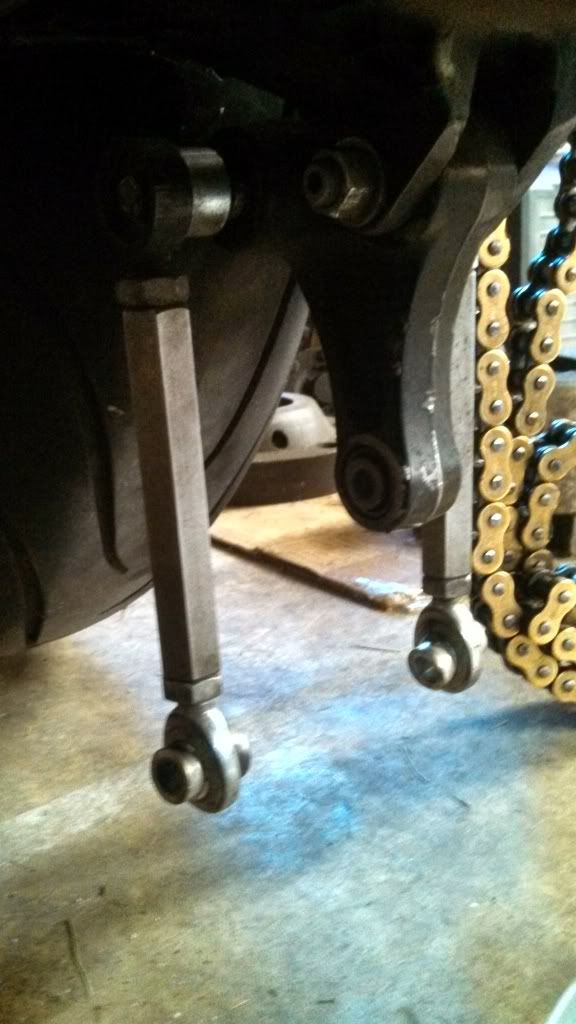

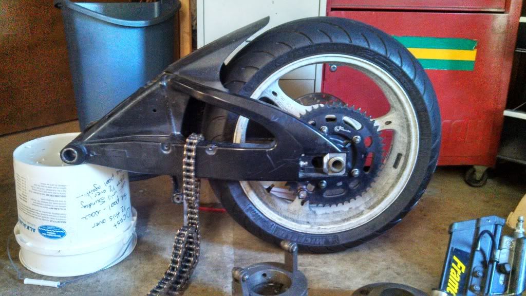

Got an 06 gsxr 600 rear end for sale. Swingarm is powder coated black, rim powdered white. All bearings and cush drive rubbers have less than 800 miles on them. Same for the tire (Michelin 2CT 180/55/17 ). The sprocket is a custom 50 tooth/ 530 chain / 4mm offset. The dog bones/links are adjustable, brakes and brake line included.
The only thing not included is a shock. Everything works great, just selling because i could use the money for my other projects. Parts are a little dirty from use but I'll clean them up soon. Asking $300 for everything plus shipping.

Getting the calipers out now
EDIT: I messed up on my math converting 8 7/8" over to metric. It is supposed to be 225mm without the tophats.
I had to find the original spacers that came with the arm when i bought it. Apparently i had grabbed a set of Bandit tophats when I measured last.
As you can see its a 22mm pivot. Sorry for the confusion guys, I'm an idiot sometimes
