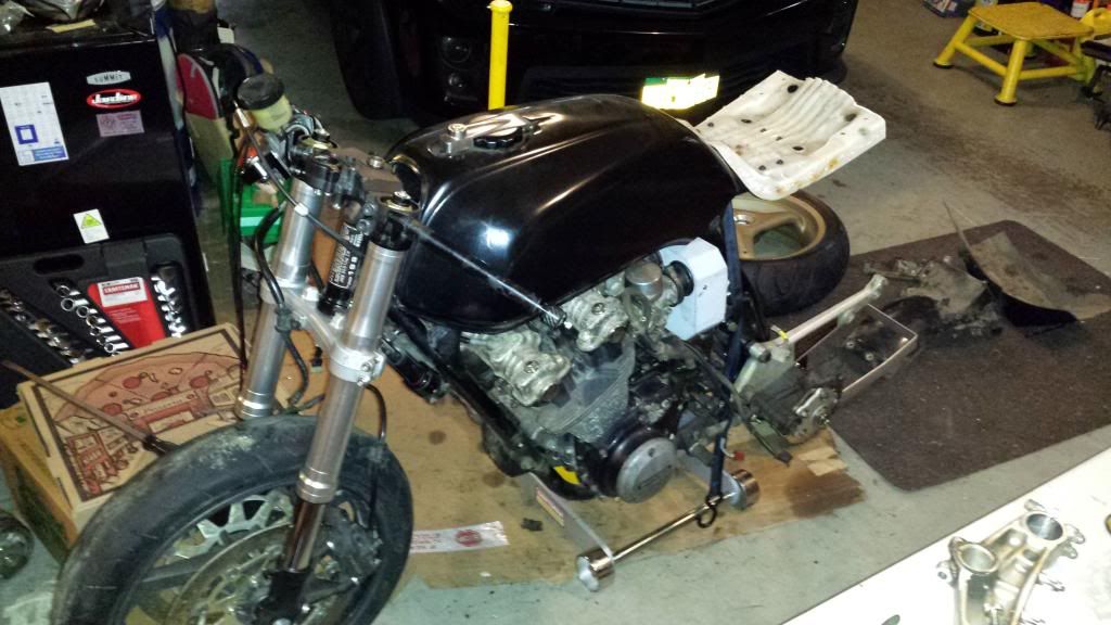

The Tear Down:
Currently:
The front forks are off (I'll add some pictures soon) in addition to everything that mounts on them obvioiusy (Headlight, gauges, handlebars, etc.)

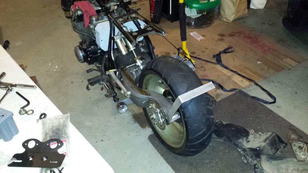

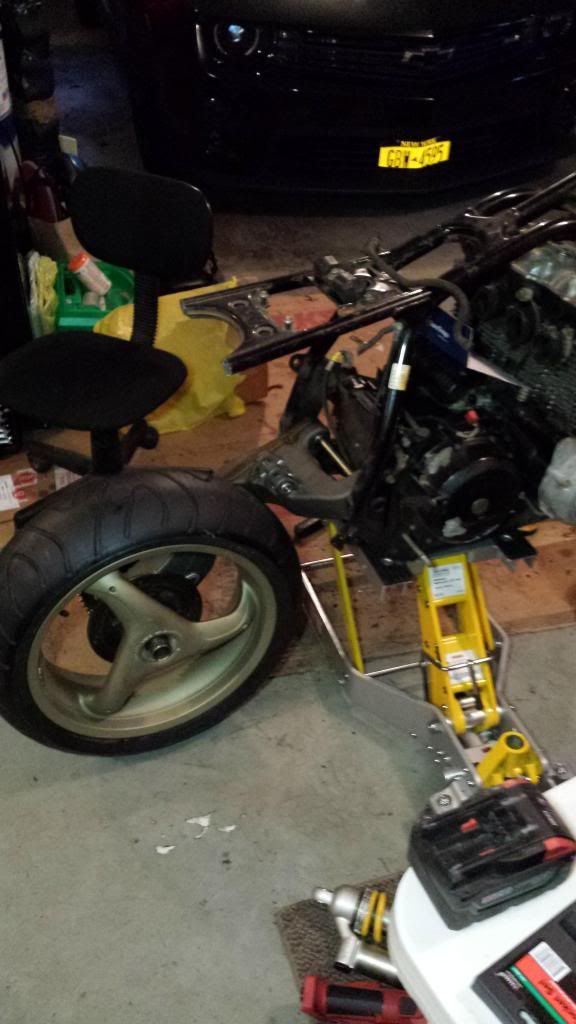

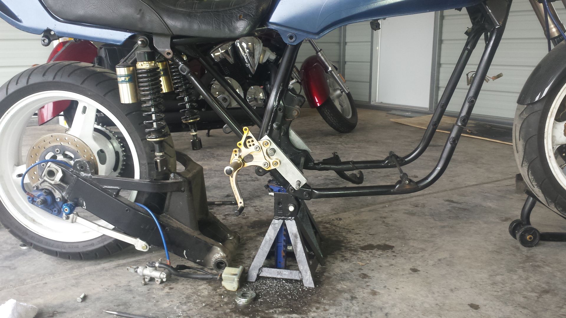

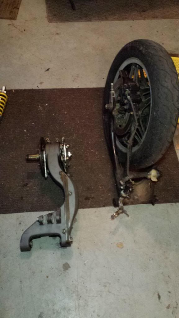

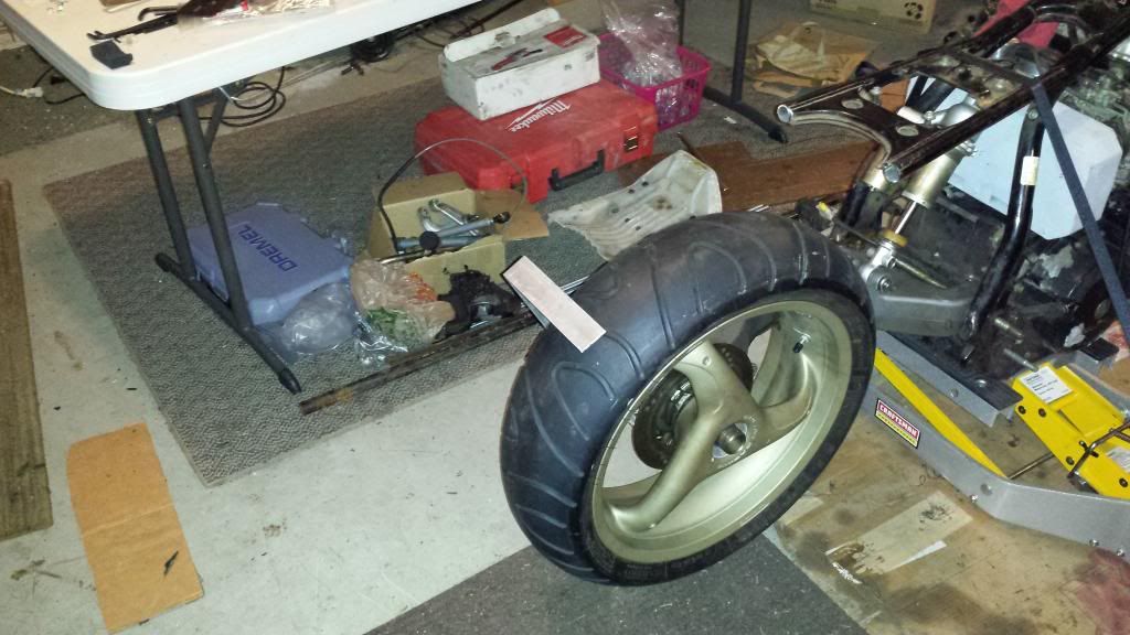

I bought a 2001 Ducati 748 SSSA after finding out that the pivot mount width was about 1 mm smaller than the stock 1982 swingarm making for a slightly less painful swap. Theres minimal clearance issues that I'm in the process of correcting now and the sprockets need only a minor adjustment to be lined up. Any suggestions on exact angle to place the shock's upper mounts would appreciated. I've been searching this topic a lot but haven't found much.
I just purchased a complete front end off a 2007 Honda CBR1000RR that should be arriving towards the end of the week and I bought the necessary bearings from All Balls Racing to go with them. I'll be using the clip ons and controls from the CBR1000RR as well.

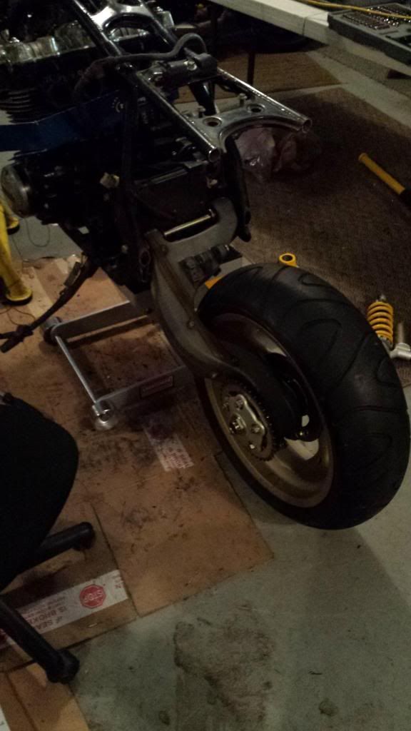

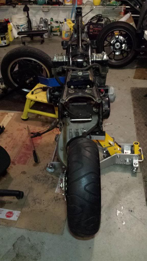

I only had the swing arm on quick to check for clearance issues on either side. Still need to find a pivot bolt that will work because the stock one for the '82 is too long. The tire looked like it was center maybe 1 or 2 mm off. Will that much be an issue?

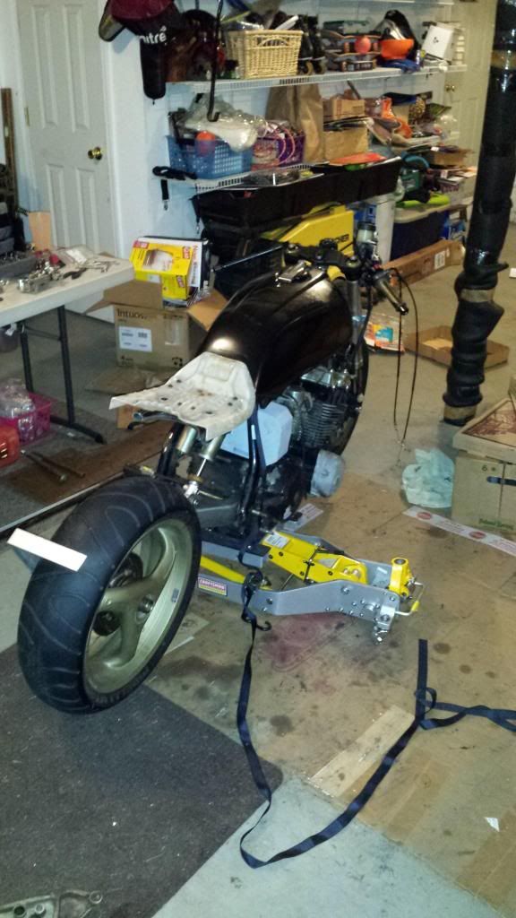

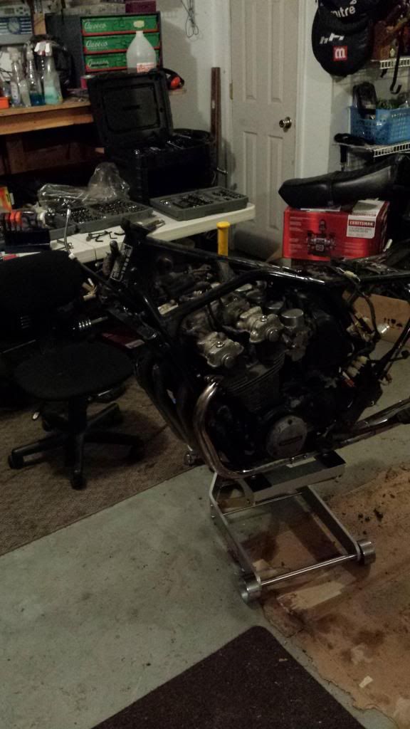

I've heard people have a very difficult time getting this bike to run correctly with the pod filters and the stock carbs so I'm attempting to fab up an airbox that will supply air similar to the stock setup but in about half the amount of space.
Im going to put a mail slot in the lower portion of this box facing the back of the bike with a filter going across the middle. That way the air will still be turbulated and not force feed the carbs at anytime

Thanks for the kind words. My plan is to get the swing arm on the pivot mount 100% and then see where I'm at with the wheel being centered and all. I need to start one piece of the puzzle and finish it. Right now I have the fork swap, swing arm swap, airbox modification and battery relocation projects all started. When one gets me frustrated I move on to one of the others for a while.

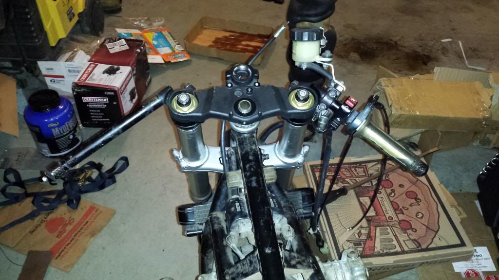

Forks arrived so i threw them on loose quick for a pic.
The 2007 CBR1000RR stem is the same diameter as the 1982 CB900F but its about a half inch shorter. I think if I shave the inside of the '07s upper triple tree I can gain about a 1/4" back without compromising its strength. The other option would be swapping the stems... Anyone know a way to get them out without damaging the threads?
111 Posts
Discussion Starter · #24 ·
Hydraulic press came yesterday and I got the stems swapped out. Everything was going perfect and then the stem starting spinning inside the lower tree while I tightened the nut on the top that has the shield that lays against the upper bearing. I took it back apart to see how loose it is and I can't twist the stem by hand so its snug just not super tight. Is that ok!?

Discussion Starter · #32 ·
Because it was snug but not tight I just held the bottom with a vise grip while I tightened the nut on top. It went on easy this way and I actually overtightened it to where the forks were hard to turn side to side so i backed it off a turn or two until it got easier and then i put the lock nut and upper triple tree on

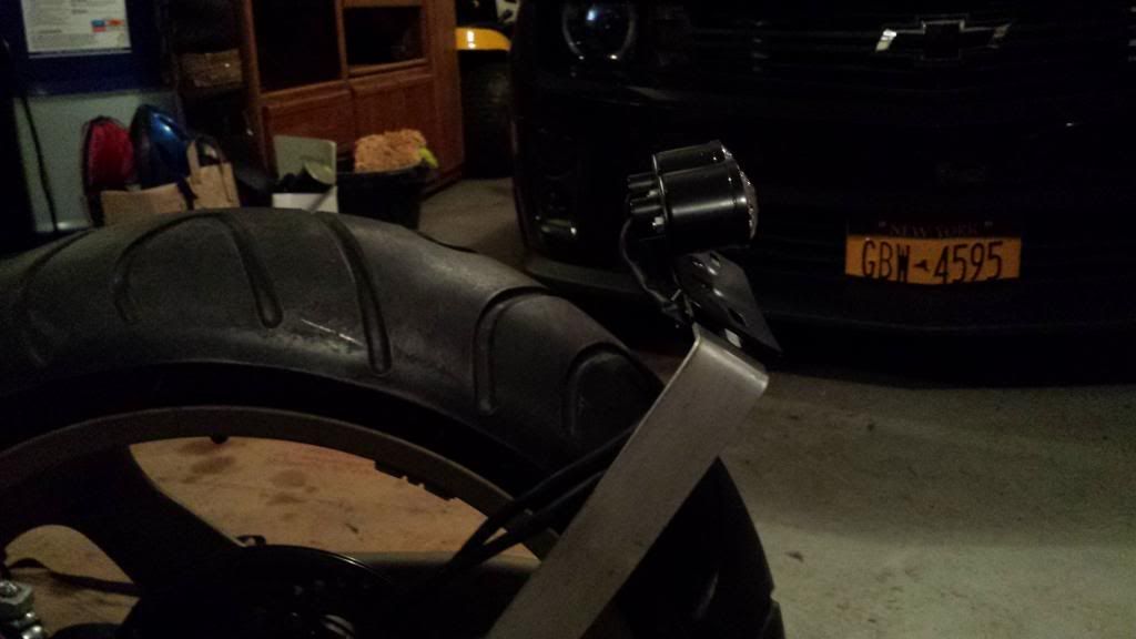

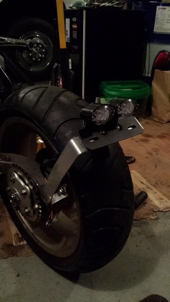

Spring arrives today, in the mean time I started to get a feeling for the wiring. I tore apart the stock harness and labeled everything that needs to stay and what needs to go. As far as the safety switches what do people usually take out and what usually stays? (clutch switch, neutral switch... etc)
I also got the brake lights mounted. It definitely looks different and unique, will try to get a pic up soon
