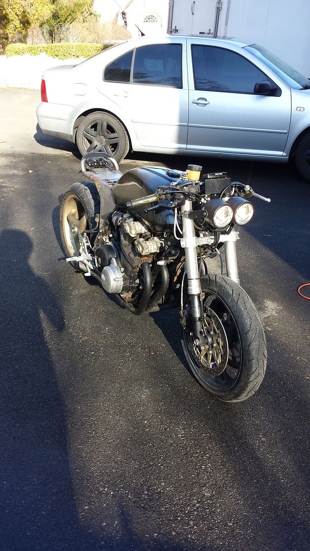

What about something like this? Its 3/4 al plate that is bolted on by the pivot bolt and engine bolt. The same two that held the original foot rest brackets...
111 Posts
Discussion Starter · #142 ·
On my set up that would move the rear sets a few inches forward which I can't afford to do (I'm 6' 4"). Isn't it the same concept I have, just with a cleaner piece of metal?
· The Hell You Say!!
2,985 Posts
I guess it is. It looked like you only had it bolted on through the pivot but I guess you are using 2 mounting points. I can see how that would make you feel cramped. Im 5'11 and it works for me. With the SATO rearsets I also have about 2'' of adjustability. I know you said your feet don't drag but seeing those pegs hang down below the frame rails makes me nervous
111 Posts
Discussion Starter · #145 ·
They have two mounting points currently. The pivot bolt and a triangular tab to the frame that i made as hidden as possible (in the pics you can only see the weld really). The lower mount is shared with the top bolt of the rear set. Still looking at ways to modify them but I think it will look much better when everything is painted and cleaned up.
Also, the lower bolt is about even with the base of the frame. Picture is deceiving a bit
2,985 Posts
I gotcha. Well then disregard everything I've said! I can wait to see it finished. It looks pretty tough as is
