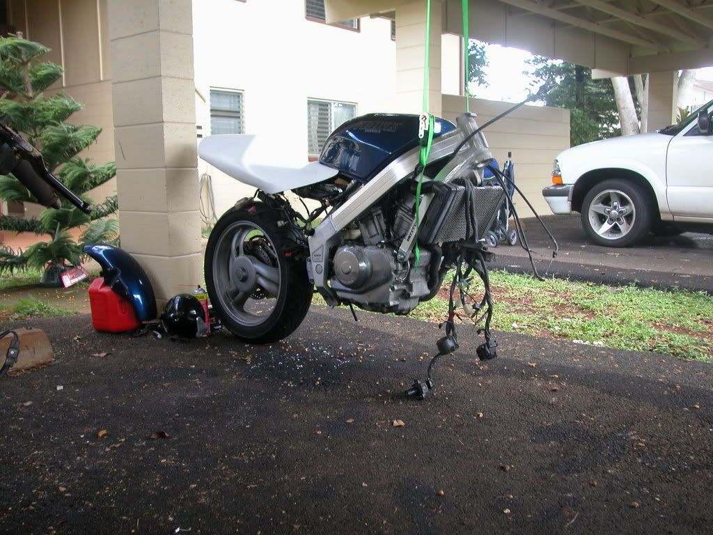

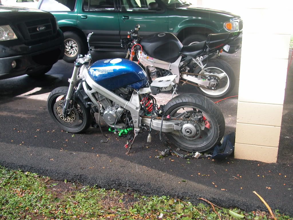

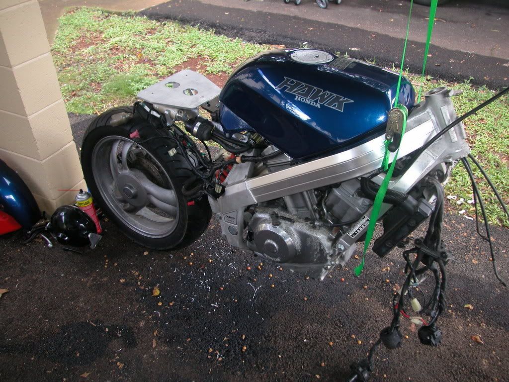

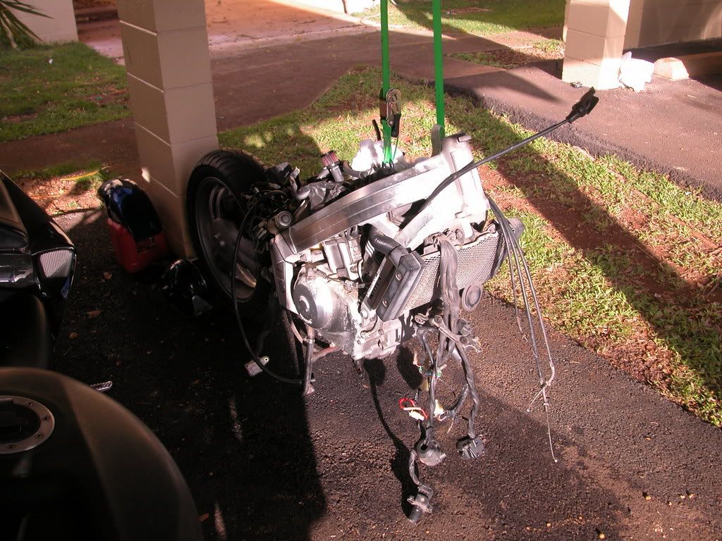

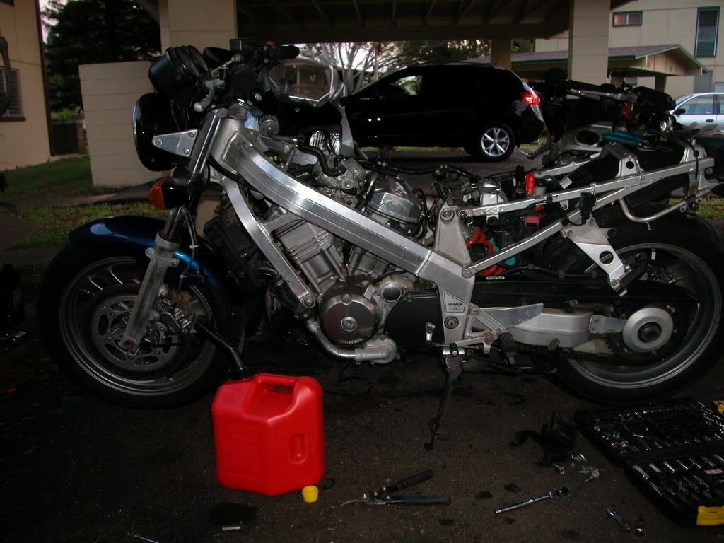

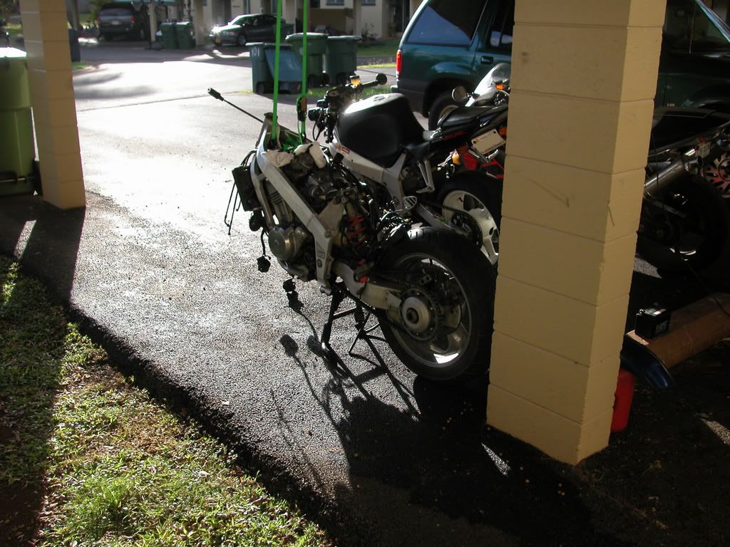

Well her is my wifes new bike. I am unsure if she is going to want to fighter it or go full fairing. Time will tell. Currently the inside of the gas tank is rusty from sitting for so many years, and Im going to replace the fuel lines as a preventive measure. Clean the carbs, however just pouring gas in the carbs and she runs. Aside from the normal changing of the fluids and what Ive mentioned, current plans right now are front end swap (00 or newer USD) and a new sub/tail. Bike already has the 900 cbr rear shock swap. Well pictures, sorry about the shot of my ass.
I hope to have it rideable with the new front/sub/tail by xmas time, but funds will dictate that.

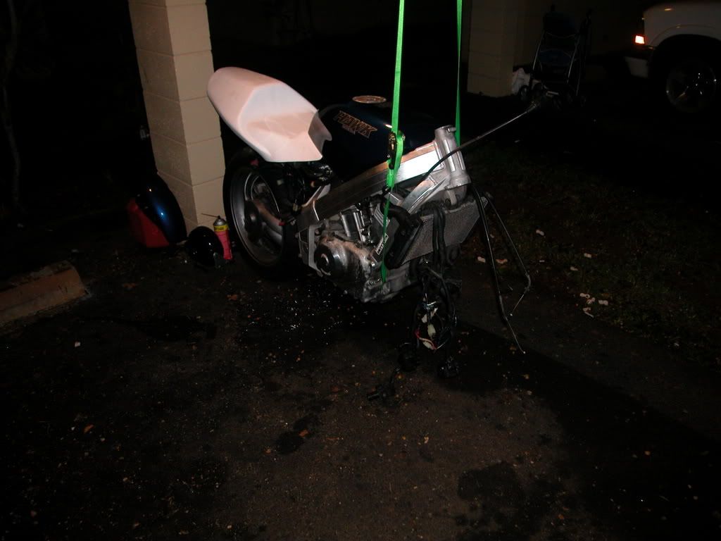

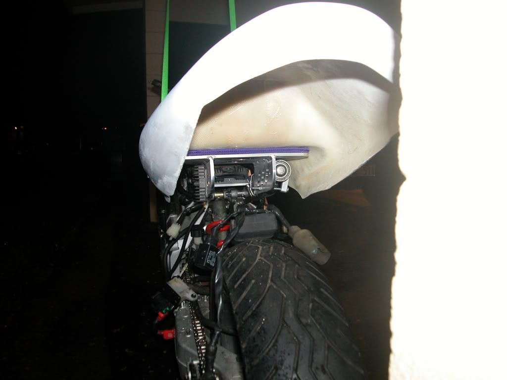

Got the subframe/tail/seat pad/res mount in the mail today. Still waiting on some more parts from hiperform. I also need to make some mounts for the cdi box and clean up the wiring.

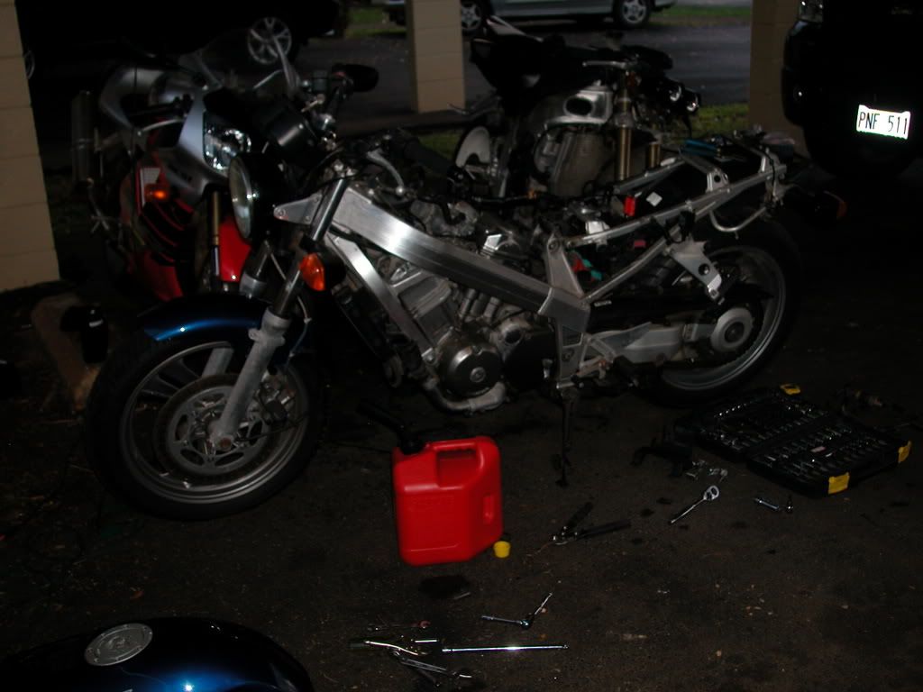

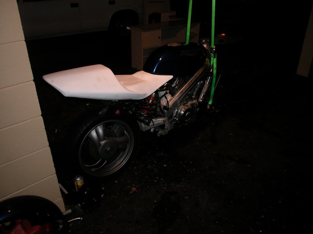

Well i managed to get my hands on a 954 front end. Complete minus clip-ons. He has them but they werent in very good shape. The tail is pretty much ready for paint, Ill snap a picture right before paint. Still waiting on some stuff from Rod at hiperform.
3
Cleaned up the thread. Here Is the headlight mocked up. I stripped and painted the headlight rim/trim pieces.
