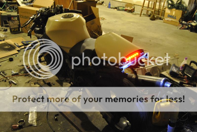

made more adjustments to the seat with some modeling clay, much better to work with than foam but way more expensive, hopefully fiberglassing over the weekend

Cut a slot in the bucket to make it fit better, seat is nearly there

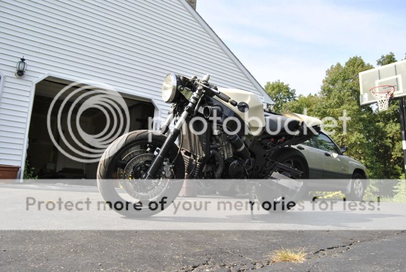

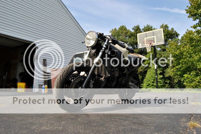

Here is where im at now, got a lot of parts in for the engine build, only thing that is holding me back from the fork swap is swapping stems, spent too much money on engine parts cant afford to swap the stems, hopefully monday.
