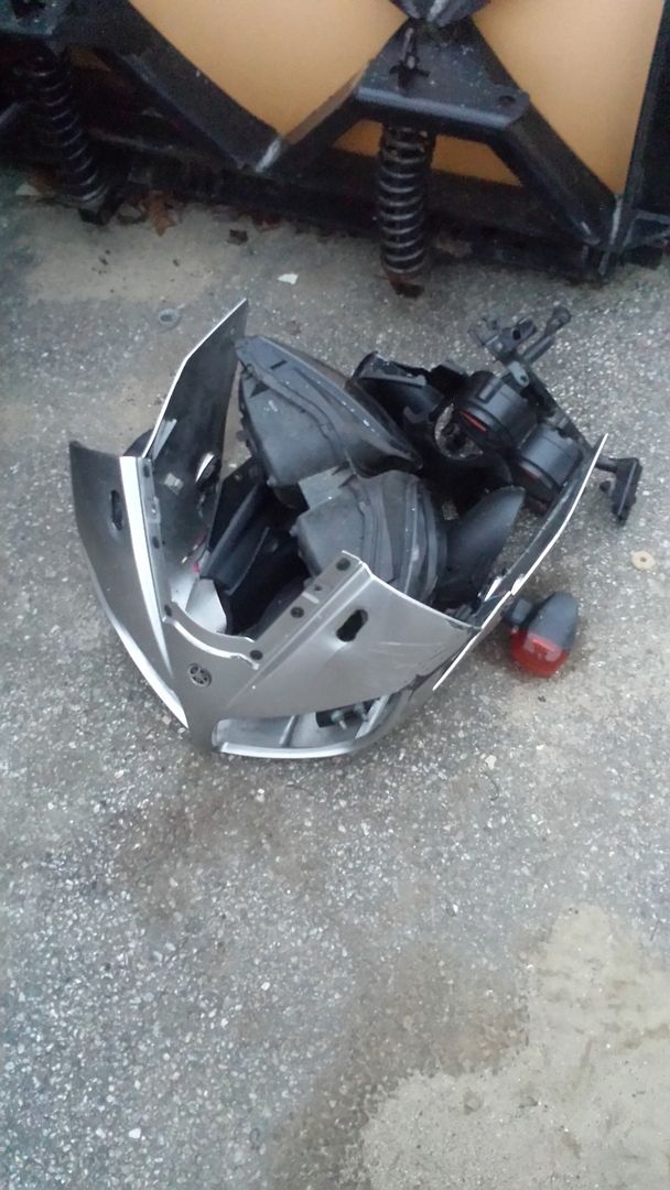

So ever since I got into riding bikes I had thoughts about eventually converting to a fighter... well I low-sided my bike in the fall so I guess you could say the time is right!
First step was the teardown of the useless broken crap
At this point I discovered that I also managed to bend one of my fork legs so the quest was on to find 5pw forks from the R1 to tackle this swap while I was rebuilding. I ended up paying a whopping $180 for all of this including forks!
