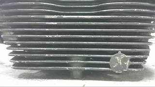

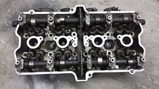

I bought this nice complete ******** the other day and I got it for much cheapness because the guy didn't know what it was. :D

I currently have TL1000 forks up front and A Gsxr1000 rear shock. Front brakes are 6 pots with wavey discs and rear is a VFR750 with wavey disc. All of the suspension will be rebuilt with new bespoke parts over the winter, all matched to my featherweight 11 stone frame (me, not the bike). The bike already has a stage 3 dynojet kit with K&N duals and a stubby can and the new head will be ported and polished before being fitted. I am looking to break into the 10's on the quarter mile, best time so far is 11.17 secs at 124mph.
