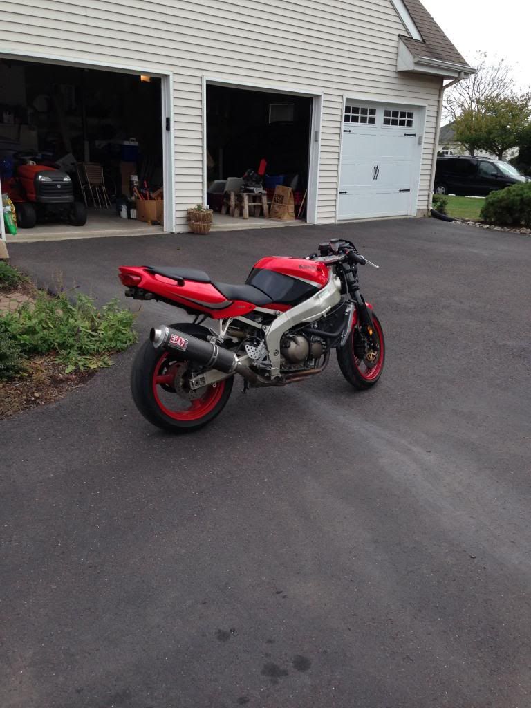

So then it finally started warm up in SE PA (it was cold as shit this winter). Bought some new parts and then the stripped the frame, subframe, and swingarm to paint black. I also painted the engine covers and the rad as well. Smoothed out everything I could and filled the dent in with Bondo. Real great stuff. I used rattle cans just can't afford powder coating. I think it turned out well:
Once everything was painted it was time to start putting her back together:
Got it mostly done by the middle of June and continued on till this week. Here's the finished product for now:
All that it needs is a plate, but that's a whole other story as of now. lol

Any criticism and thoughts is greatly appreciated. I wish I put up a thread while I was building her back up, but I'm alright with how she turned out. I came in with one goal, make her look presentable again.
Thanks for looking.
