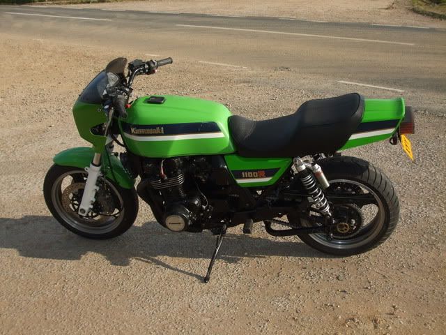

I got 6 bikes here all runnin 630s':robssmilie:
heres one offem;)
Reactions: 2
I see crash bars...... screams 6 cyl. But your chaindrive? Converted 1300 ?
I know i better never accuse robbo of holdin onto CBX ;)
Wow, you haven't seen that thing before? It's a KZ1000 that oozes old school badass.
