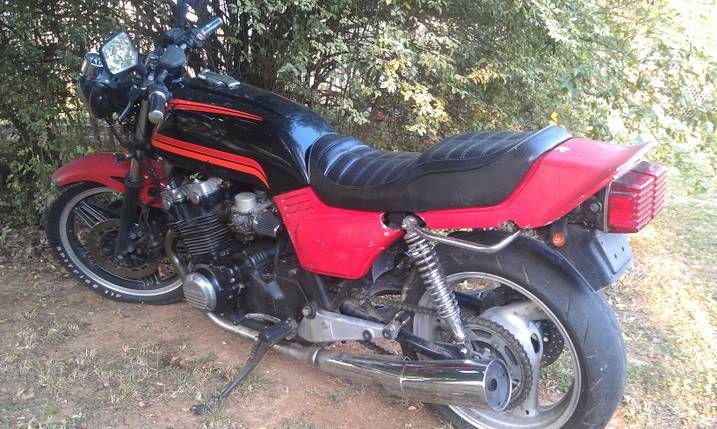

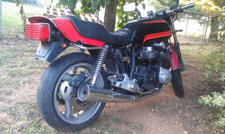

Okay, so this is my first bike. I bought this bike over a year ago for a cheap, "quick" fix up and ride. The bike was stretched and "hardtailed". The PO had replaced the rear shocks with metal struts. I rode it and realized very quickly that it had a charging problem. I installed the factory swingarm, bought some used shocks, and replaced the alternator rotor. Of course I didn't take any pics during this process. I had the bike good to go, getting ready to ride, checked the valve cover bolts and.....snap!! Broke a cam holder. Oil every where!! And that's where these pics come in:
They were actually for a craigslist ad. I was fed up and had decided to sell it.
