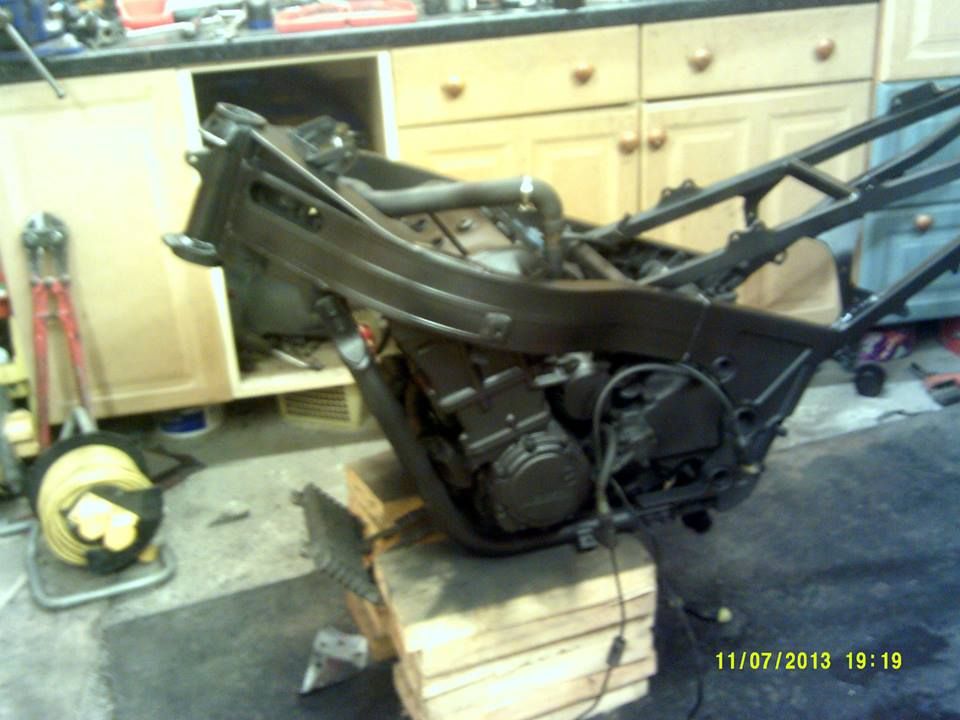

i bought the bike back from the insurance and found a new frame for £50, so at the moment it mostly stripped down getting ready to be transfered into the new frame, so while its apart im gonna clean/paint/change stuff.

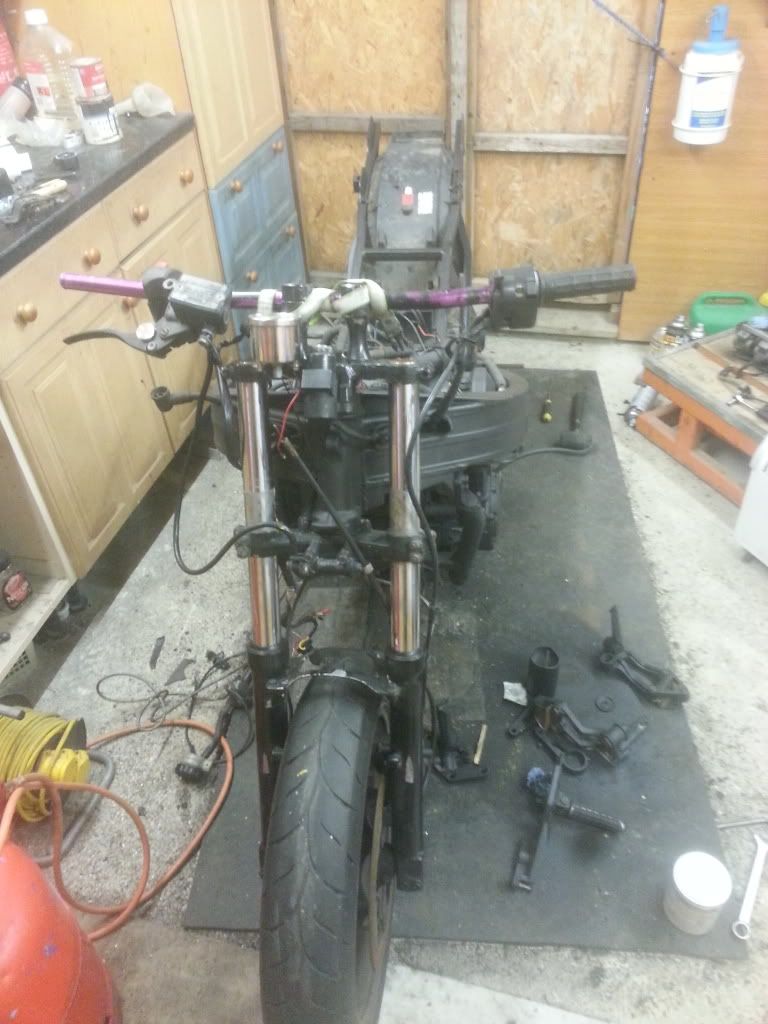

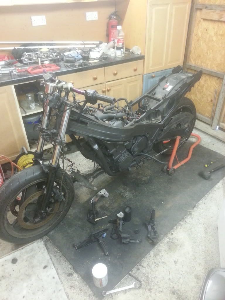

how she sits as of last night

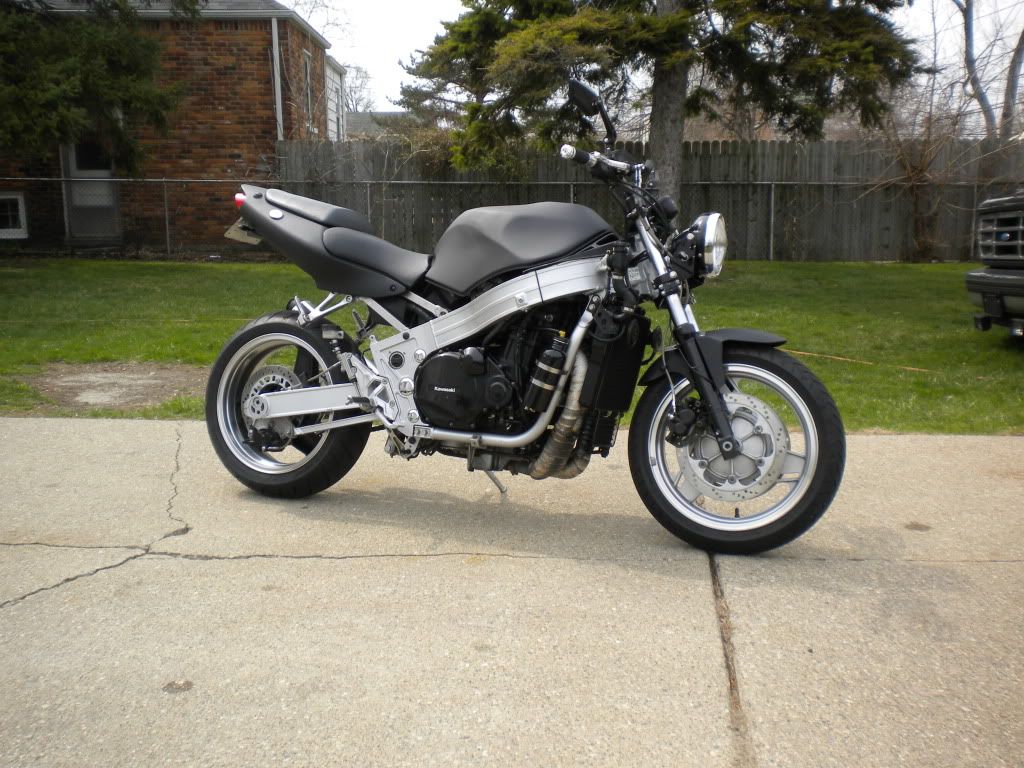

plans(not in any order)

would love to swap swingarm for a single sided, but not sure if able too( need to research)

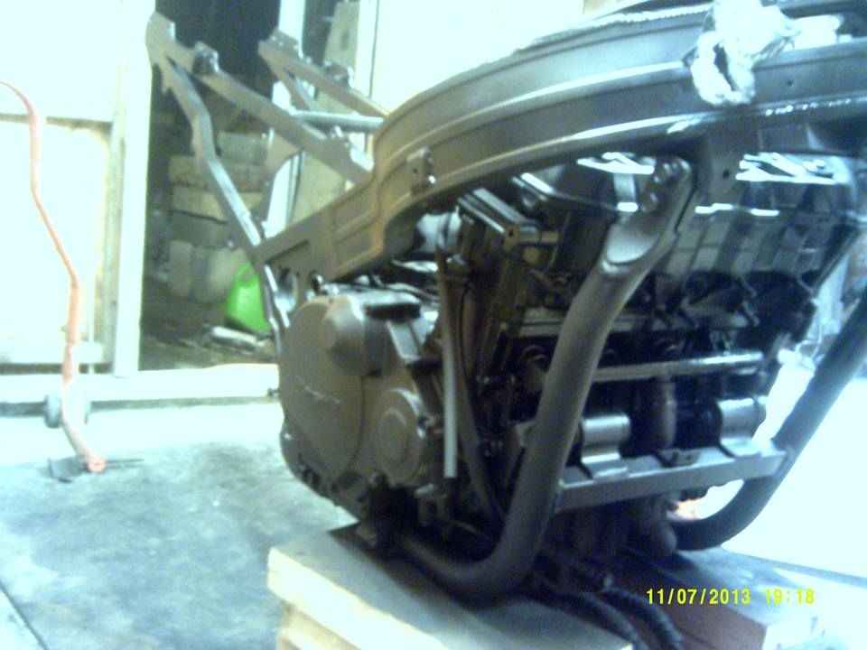

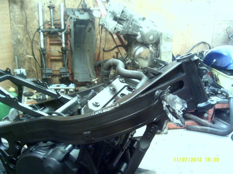

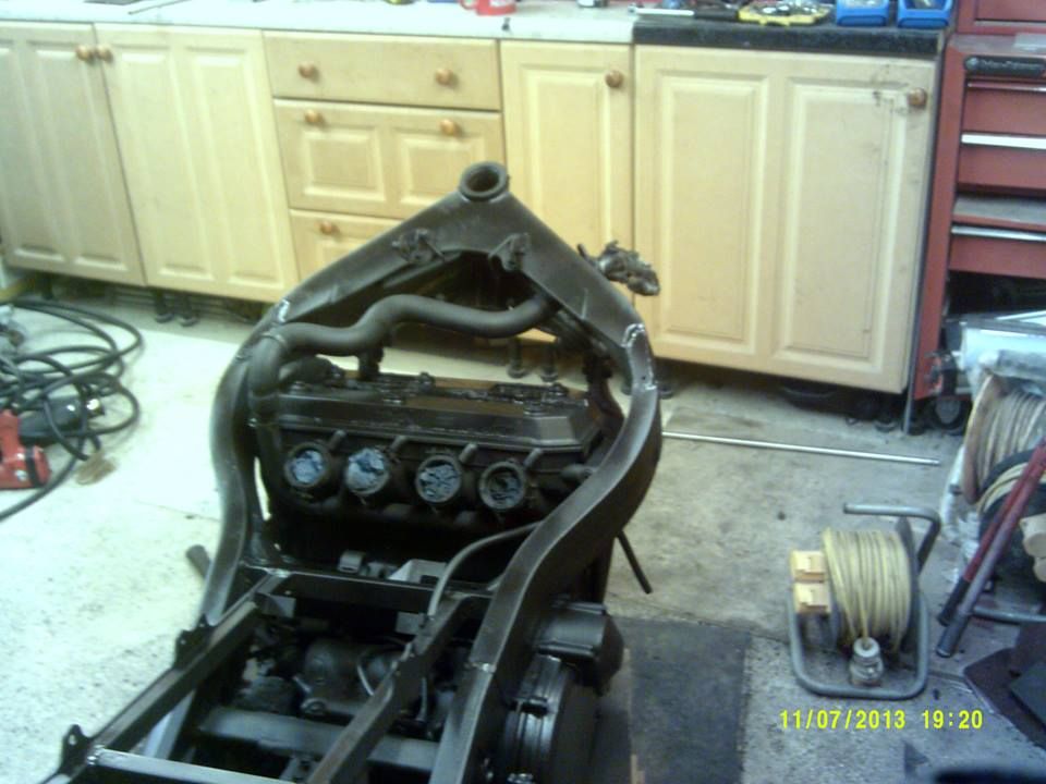

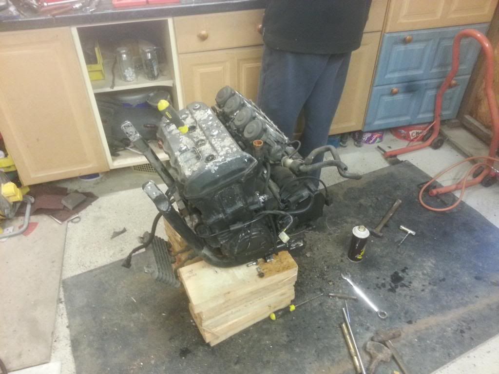

motors out finally, everything has gone really smoothly with the strip down, until it came to the very last bolt, bottom rear engine bolt, 25 year old bolt fuck me talk about seized, in the end it took 3 of us to get it out, 1 person heating it with a blow torch, 1 person tapping it out from one end and another person with a impact gun. but anyway its out.
ready for a quick clean up and respray

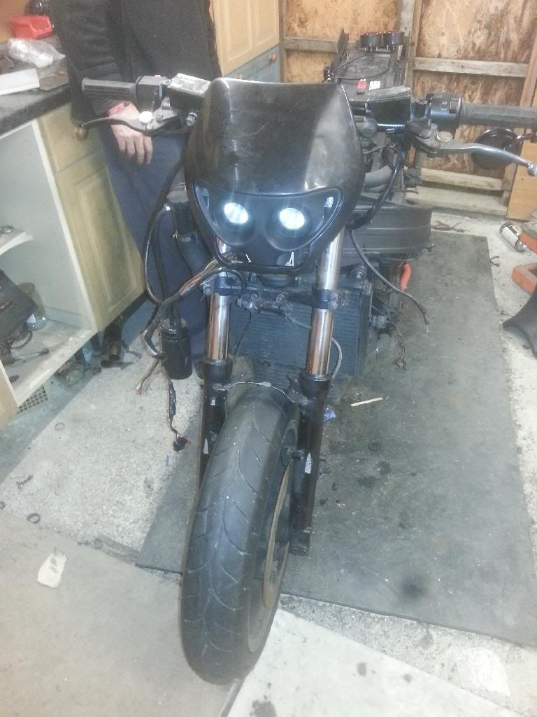

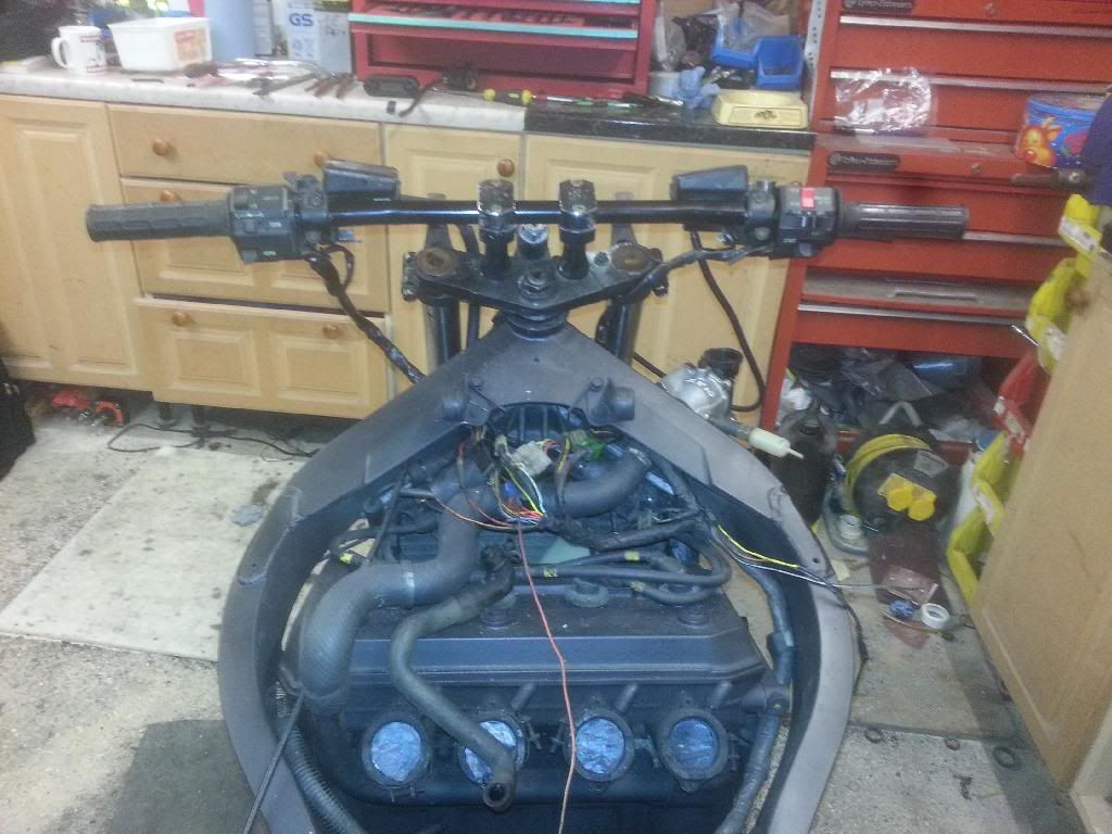

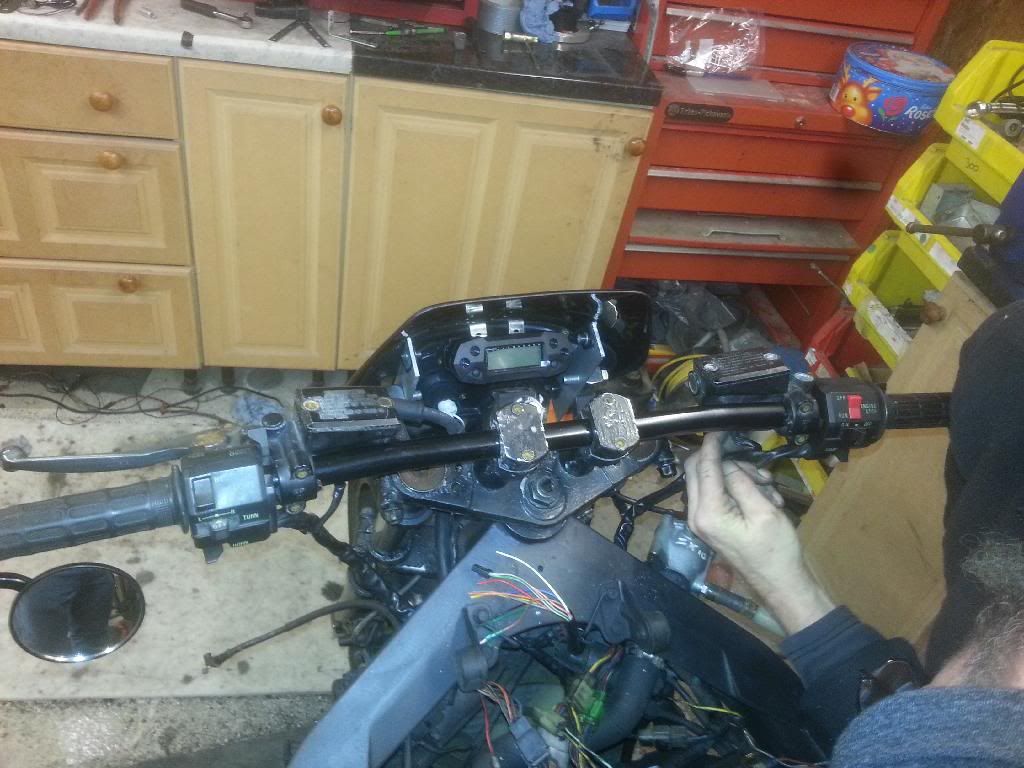

got a little bit further today,
forks, wheels and started on the pain in the arse job, the wiring loom( which has been hacked to bits) loads of random fuses everywhere, plus my starter solinoid is off a series 3 landrover:confused:, more parts added to the list
took the purple bars off as im swapping them for some renthals, plus the purple didnt suit.
hope more people will start liking this build more as it takes shape

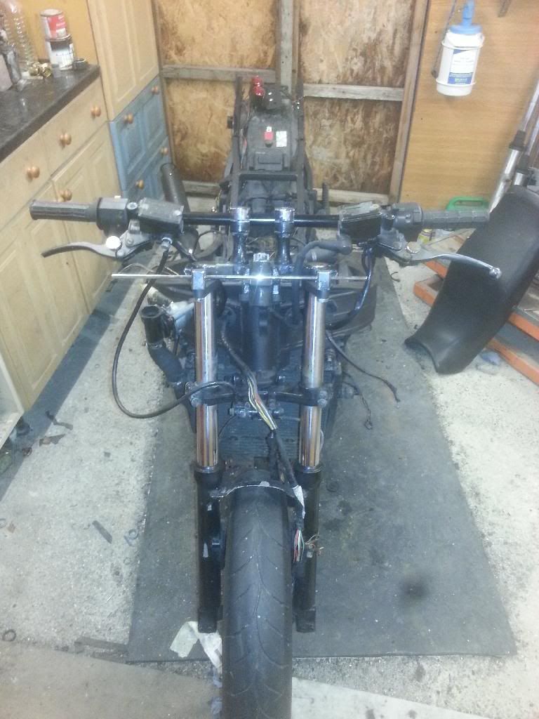

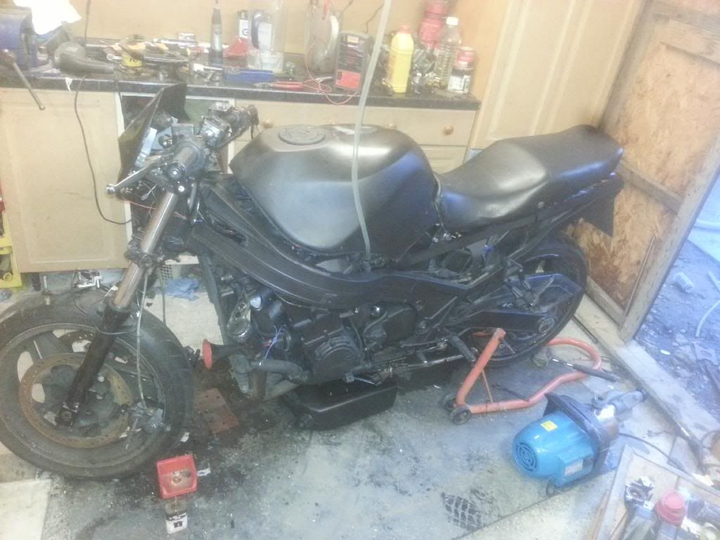

how she sits today(tank just rested on frame)
started on the brakes, need to buy new pistons for them, as there leaking fluid, always fucking something. was hoping to have her on the road by march.
still to do
front brakes
bleed clutch
oil change
get zzr1100 spacers to fit the 17" rear wheel
paint tank
make some side mouldings
