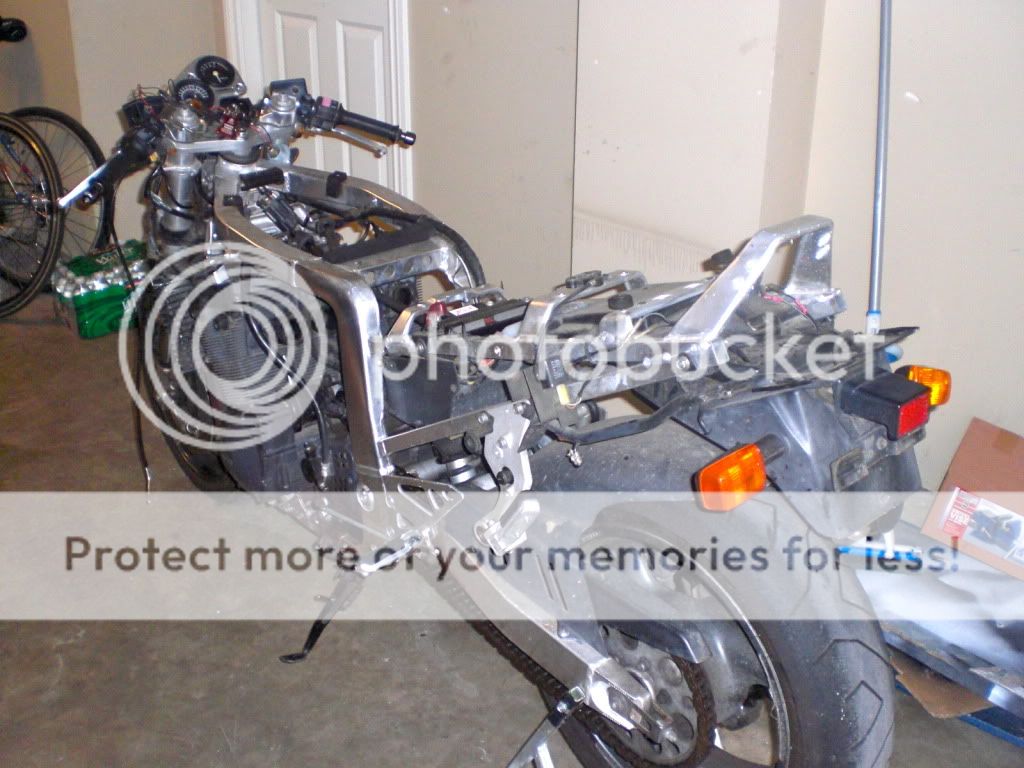

Starting with a 1992 GSXR 1100.
My new workbench
Beginning the break-down

I've been making some progress on the bike after work in the past week. Check it out.
2008 R1 Swingarm
Some interference: The frame at the pivot is 9 1/4" and the swingarm is about 10". I'll have to mill the swingarm to fit.
Cut the subframe off
Fork tube covers, 2.5" OD. Mocked up some 32" straight bars. I'll build the real deal this weekend.
