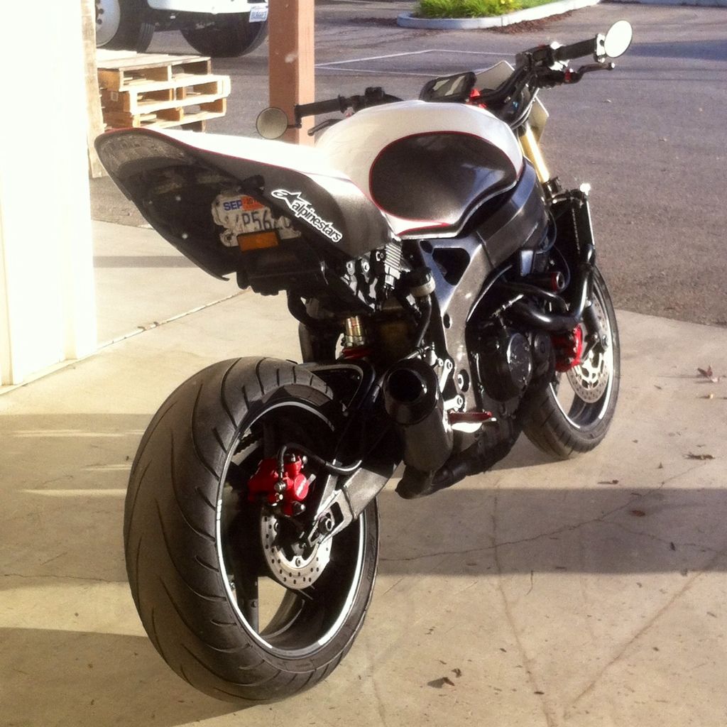

Hey all, so I have a veryyyy far from stock 96 CBR 900rr streetfighter. Right now I have a 2005 600rr tail section and am thinking about buying up a 05 under tail exhaust that I can get for dirt cheap... Has anyone done this before on here? I'm still unsure as to how I want to route the pipe... Either next to the shock through the swing arm or outside the swing arm behind my rear sets... Looking for advice, picture, and whatnot... Here's a pic of my bike...

If the mid pipe sticks out like that it'll look like shit. Bikes that use undertail exhausts stock usually have swingarms that have a cut out per say that allows the pipe to run tightly up to the tail.

Well I mighttttt be able to sneak the pipe next to my shock through the swing arm. Not sure yet.

I have heard of cars that are lowered and need clearance that use basically an oval exhaust. That may be an option if you can figure out how to do that

Ya know I was kinda thinkin might have to do that to squeeze by the shock/ swing arm.

So my pipe should be here soon! And I got ahold of a header shop that will do the bending to make the old exhaust match up. Here's the pipe I got and the reason I got it for so cheap. Has some plastic melted onto it. Have a few ideas for removing the plastic but advice is welcomed...
63 Posts
Okay! So time for an update, my 05 undertail exhaust came I today! Had to do some work even to mock it up, had to move my battery box, starter relay, and rear shock reservoir. ( battery box is the only thing I've found a new home for tho so far... Anyways it fits like a glove surprisingly! The downpipe fits right between the rear swingarm and shock, tho it needs to be slightly tweaked so that the pipe comes out a little straighter.... But overall I'm ecstatic! Anyways here's some pics of it mocked up. ��

.. that pipe is massive, too massive.... maybe if it were cut down so it didn't stick out so far it would look better....
be aware that running your exhaust close to your shock might cause the shock to heat up a lot more than it should resulting in a drop in performance from it....

Well as far as the size that is the stock pipe for that tail... And eventually I'll get an "05" slip on for it. And I'm going to wrap the exhaust and extra around the shock

I also think its a bit too long. It blocks the taillight in some angles. If you were to cut it down or of possible, delete a few inches of pipe just before it and get the tip of the muffler to stop at the same point as the tailight then it would look fuckin SWEET. Still looks way better than the other exhaust. Whatcha got planned for your old muffler by the way? I'll take it off your hands if you ask me nice :D
