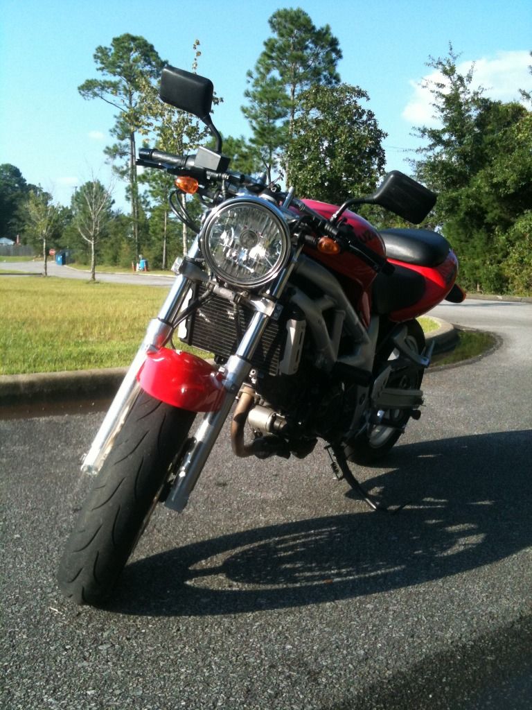

But here goes my second fighter build, and I chose the Suzuki SV650 for it's curvy tube frame and rock solid twin.
So far I've just chopped the rear fender off and remounted the plate and signals, installed Motosliders, and fixed a buggy coil. When I got the bike, the rear cylinder was not warming up very fast at all. Soldered in the connections to the coil and repaired some wire. I still feel like there is a lingering wire issue SOMEWHERE, I just know it. Huge mirrors are getting tossed, but sticking around until I figure out what I'm going to do with the bars. It has the Suburban Machinery bars, which are really nice, but I want a little higher grip and upright riding position.

So anyways, got the basics done to get her one the road, took a short ride today, and I'm really happy with some low end grunt and the Leo Vince sounds mean enough to scare the kids. Me likey.
