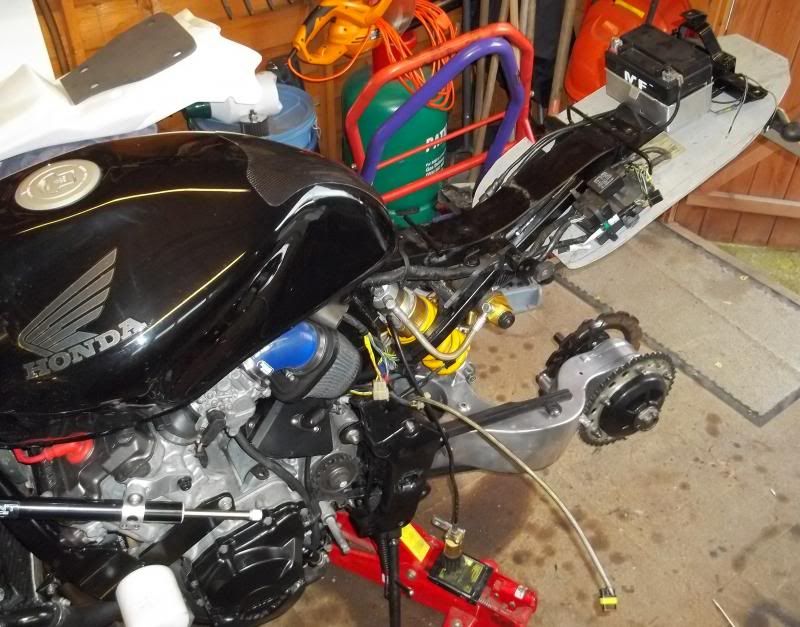

Went to work on changing the SSSA over tonight, got it done :)
changed the shock, rear sets, swing arm mounting plates and some small bits. needed to modify some of the bits
but they went on with surprising ease.
had to remove the exhaust can as i couldn't mount the wheel with it still in place :eek
found that the connector between the stater and the Reg/rec had started to burn out!!! so removed it and soldered the wires and
shrink wrapped the joints.

chopped sub frame off, so no going back now!
measured up and drilled and fitted top bracket, then test fitted CBR sub frame.
then drilled the lower brackets, also trimmed off some unwanted metal.
did a test fit of them.
once i am happy with the fitment i will bolt the lower brackets in place, i will get them welded once i am
100% happy with everything. i will be changing the seat fitment slightly from how it was on the 600 as the
tank has had to be moved slightly, which means the seat/sub frame needs to move so the plastics will line up
with their mountings.

well here ya go :thumbsup:
quick trial with the plastics on and it wasnt a long way out, so happy with that, just
need to finish off the lower brackets and can then get on with the re build :D
