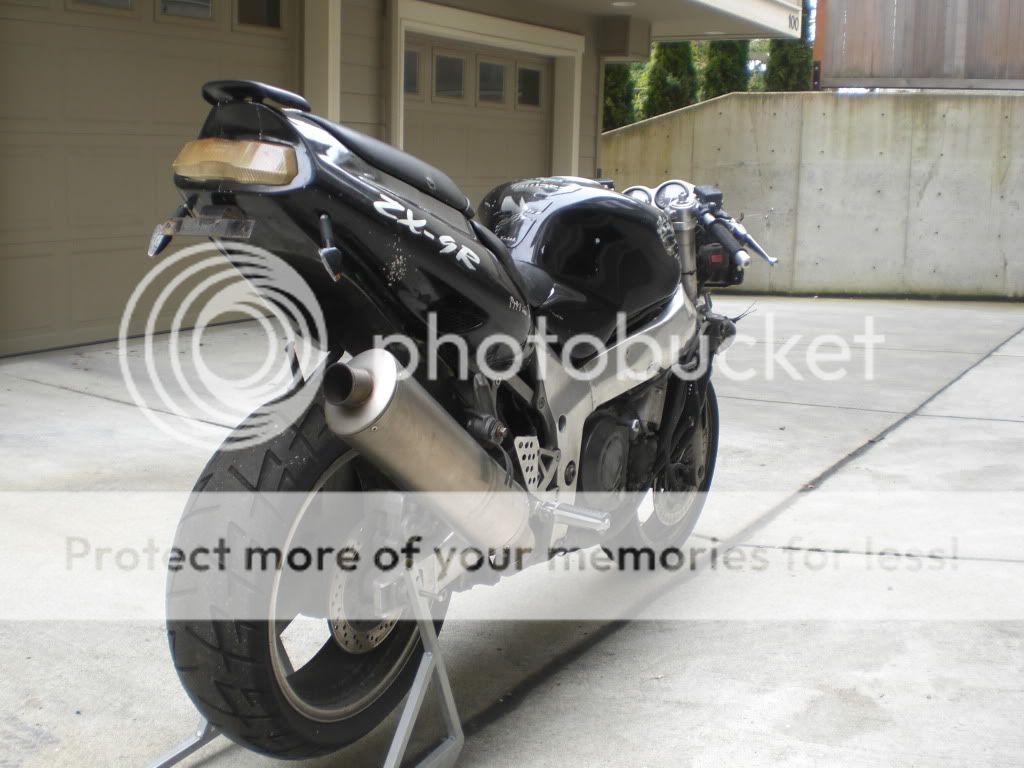

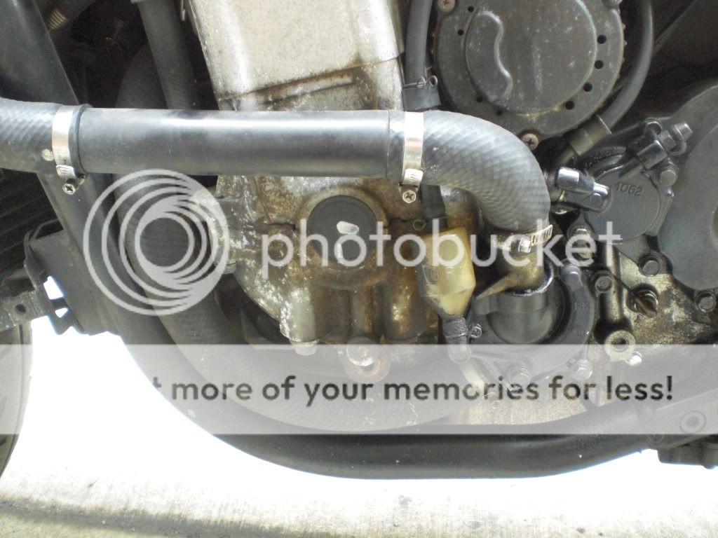

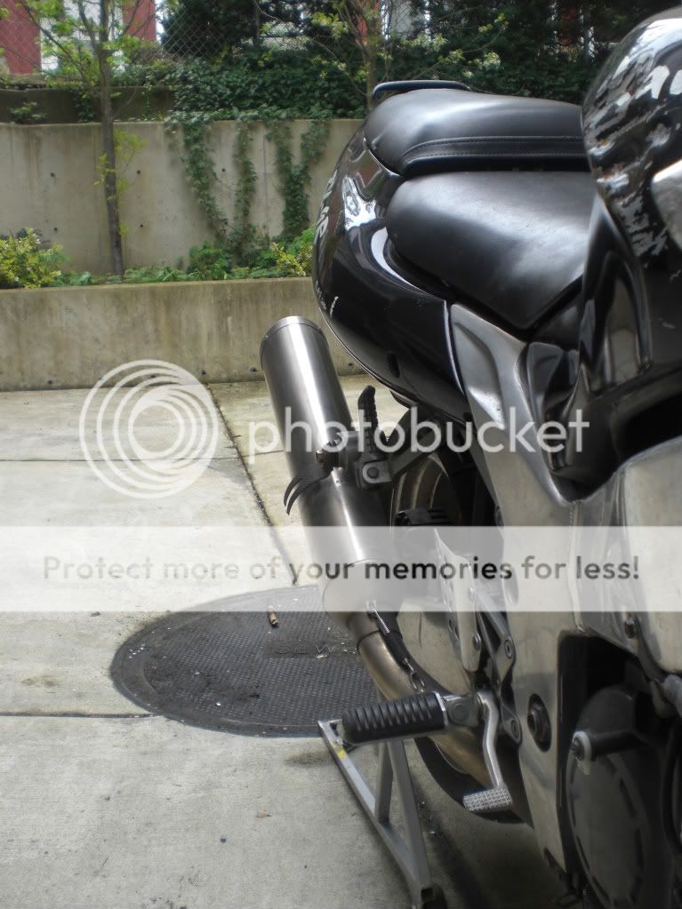

After my 900rr build hit a financial dead end, I was looking for a new project. I found a 1996 Zx9r :kawasaki:
Here's are some pics from the day I picked it up:

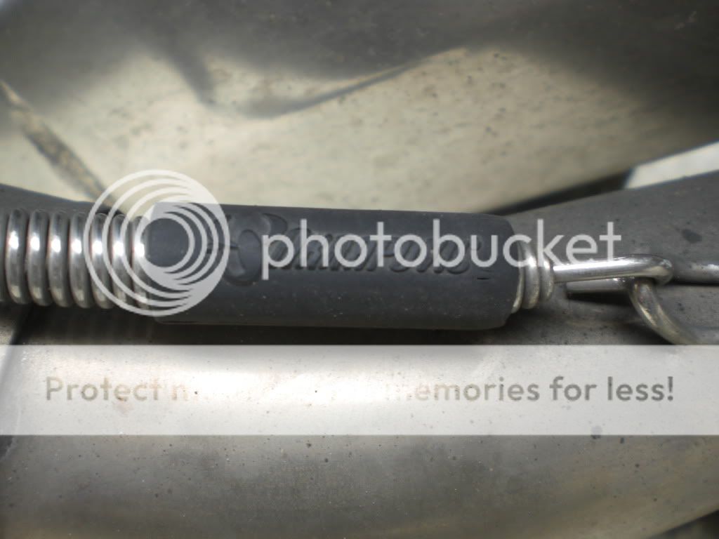

A little treat came with the bike, full akra
Dirty dirty

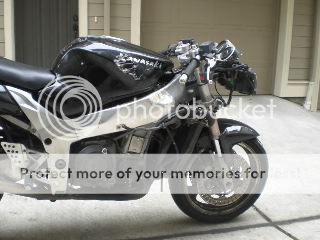

The bike was stored outside and hadn't run in a while. Goal #1, get it running/idling
Once cleaned, the bike ran and idled. TIME FOR DISASSEMBLY!!!

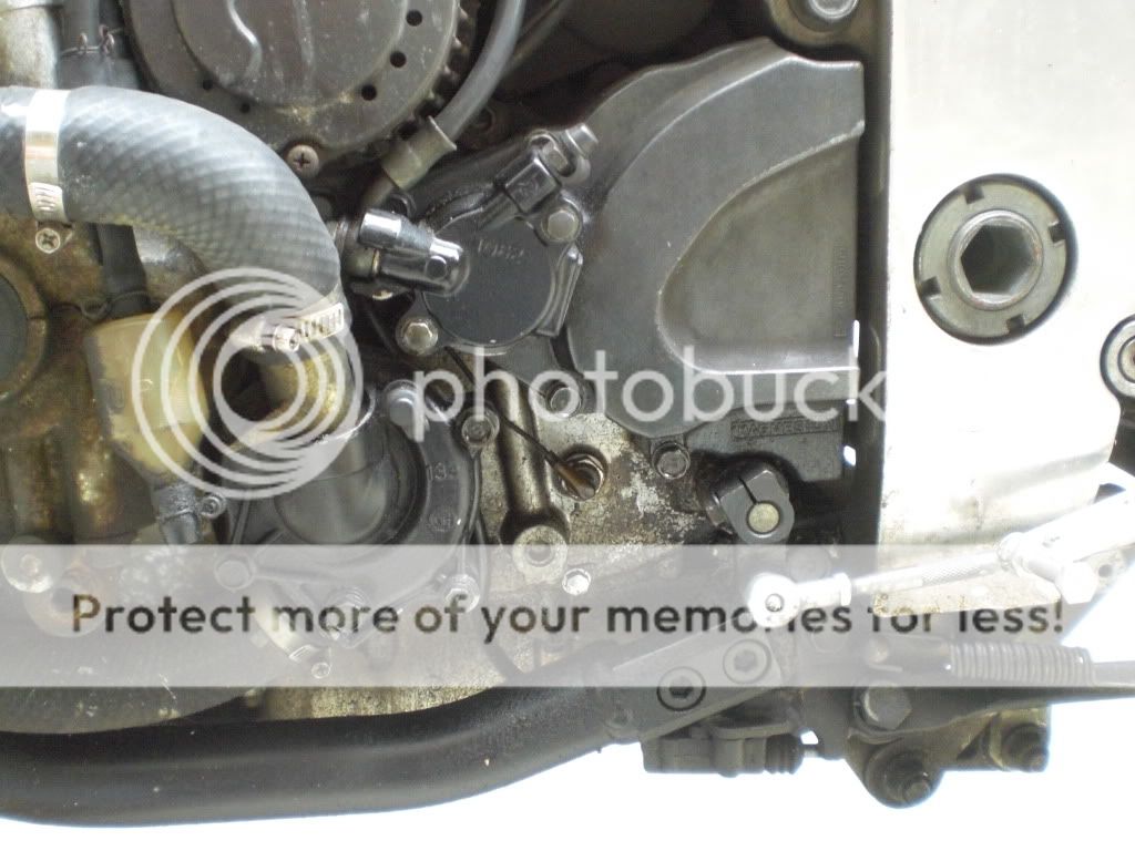

The filth continued
I began de-greasing everything for paint. Only got the swinger and wheels done today...

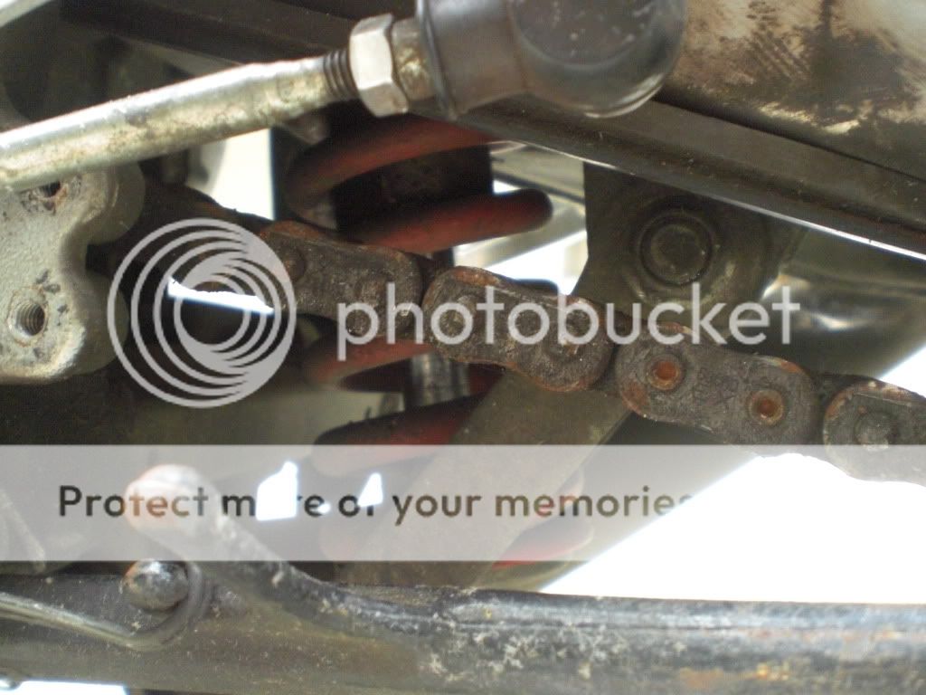

Is there a trick to removing a chain master link? I need to split the chain, (not break it, I am re-using it. It's dirty but newish) to clean the engine case.
It seems like grinding off the rivet heads and then pushing the master out should do it? right?
Macaque
946 Posts
Discussion Starter #10
flat head or a chain break tool would do fine ....sweet find akro pipe is a good thing..
Great! Thanks
Anyone have a preference for masters? Clip or rivet style?

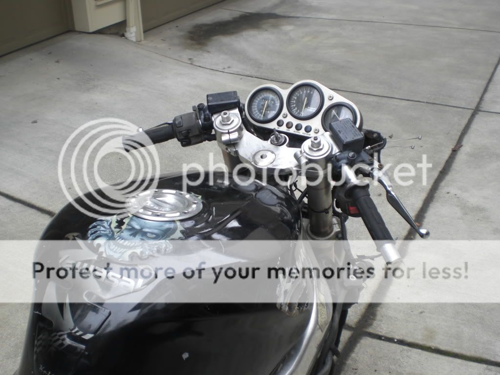

I've drilled the triple for my risers and ground off the extra mounting tabs on there that I won't be using.
I don't feel great about drilling into cast aluminum, so I'm welding some extra ribs underneath to add stiffness.

I also got the master link off, cleaned the chain with a shit ton of WD-40, then let it soak in oil for a few days, looks brand new!
