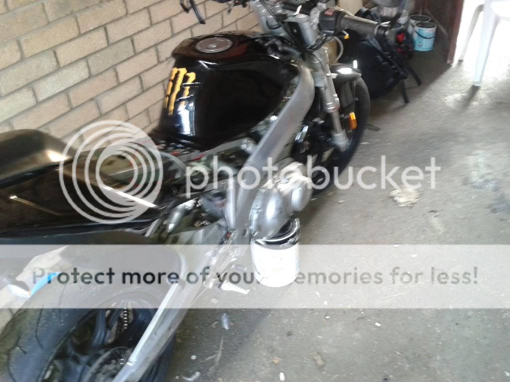

the bike before the engine blew! all I'd done was fit straight bars, indicators and mirrors

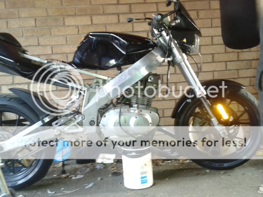

test fitted the new engine :rock:

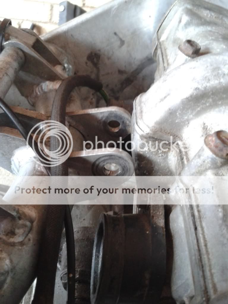

then realised I've got a clearance issue :help0:
but that issue is being resolved as we speak with a new shock mount :thumbsup:

thats reely tite ,no room fer yer carbs mate .
