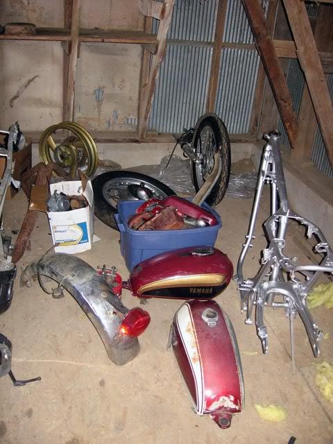

It's a 1977 XS650. Jack said I now have about 80-85% of the complete bike in my possession. Should be everything I need from a XS for this build. He just dropped off the engine and this heap of XS parts this morning.

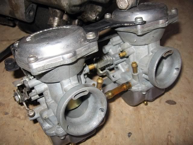

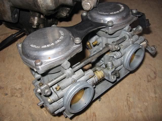

Another pleasant surprise that came with the bike. A set of bigger Mikuni carbs that have been modded and tuned for this engine. Ben said that when he got these carbs tuned correctly, this bike pulled like a train. Can't wait to get it going.

Selling the XS tanks. Interested? I haven't actually opened them up yet, but I was told that they are clean on the inside.
