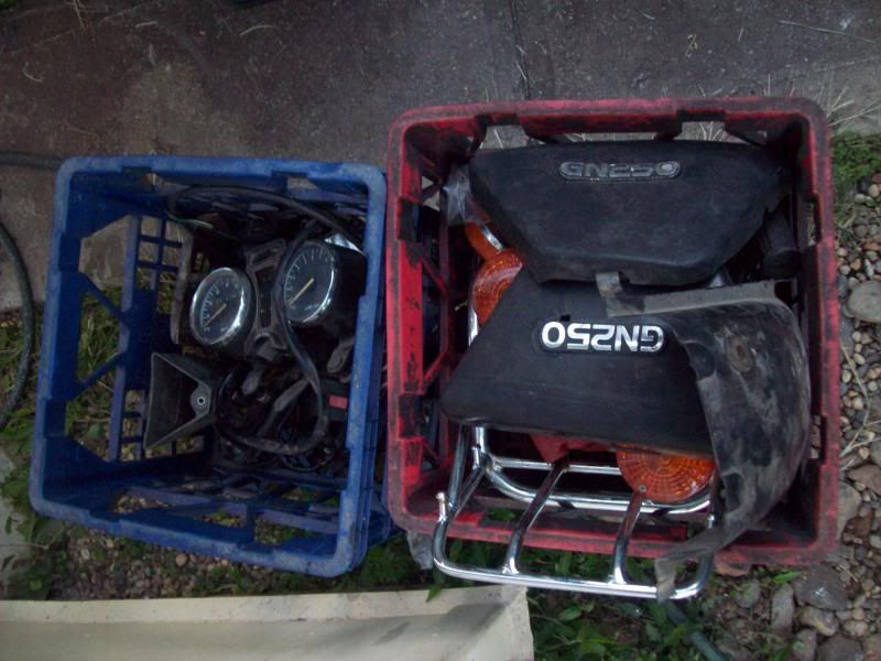

this is how I get it in all its glory, pretty sure there is some more pieces somewhere like the motor.
