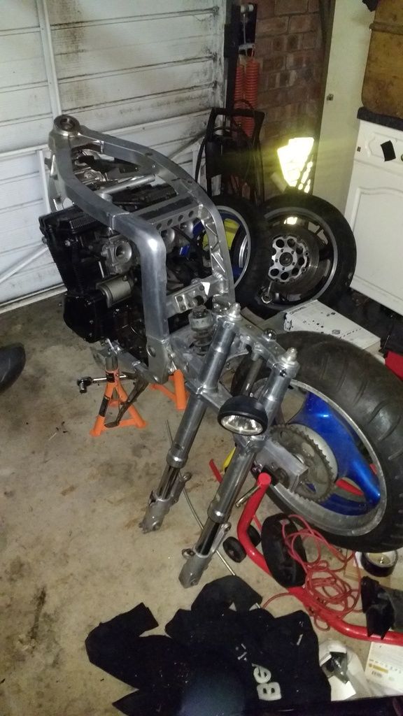

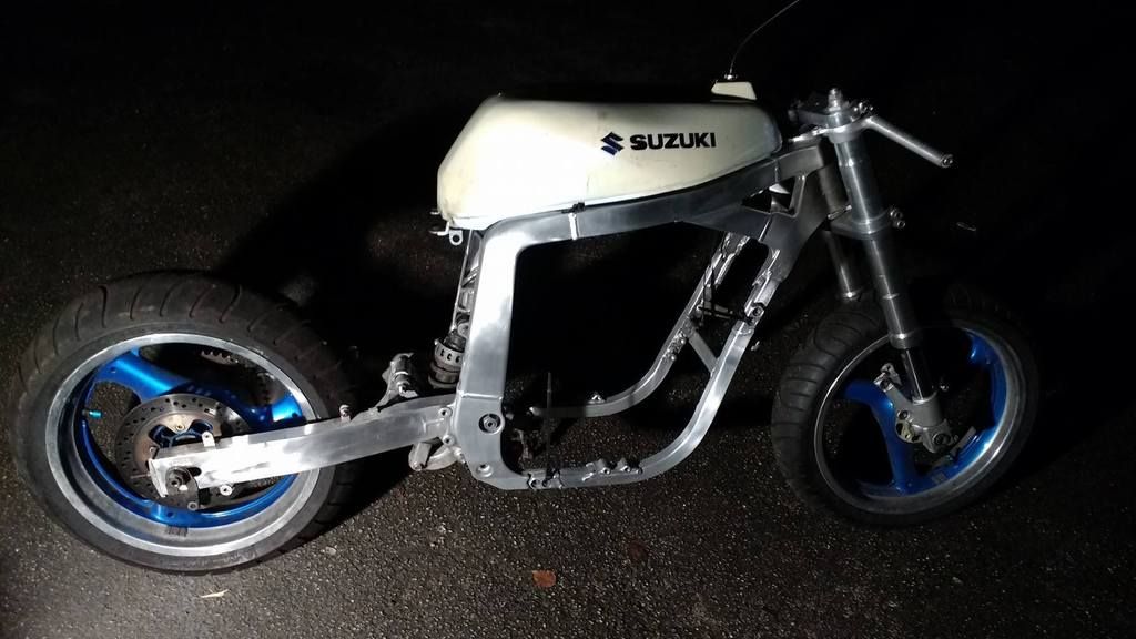

Well its that time of year again! sold the CBR last week so I could bring the bike out my bedroom...right here goes
The plan:
1988 Gsxr 750 frame
Bandit 1200 motor
Bandit carbs with foam filters
stubby tail
as short of a wheelbase as possible
as light as possible (budget dependant)
As simple as possible
Ok so the pictures...
V four honda whore

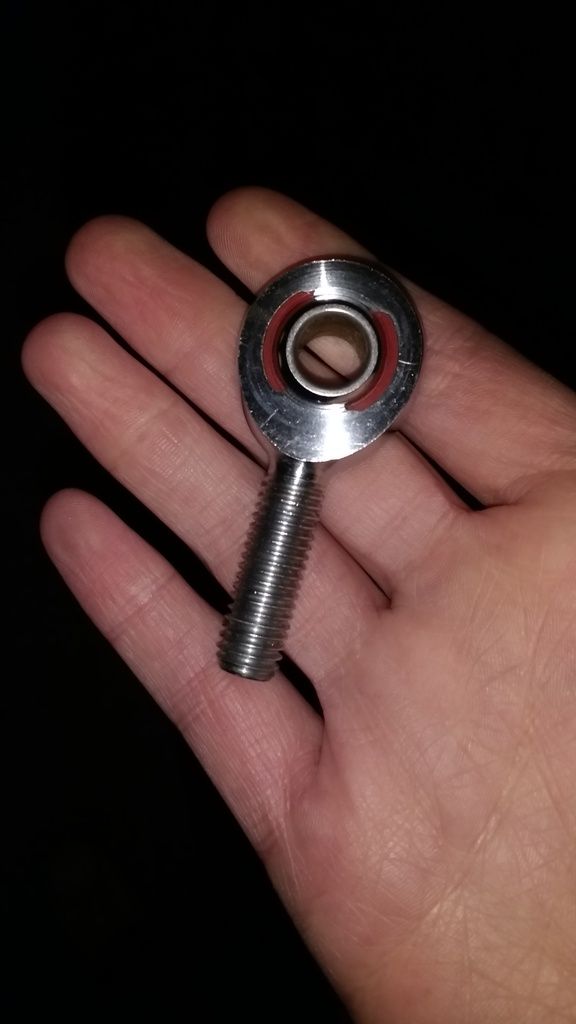

Not got much done on the bike sadly as very busy working atm...Did try to cut the rest of the stock subframe off today but my angle grinder bit the dust and died half way through final grinding session...damnit!
Im thinking ahead to my subframe too...my original intention was to use square tubing with adaptors in the end so I can bolt them to the frame with rose joints...now I can find the adapters for round tubing (see example below) but none for 7/8ths/20mm ID square tube...any suggestions? alternatives or different methods of mounting the subframe?

Re: CafeRacerDans OldSkool Fighter 7/12 Discussion
http://www.ebay.co.uk/itm/1823205275...:MEBIDX:IT
Use round tube?

12,415 Posts
get bigger one, and machine end square
10,742 Posts
An M10 nut is 19mm across the corners, weld them in the end of the square tube? or get flanged nuts, put them in the end of the tube and weld the flange to the tube, with the hex part inside.
956 Posts
Use round tube?
welding round tube is more difficult (suppose it would mean I would get more practice in!) but just think square tube will look better with the square frame of the gsxr
956 Posts
didnt know whether that would be structurally strong enough or not! new to building bolt on subframes!

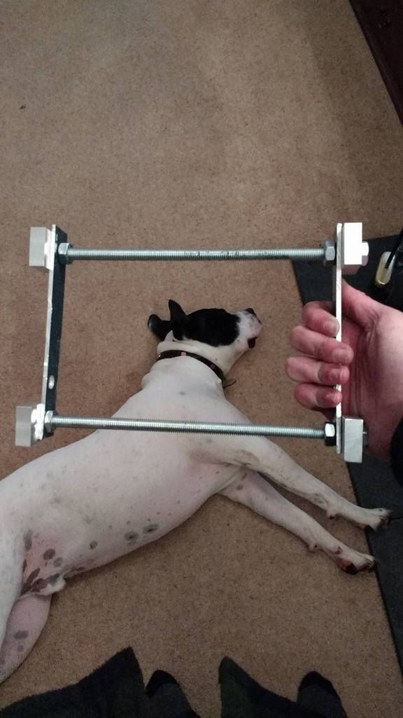

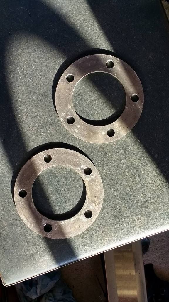

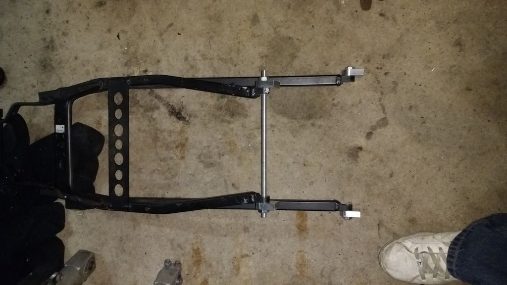

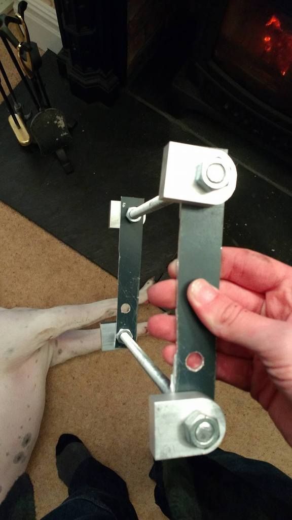

Bit more work done today, got the last of the rear wheel spacers and frame appears straight so...
Cut off rest of the original subby
needed to make a contraption to keep all my new subframe tabs inline vertically and horizontally so came up with this...

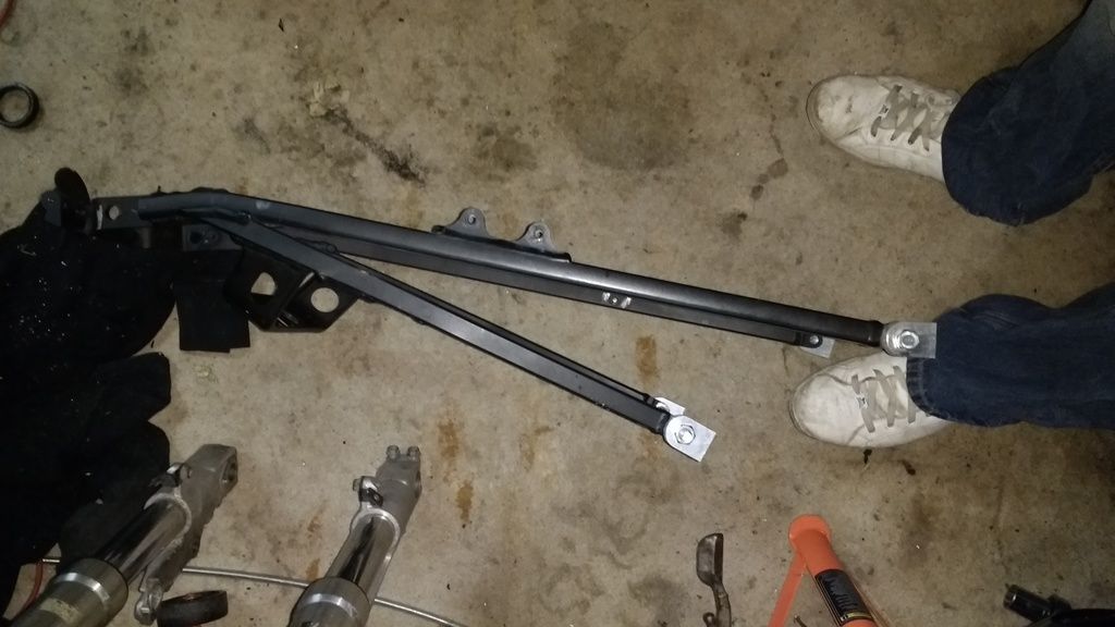

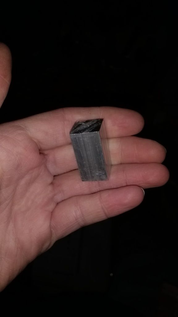

Well gonna just buy loads of of tubing and see what takes my fancy...still not bought my welder yet...procrastinating as they are expensive as fuck!

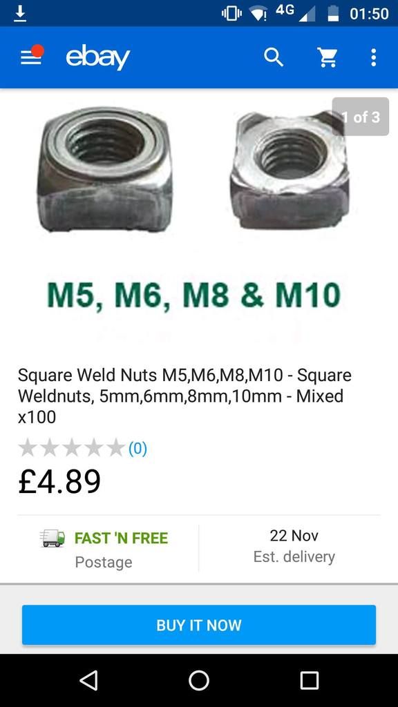

found these gems to use if i chose square in the end.
