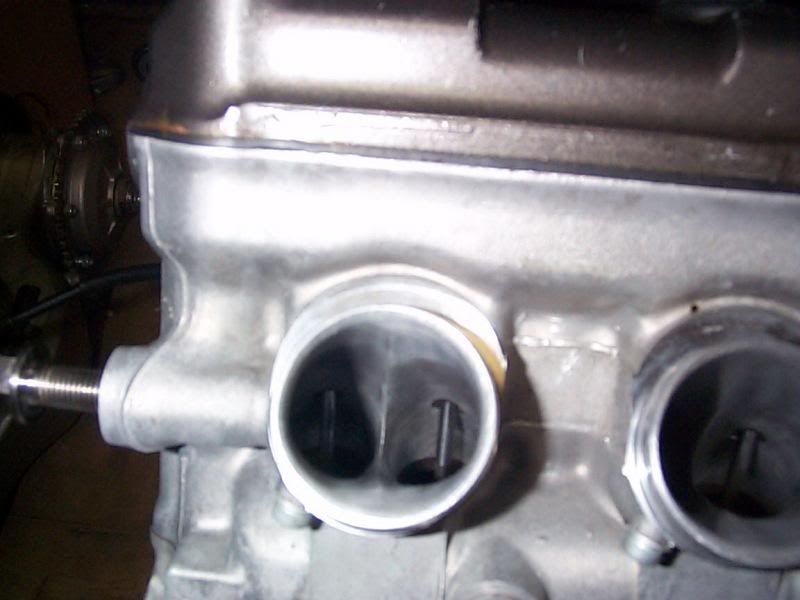

Here's where it started: AMA Formula Extreme motor, which has about every modification possible and was dynoed at 162 at the rear wheel.
Engine:
Fully Ported Heads with Ti valves and retainers
3mm over cylinders and JE pistons
Race cam
Matched rods and crank
HRC Close Ratio Transmission
HRC Slipper Clutch
Polished Flat Slide Carbs
