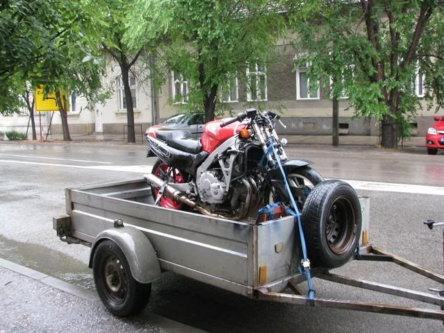

done chopping the tail section today , tomorrow some welding of new mounts , but I have a problem , the tail is to low , to near to the tire , the shock is in the highest position , what is the easiest way to raise the back end ... because if I have to change the mounts for the shock on the frame , than I'll mount the complete swingarm from the 600rr 2005 , but I wanted to ride ASAP , and continue in September ...
help pls
Serb to the bone !
86 Posts
I look 4 2 hours all combination , and dogbones can be longer 5milimeters less than 1/4 inch and that is nothing , the triangle link should be modified or extend the shock for 38milimeters that is little bit less than inch and a half ... so don't know , think that is the cheaper to cut the lower mount of the shock and weld new steal , make new holes ... but I'm certain that I'll go to the certify welder for that job
Serb to the bone !
86 Posts
I try everything and the only reasonable solution was this
I extended shock for 38mm because on dogbone could move only 5mm and that raised tail for maybe 20mm (less than inch)
and make some metal mounts for seat tomorrow will weld ... I do everything outside and the damn rain is killing me
now the real problem is that I have 600rr swingarm , and when I measured everything it seams that I have to cut 4cm from right side , that will leave me less than 2cm , is it safe or what to do ... I saw people do it , but no body put the real close up pic's what did they do ... and in SERBIA the fighters aren't popular , so no body can advise me ... plz help
