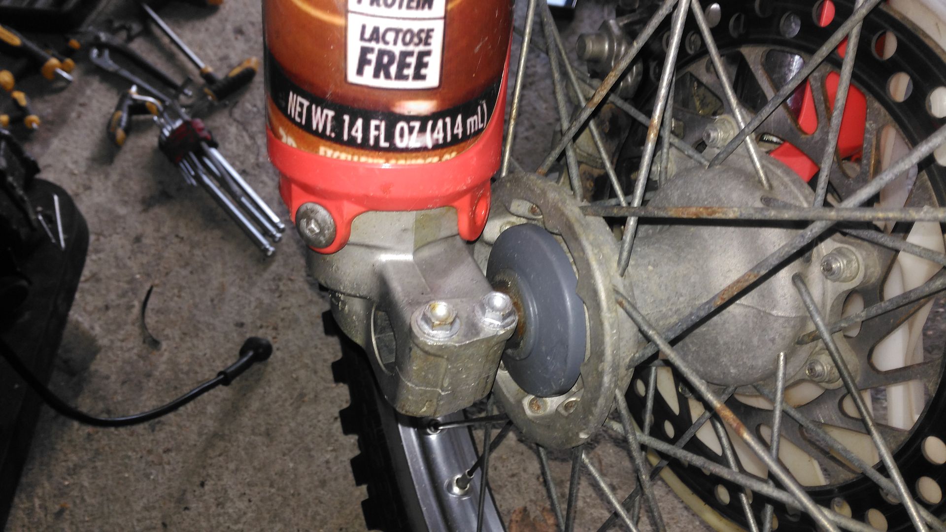

Starting at the front, I noticed there was hardly any pad material left on the pads:

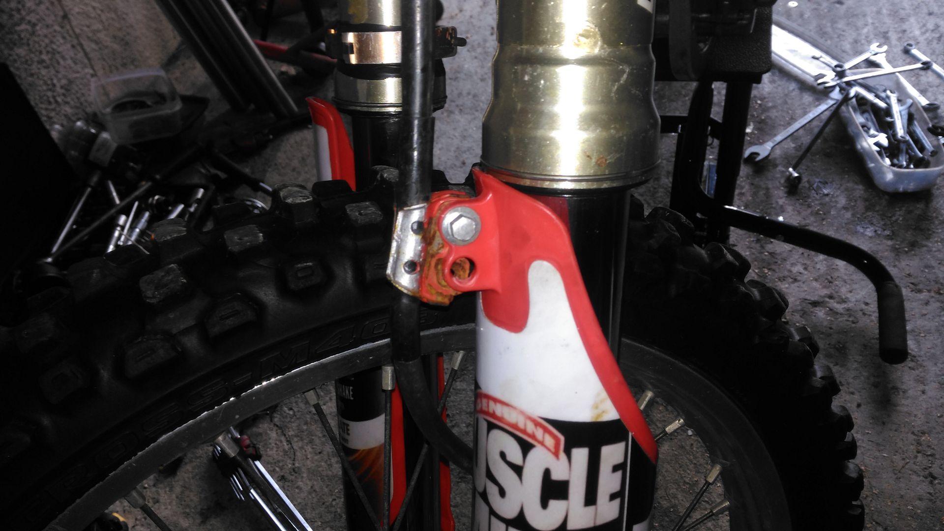

The rear pads are ok actually. There are bolts missing from the fork guards:
I found out why.... no threads... So i'll be heli-coiling them.

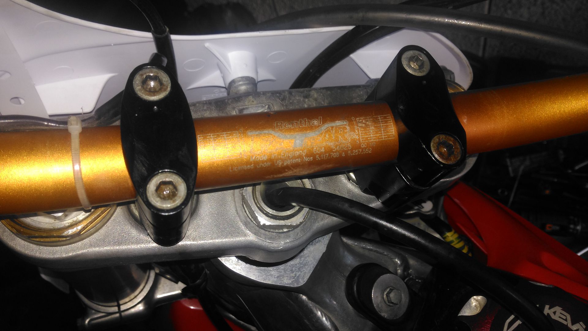

There's quite a few missing bolts around actually:

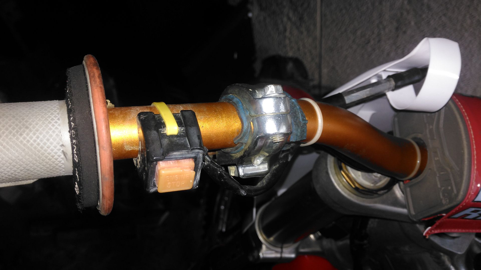

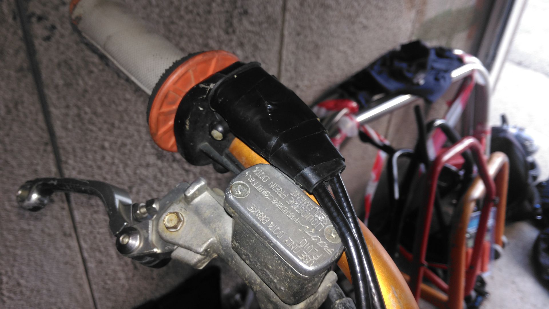

Quite a few jerry-rigged and elec-taped parts:
Some PO was ham-fisted as fook it seems:

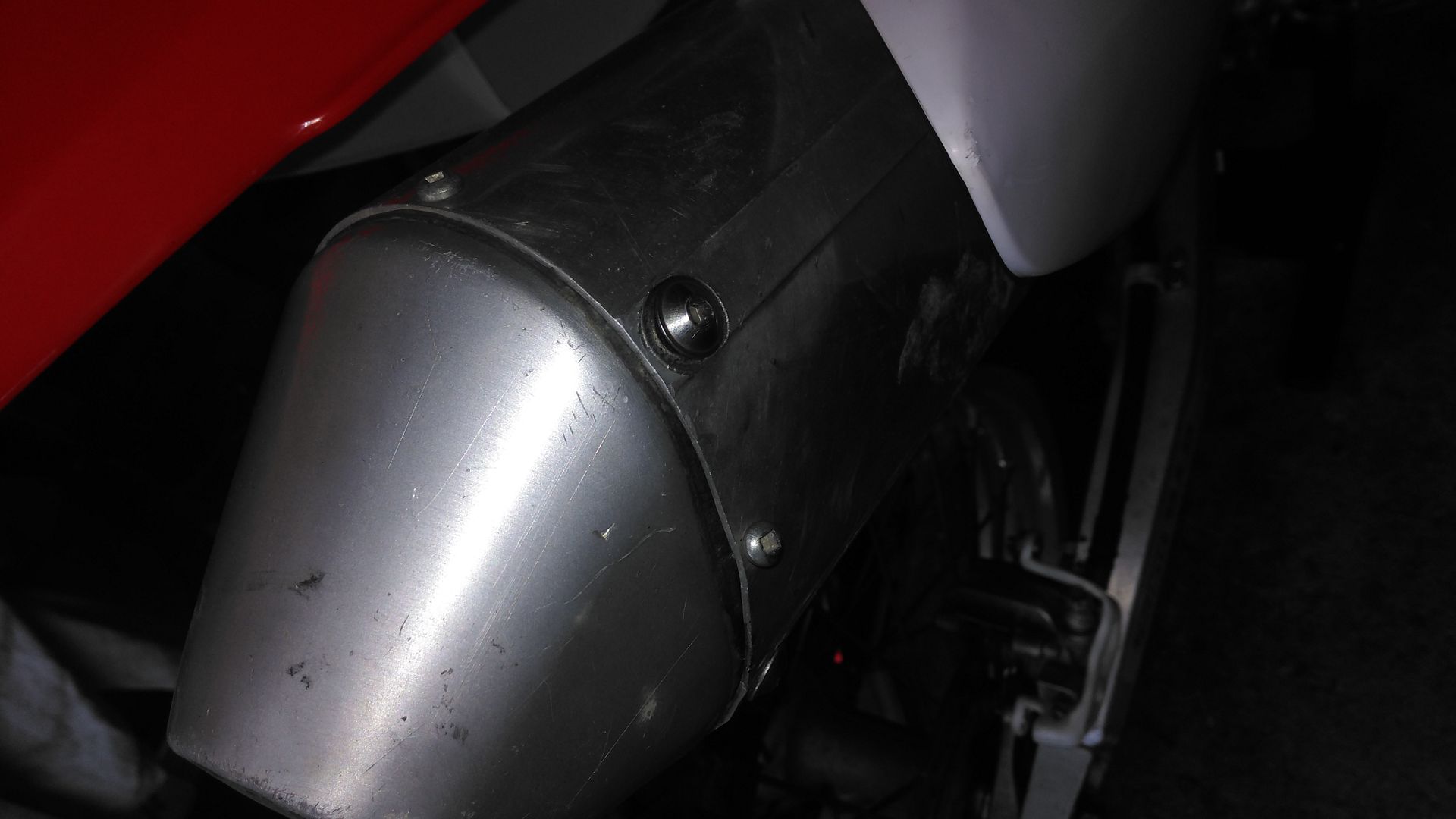

The muffler cap is held on my an assortment of screws:

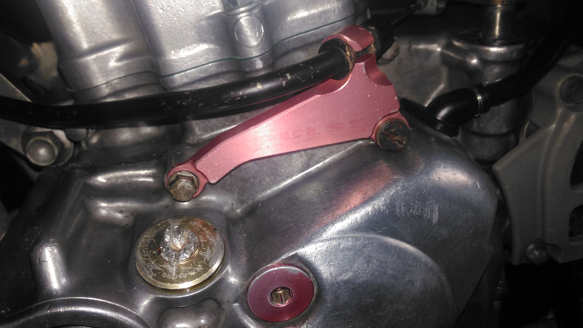

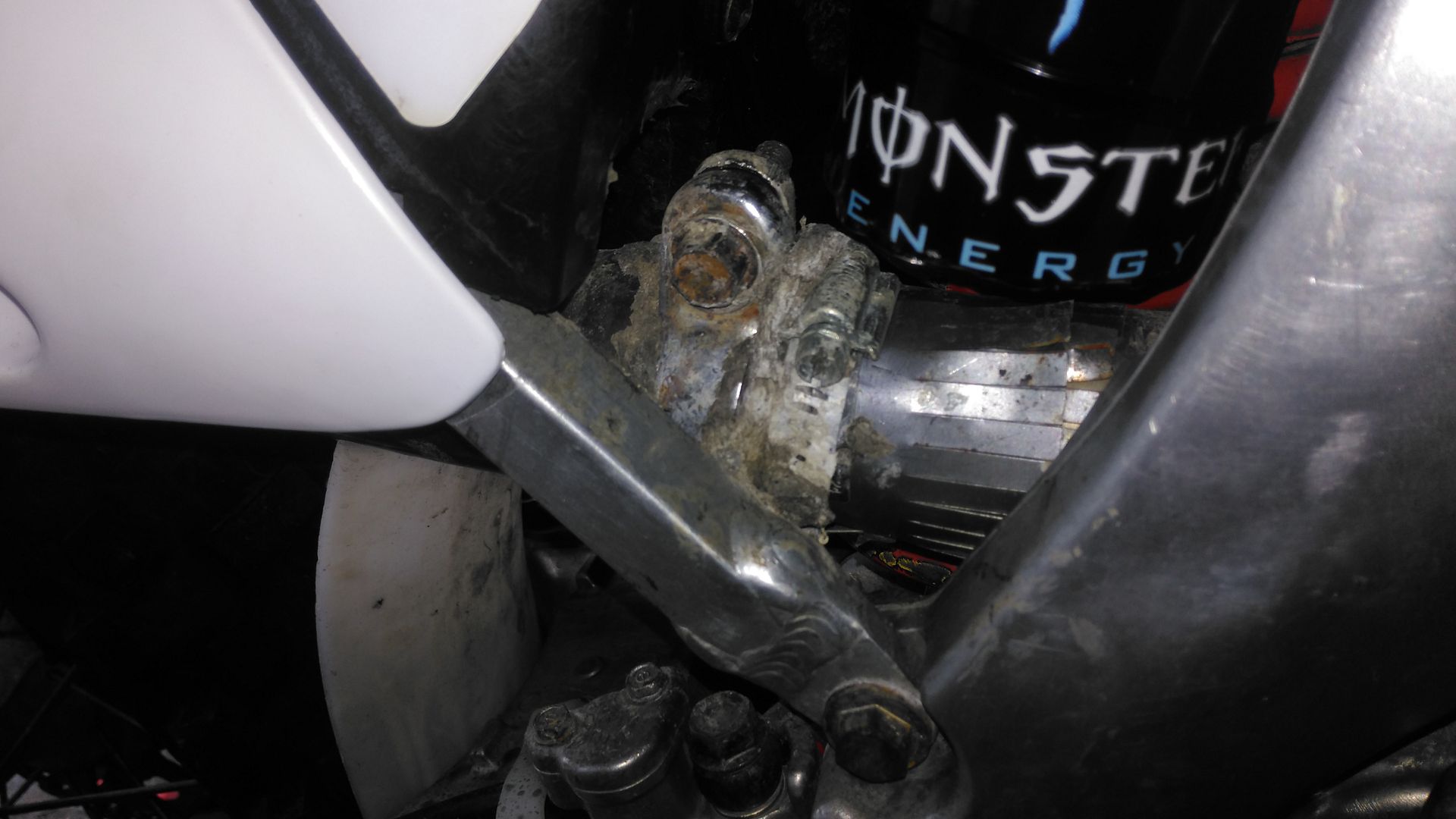

And I have no idea what is going on with this link-pipe connector:

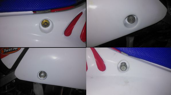

Speaking of assortment of screws, this is what is holding on the rear plastics:
12mm, 10mm, cross-head, allen key. :nuts:
Pick-and-mix bolts seems to be the MO of the PO, it's everywhere:
So there will be some standardising going on with stainless allen head bolts in the coming weeks.

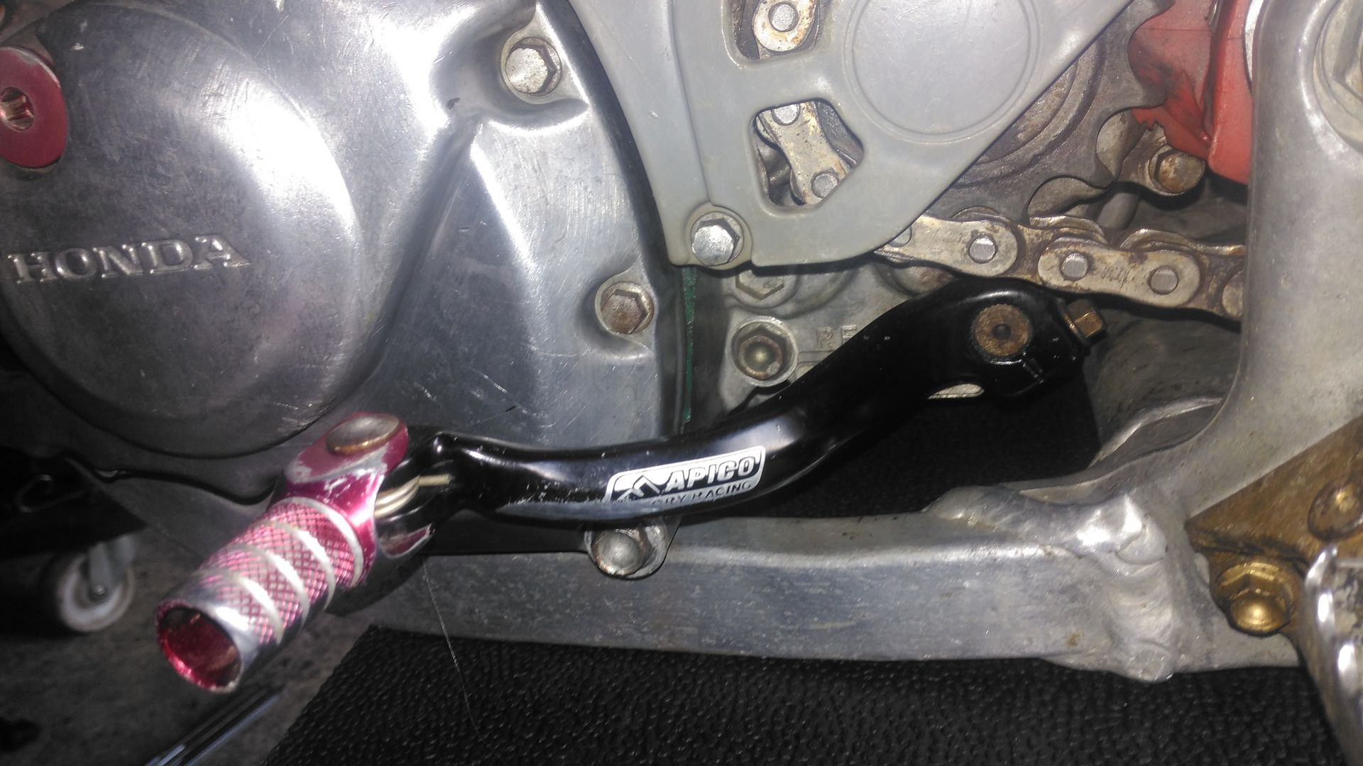

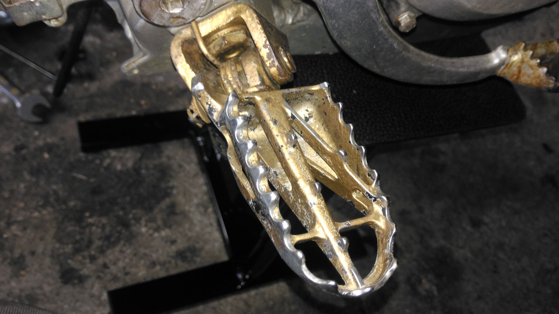

It does have solid gold foot pegs though:
:D Might have to strip them. And undo this chav-tasticness:

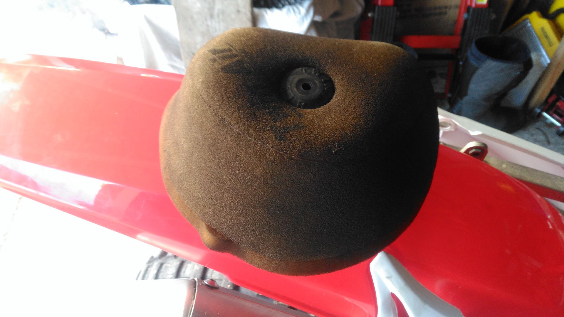

Air filter has seen better days:

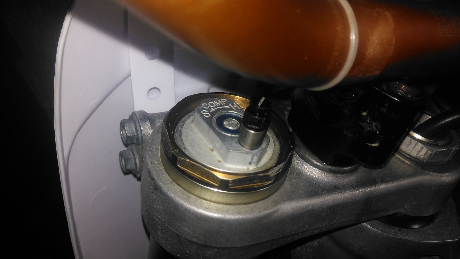

The fork seals were leaking like a MF when I picked it up, I suspect that's because someone hadn't been air-bleeding them. And this might be why:
So I managed to get them out and added some easy bleeders:

Put in the new air filter:

Stripped the gold off the peg mounts, and installed the pivot pegz, put in stainless clivis pins:

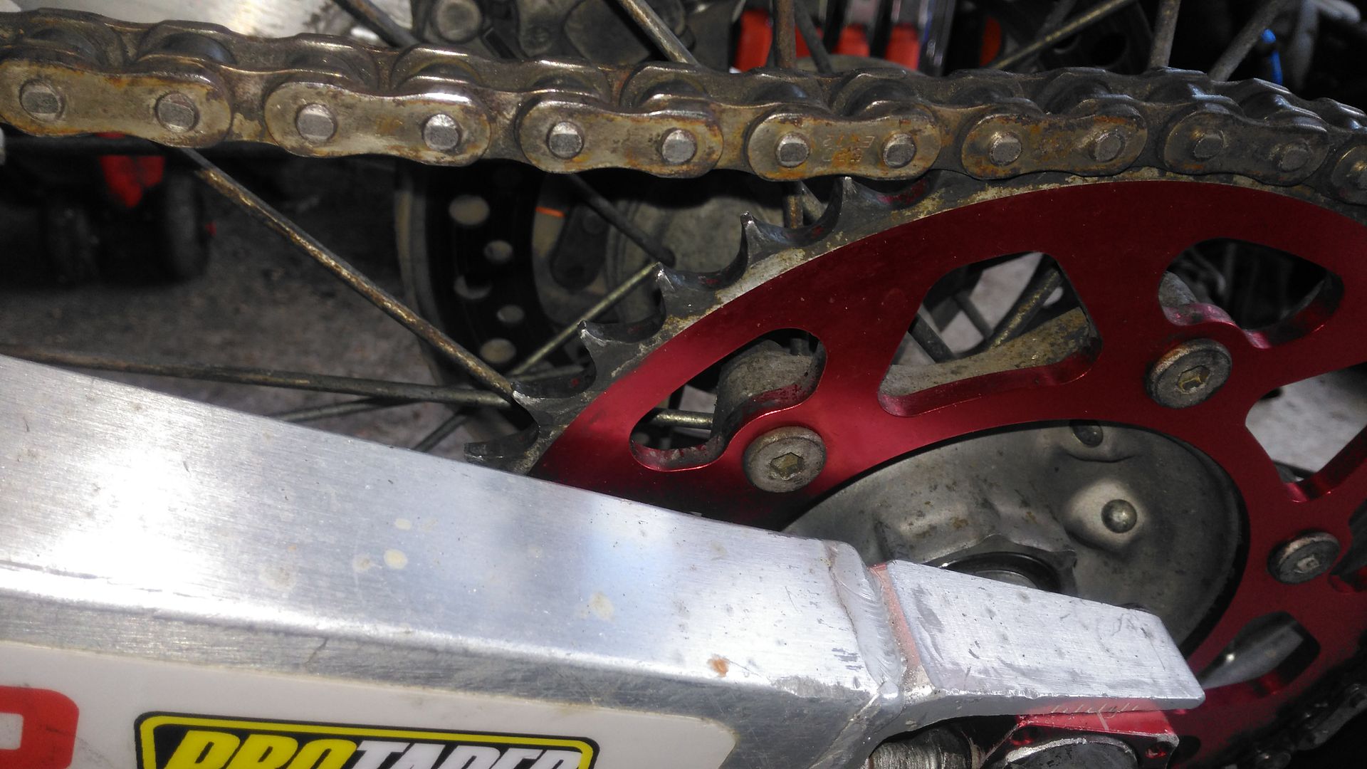

Then i decided to do something actually useful and got to work on the chain and sprox, but most of the bolt heads where rounded out:
So had to take the wheel in to work and do the ole "weld a bolt on" trick:
That was all i had time for, hope to get that job finished today.
