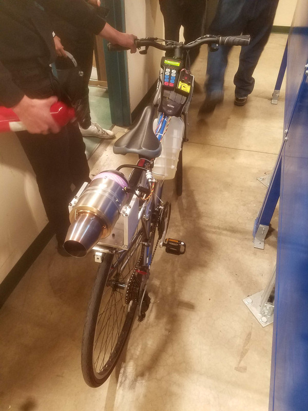

High school student in my welding class last semester and this semester brought in his jet bike project. Need to get him into building custom fighters.
