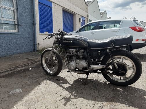

Dads been gone 12yr now, I really should do something with this
nothing drastic, thinking keep two seats, standard motor, nice little 2 up bike

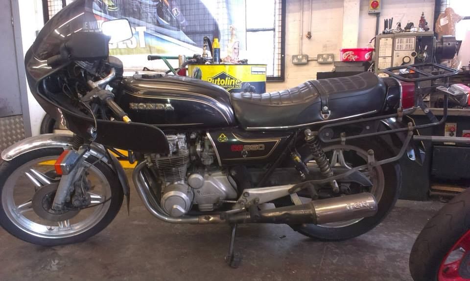

the start, barn door fairing, clubman bars and Gpz900rr motad exhausts

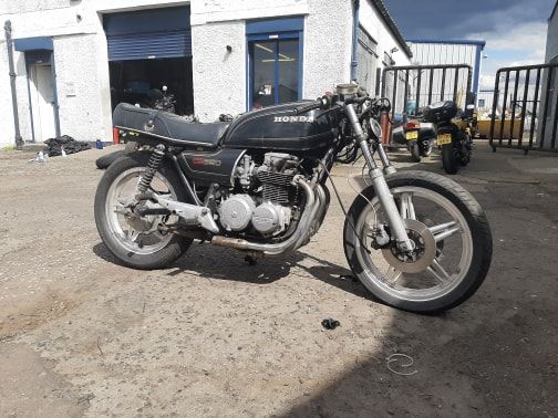

the time is now , or near enough, it's in the van waiting for the hypertard to leave the shed
got tyres on the wheels, not the final ones, but tyres all the same
dug out a set of calipers, the stock discs sit too close to the spokes for radial calipers, i'll sort that tho
its a cable clutch, so the zx10r master cylinder / clutch perch that were rejected from the present build will fit right in
found a couple of nissin rear master cylinders in the brake box, one of them will do, need to find a decent rear caliper tho
not sure about the clutch actuator on the Hondy, but I have this brand new Suzuki one if needed
