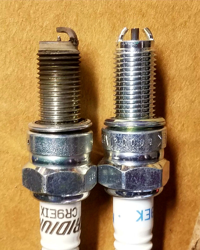

Spark plug was tight and looks right.
Other owners were recommending the Laser Platinum plugs, so I tried.
First new plug I found is OEM style.
Damn! Didn't realize how tiny the Platinum electrode is.
Test fired in the rain. Seems okay, but the problem was intermittant, mixed with good running. Will need a good test ride.
Leaving the body off, so I can clean it tonight. Get it back together tomorrow.

10,698 Posts
dynotech ecosse, my mates shop, they never use iridium plugs, they give no measurable power diff on the dyno, foul easily and don't clean up like normal plugs. Wullie recommends to his customers not to use them, I'm no expert, but he is, so I trust him on the matter
old fart
3,641 Posts
was told the same by the guy that does my engines/dyno work
Is my bike ok?
15,020 Posts
I tried iridiums in my '76 CB750 and it gave the bike a slight rough idle right off the bat. Got hard to kick after just a few rides. They were fouled. Put NGK's back in and it was fine for the next 10k miles. I mentioned it on a CB forum and got laughed at, so I never say anything about iridiums anymore since they're accepted as the hot ticket. Nice to hear I'm not alone on this
1,400 Posts
Never understood how a tiny electrode (Even as exotic as Platinum) could generate a large spark?
What would give a bigger arc? A .22 gauge wire with 120vac running thru it or a .8 gauge wire? I rest my case.:D
287 Posts
Well, to be the odd man out, I've run NGK iridiums in my KX250, now a 295 for years without problems. It is what Kawi specs on this bike. I have yet to foul a plug, but I have been rather meticulous on jetting it.
It kicks off within three kicks, even after sitting 4 or 5 months with stale gas in it. Once warmed up it will idle off choke for however long you wish, despite being a MX 2 stroke...
They run about $10, so I generally replace them every time I re-ring it. But I believe the current plug has about 80 hours on it, could be more. I can't say that the old plugs look unserviceable, but it's more the mindset that I don't want to be miles and miles from my truck if there is a break down.
I don't know if it's any better than a copper NGK, but I can't say that it's any worse, except for price.
I put NGK iridiums in my ZR550 (4 stroke) when I rebuilt it, and it seems to be doing just fine. Could be the wallet burn is making me feel warm and cozy...
Is my bike ok?
15,020 Posts
Since Kawi specs this plug as standard I wonder if something in the ignition system is specifically designed to work with it? My old CB had what was a notoriously weak ignition system so I figured I'd give the Iridium's a chance as it might help the old dog out. Looking back, it may have just exposed that system's shortcoming even more. Perhaps your bike's ignition is hot enough to make good use of them. Kawi obviously thought so.
Been tempted to try them again in the FZ. That bike can eat up a standard plug in about 8k miles.
