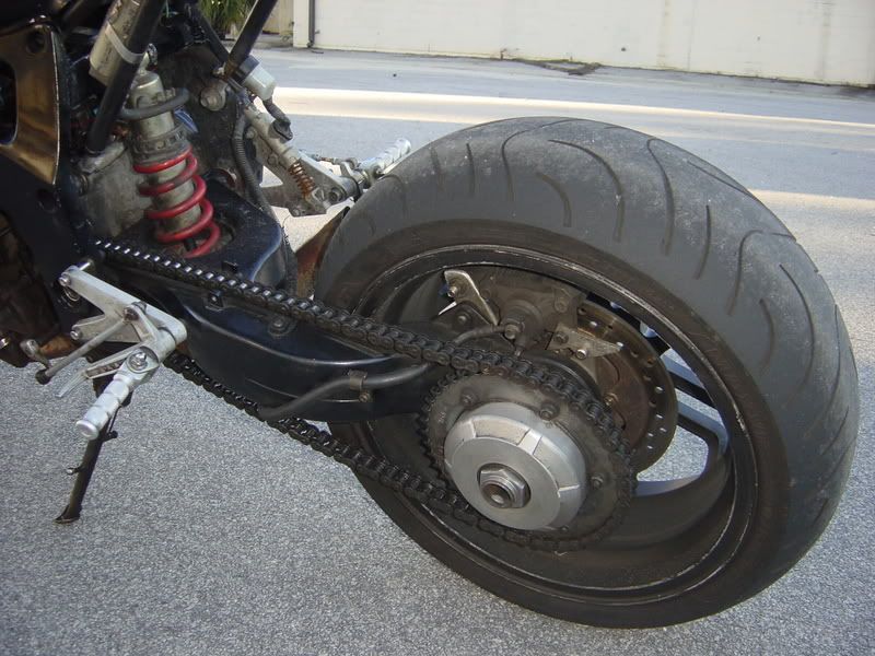

And... you have a car wheel on the rear?!? Is that based off the fact that the VFR SSS hub has the same bolt pattern as a... Honda or Accord or some such vehicle? Do tell more about that. Howd you get a bike tire on a car rim?
Yes, it does have the same bolt pattern as the cars. You have to use an adapter in order to make it work with the offset of the car wheel. It took me about a week to figure out how to get it centered. The nice part was the VFR practicly bolts right in. The wheel on the other hand took a bit to figure out. that wheel is 17x7 with a 38mm positive offset. In order to keep it centered and off the swingarm, It required a 1" adapter to bolt between the wheel and hub.
Very carefuly. :D Seriously though, it becomes a 2 man job to muscel it around the rim. Once you get it on there it takes a shit load of air pressure to get it to bead up. I think we filled it up to 75psi befor it seated. Also, soapy water doesn't cut it for lube. I used spray on axel greese on the bead in order for it to slip into place. We had to strap the wheel to the machine cause The tire literely explodes into place. Greese goes flying everywhere... it's a mess.
I think next time I'll try eather and a match. It may go smoother :jump_fire: :rolleyes:
I'll be sure to post up more pics and info once I get back to work on her. May be a while though. Working 6 days a week. Not a whole lot of time to tinker any more.
So you needed to move the wheel away from the hub an inch to get everything to line up?
Does the sprocket on the VFR swingarm attach to the hub?

Yup. It's one big spindel that goes through and turns inside big bearings.

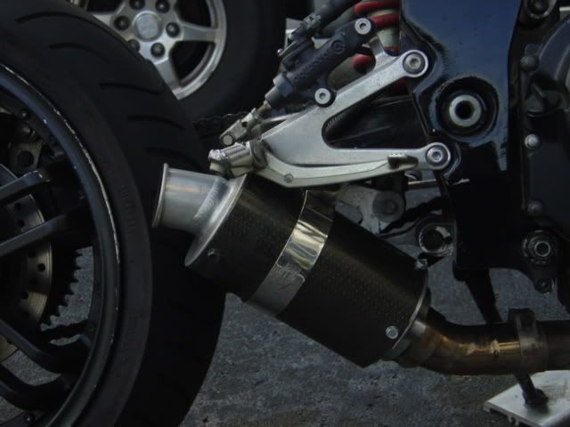

Another new mod. Made a new end can the other day. More of a neccessity that ended up working really well. The original muffler was actually a baffled exhaust tip ment for a car. (go to first post of this thread for pics) It worked well for a few years, but the chrome was getting rusty and was getting louder. Well the other day it blew the welded in baffel out on the way home from work. It went from throaty, loud and obnoxious to OH MY GOD! MY EARS ARE BLEEDING!!! It ran like crap too, so this needed to be remedeed quickly. Had an Yosh carbon bolt on from a 750 SRAD laying around. the carbon sleeve was pretty busted up but still had about 7 inches of good carbon left. I chopped off the bad section and cleaned up the ends. The biggest hurtel was making it match up to my mid pipe. Mine being a traditional slipon style. I needed to fit some pipe into the end cap. Unfortunatly, by this time all the exhaust shops were closed, so I took the original muffler, cut the mounting end off and used that. Befor I could fit it into the end cap I had to cut and beat out the baffel and press the new pipe in. This required a couple quick minutes with the sawzall, a chisle and a BFH. BTW, this mod wound up being a great stress releaver, :LolLolLolLol: . Once the end cap was made it was just a matter of cutting everything to length, fitting it together and drilling and tapping the bolt holes. The pipe sounds great. Has a nice rumble to it. Not to loud with an even tone. Kinda wierd actually. My bike has bass :D . Also helped out with performance a bit. Bike runs real smooth. I had a small flat spot in the middle. took it right out. I gota get some button head bolts for it and maybe clear coat the carbon to bring it back out.
