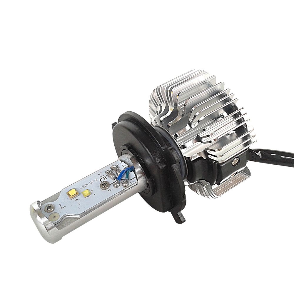

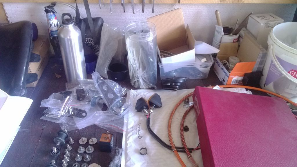

Here’s the headlight
With a little improvement because the stock headlamp was not very good

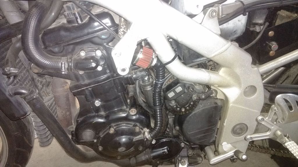

Now a little mod but important, separate the breather from the airbox (very important in case of fall when engine is running)

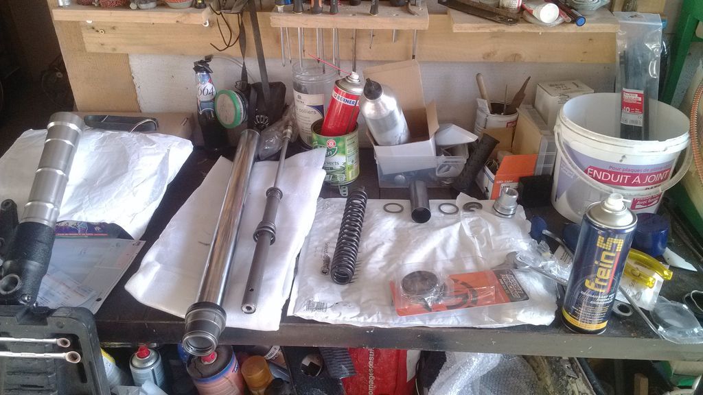

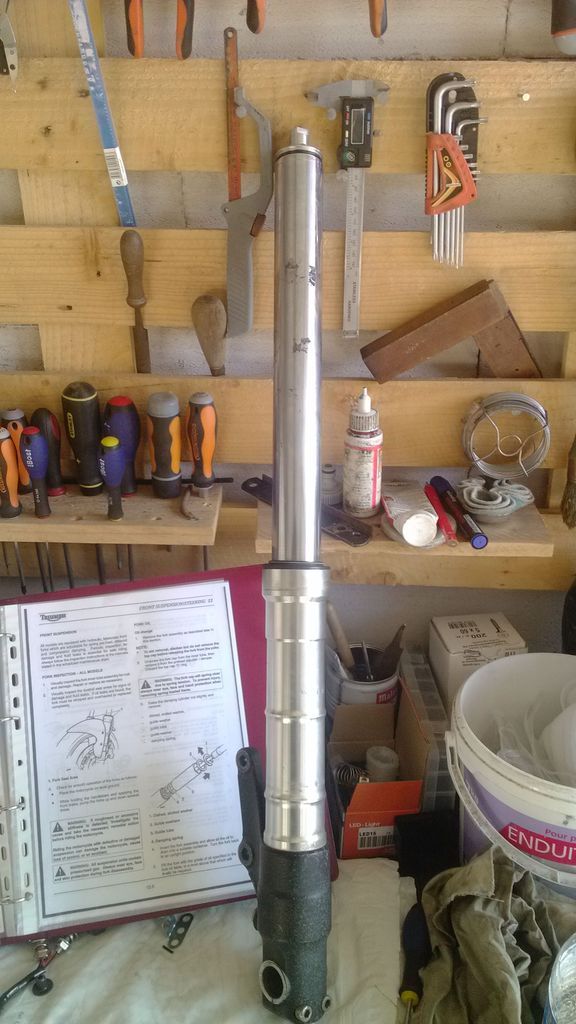

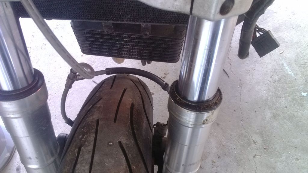

I also decided to service the front fork (oil & seals)
Quite easy and simple, I thought it would be more difficult but everything went well!
Who wants some old and stinky fork oil?
This one was very nasty, covered with rust and oil! I don’t know why but the washer was between the dust cover and the seal instead of under the seal…

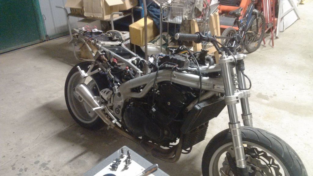

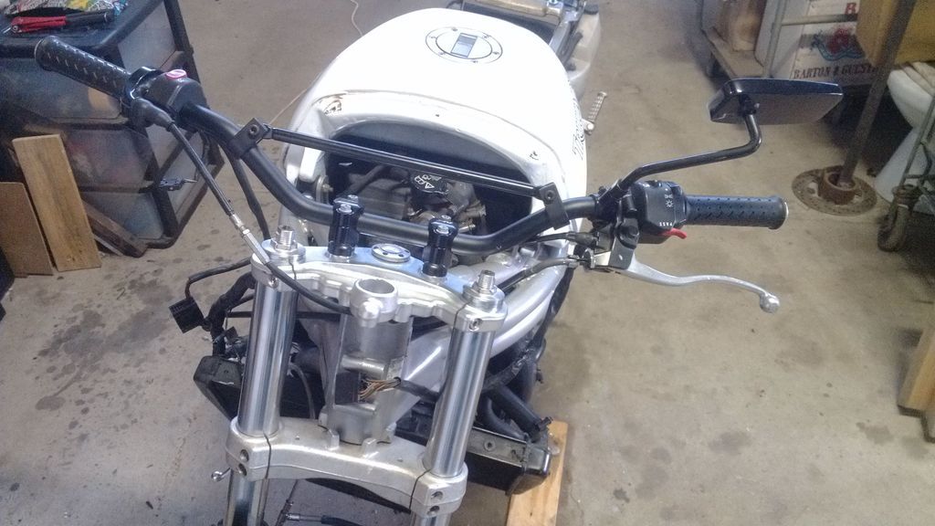

Clip-on are replaced with a handlebar
Got these high position double slip-ons away for a way better (in my opinion) GP style from Spark Exhaust
Now because of the handlebar, brake lines are too short and also need headlight brackets

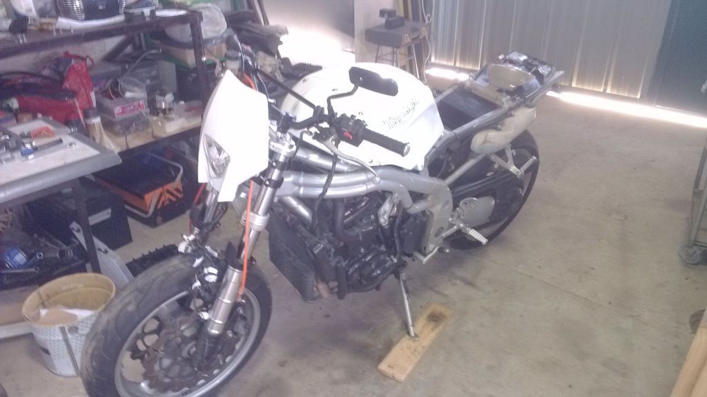

Finally I tried to put the headlight so I can see the way it will look at the end
And I have enough space to mount the speedo, oil gauge and key ignition
Now I have to make brackets for the speedo, oil gauge, key ignition and dummy lights.
