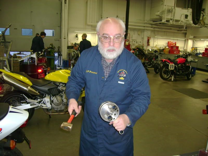

Three months ago I arrived in Fairview Alberta to take a motorcycle mechanics apprenticeship course. When I arrived there was only one other student here who has his own bike. Endo arrived with a 1994 Kawasaki ZX6E which had the fairings torn off, the seat unit (fit replaced) with an R6 unit which is painted chalkboard black, every morning Endo gets a new wierd message from his classmates, and an Acerbis headlight. It was to be his, "learn on it," bike.
And man did he learn, every bearing on the bike was so seized it could more accurately be called a bushing, both axles and swing arm pivot bolt were too worn to be used safely. Every external seal was shot, and the front tire was so worn it looked like it may have been a race slick (the rear was replaced before he even arrived here!). The carbs looked like they had never been cleaned or synced. The forks had more oil on the outside then the inside
Most alarming was the liquid balance inside the front wheel, which even years later was still liquid and so slippery that your fingers would still feel slimy the next day if you made the mistake of touching it. That alone was an hour of painstaking cleaning, it wouldn't take much of that stuff to make the tire slip a bead.
In bits and pieces between class projects and in free time Endo slowly began to bring his bike into running shape. First a new front tire was sacrificed at the hands of the pneumatic tire change machine god. A second would have to be purchased ARGH! The crystalised sludge that was the original brake fluid is replaced and the metal brake pad liners are switched out for brake pads that actually have pads on them. Then the fork seals and oil are changed, followed by rebuilding the steering head. What a long and painful process it was to drive those lower bearings off the steering stem without causing damage to the stem. My offer to, "just lop the steering stem off above the bearing race then pound the race off," was not met with amusement. "But I've got my hacksaw here and everythin... aww... just a little?? No... awww... c'mon. Okay Okay put down the sledgehammer, I'll leave."
