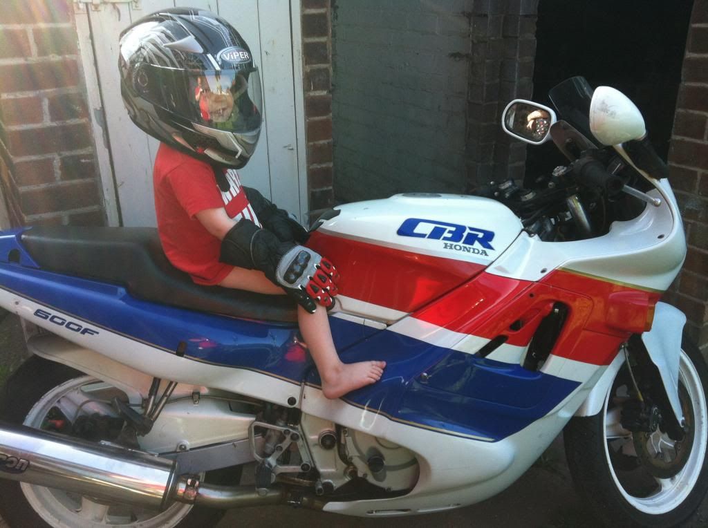

i first bought the bike of one of my college mates
when i bought it he showed me it ran it looked in good condition so thought can't go wrong for £300. when i got home i started it up all was fine except the ticking noise which i heard was a common problem with the tensioner so didn't bother me that much so took it for a ride down to southport not to far from mine,as i'm riding along one of my side panels flew of luckily there was no one there so got to nearest shop and taped it up and carried on. next day wouldn't start no electrics nothing checked the battery was completely dead charged it and working for a day or to then dead again so checked for a drain found one in an old alarm took the loom out and had a look at it was in a mess whoever had these prior my mate did a bad job found a cheap untouched loom on the trusty ebay but in the time that came i thought i know what be a good idea lets see what else wrong and sort it so first on the list was the engine. the engine was filthy looks like it hast had a wash in the 26years its been running which made me think i'm going to regret this but when i opened it up it wasn't actually bad at all was pretty shocked.

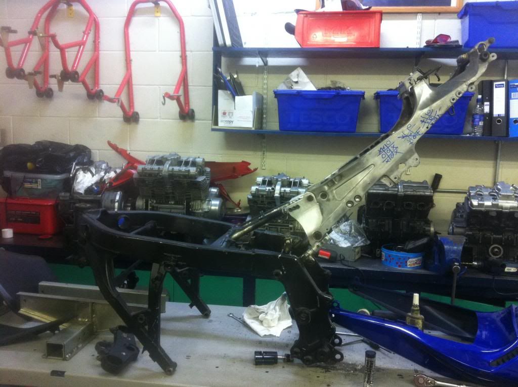

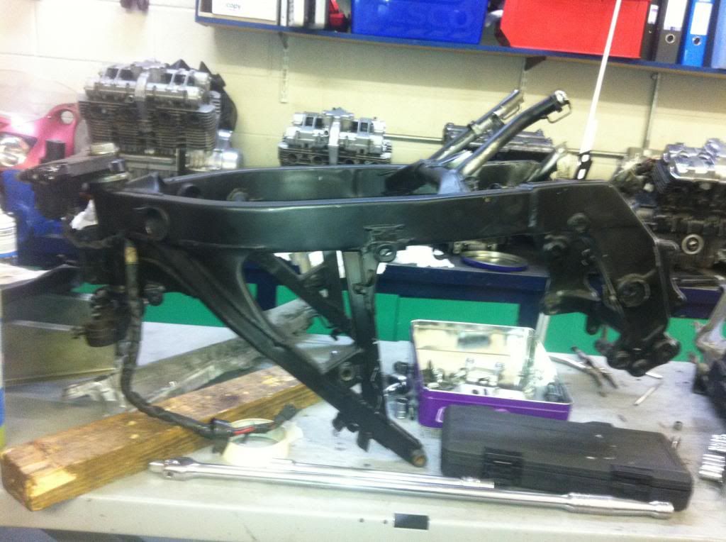

The main frame was in good condition but the subframe was falling to bits seen a few people go with the rr look and i thought yaa i like that so stripped the rest of the bike took the frame into the college workshop but seen as i had very limited amount of money and no welding equipment had to find a alternative.

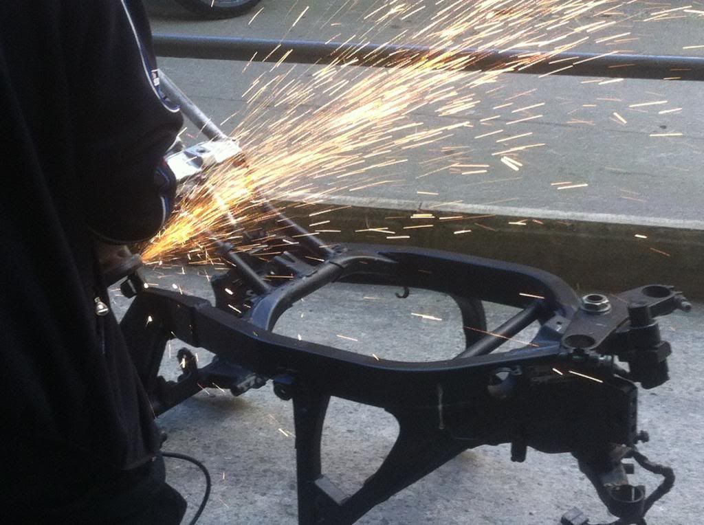

so started chopping
then came the how we going to do this but managed to figure a way that could work so got a start on it we got some solid ally rods cut em to size to fit them into the old frame and then bolted them to it and made a plate to put the new subframe on

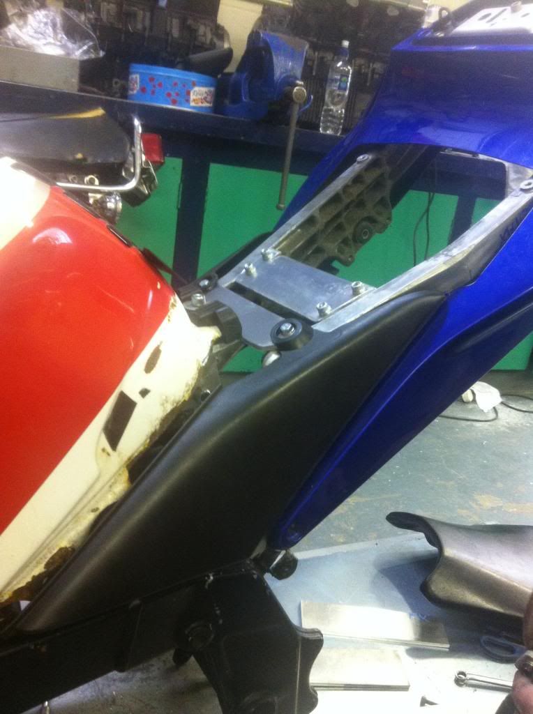

made a new bracket for the seat and tank
