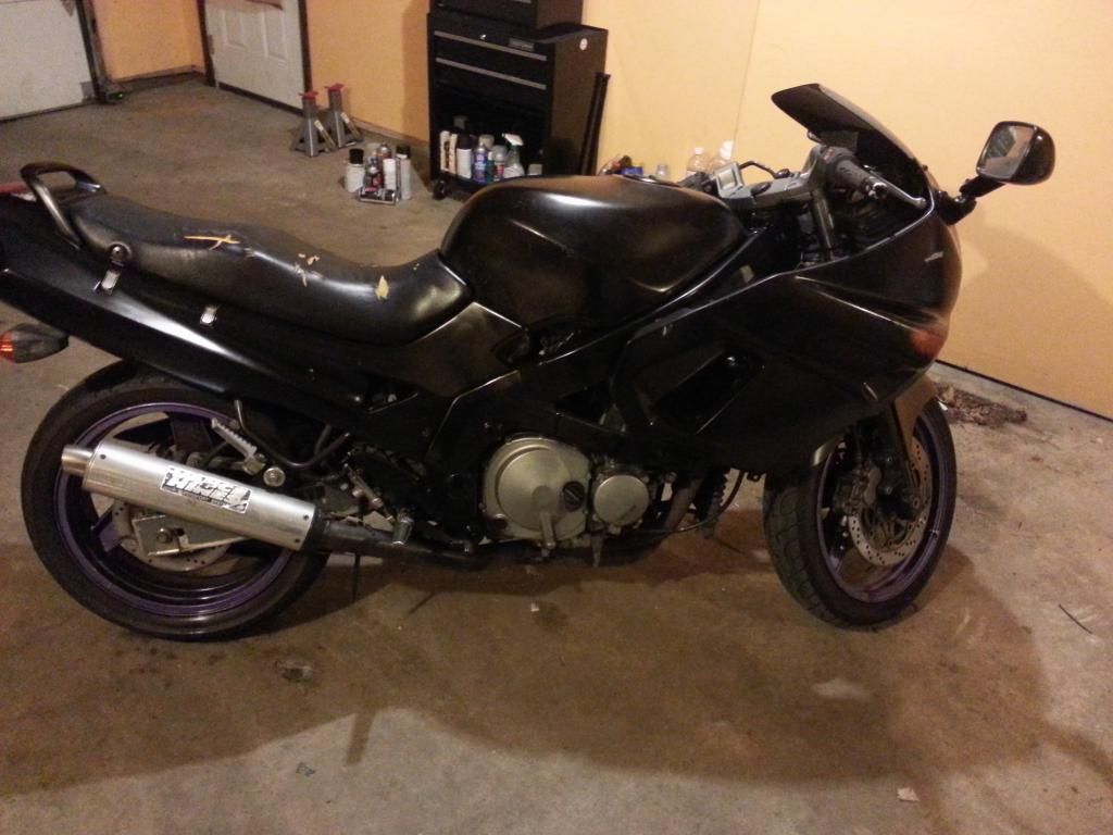

Here is how she sat before:

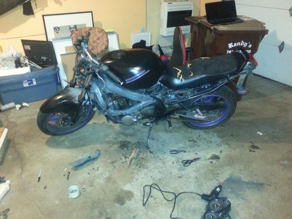

and After:
all criticism, tips, hints, thoughts would be awesome
