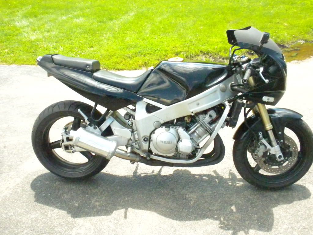

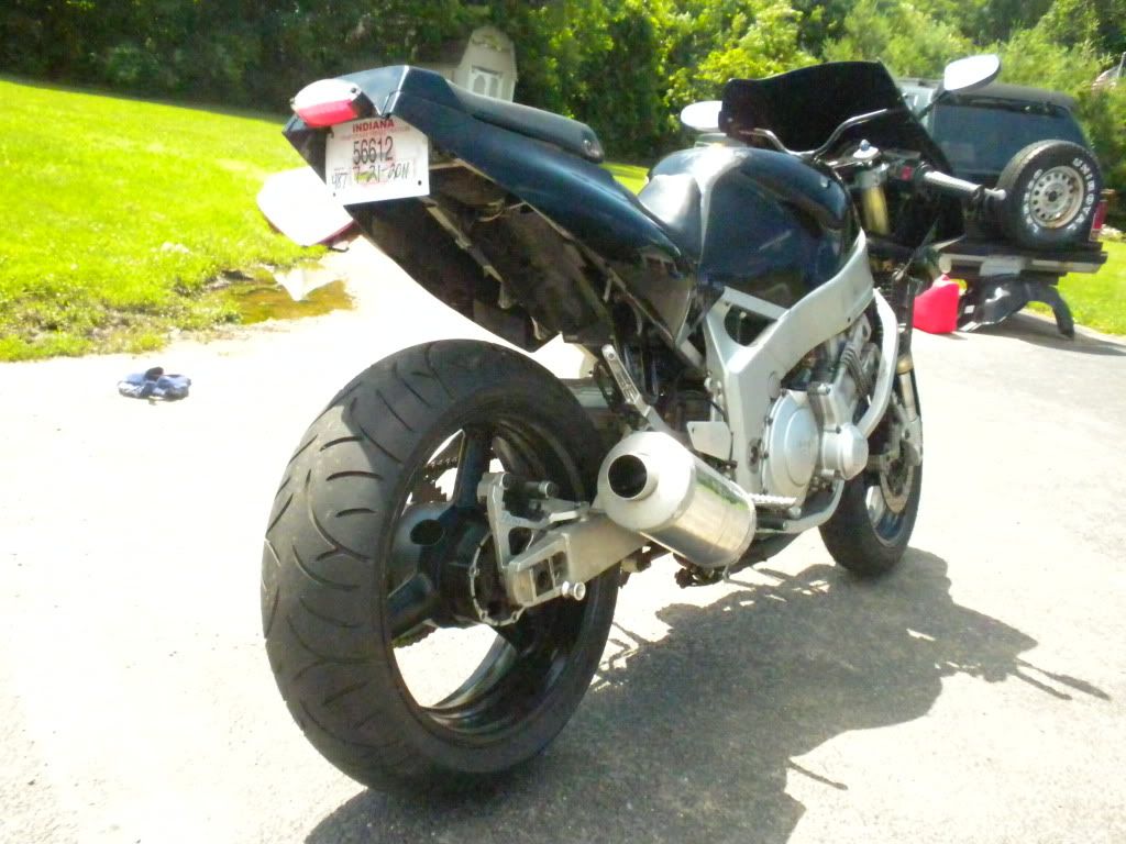

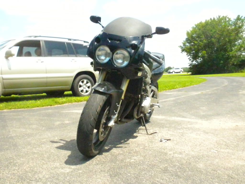

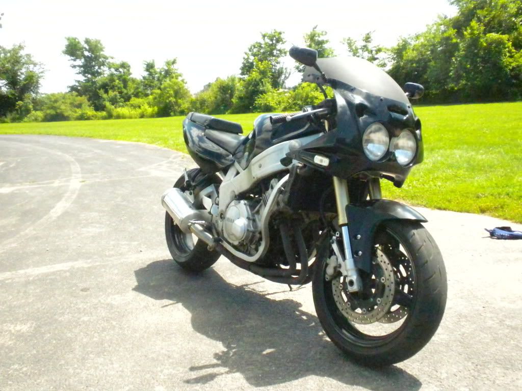

so i just got my newest bike on the road after its been sitting in pieces for about 4 months ive still got a lot to do and im gotnna try and keep this uppdated with pics cuz every body loves pics so far i have dome a swing arm swap from a 2000 r6 and a fork swap from a 2000 r1 on my little fzr 600 i wanted to be able to run modern street bike tires so now ive got a 180/55/17 back and 120/70.17 front mission acomplised
theres still alot left to do im gonna do a tank and tail swap also i have a yzf600 tank and a 2006 r6 raven subframe and front seat and a 2000 r6 header im gonna put on there eventually it will get a 2004 or so r1 belly pan a nice guage set and prolly a mt-03 head light
