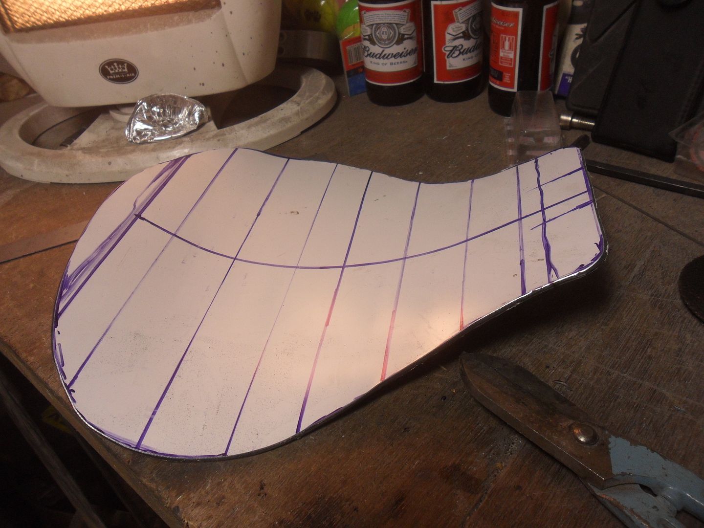

well i started by mocking up a seat with a piece of skybond
little bit of scribbling
and a bit of chopping
and we have a seat base , way too flimsy for use, but a good template

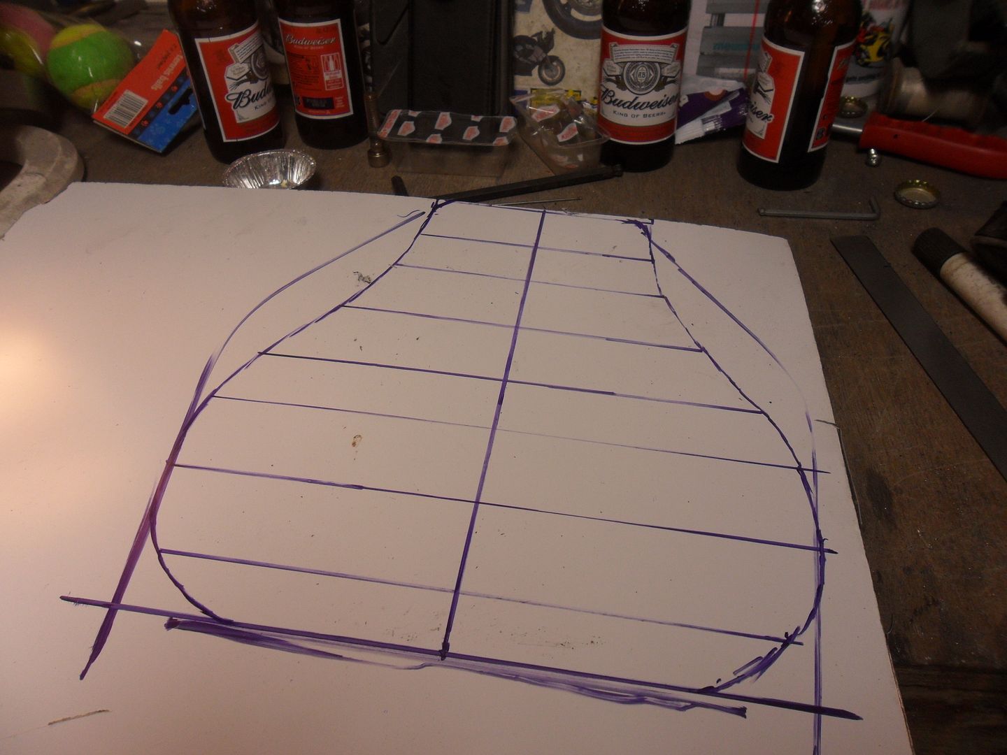

i made a paper template from the mock up seat , and folded it in half to check symmetry
then copied it onto the steel
and with nothing fancier than a 6" angle grinder i chopped it out, changed to a sanding disc and dressed the edges and then drilled the mounting holes
