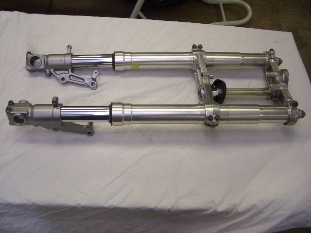

I bought a gsxr front end today for swapping on my 1985 zx6a1 has everything but the top tree
The guy I bought it from is not sure what year the front is
I will get some measurements posted in the morning but if anyone might be able to tell from the picture let me know
thank you

Thanks you guys for the help but one more question
Is there anyway to find out the exact top tree for these maybe part number somewhere?
I have found a 96-99 750 top tree but do not want to buy it if it is the wrong one.
It is cheap enough to buy but I do not really have money to be throwing around.

· Bitches love Fighters
5,334 Posts
here is a 96-99 750 caliper mount
and here is an 01-03 caliper mount. which do you have?
· Tiemishuu
58 Posts
Thank you so much for the pic comparison.
I have the top ones so 96-99 whoop whoop now I can get the top and get this bike finished
The gsxr bottom is about 1mm bigger than my stock stem and the top is 24mm and stock stem is 17 at the top
Do you guys know anyone who can modify my stock stem to fit either in socal or online?
