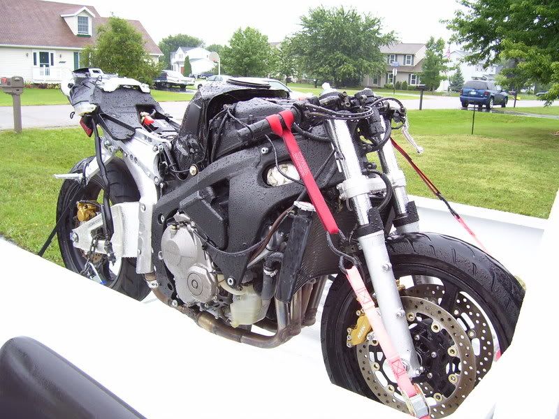

Spending Log
Cost of Bike: $1600 (total cost of the busa I traded for it)
Brembo M/C: $35
Shift Lever: $25
Race Upper: $100
New DB windscreen: $25

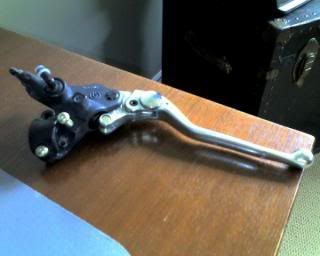

Brake lines: 1 free, 1 $40 (spiegler and galfer braided lines)
Pressure-switch dual banjo bolt: $20
Fairing stay and heim joint for rear brake: $60
Misc bolts: $5
Paint: $8
Total so far: $1918

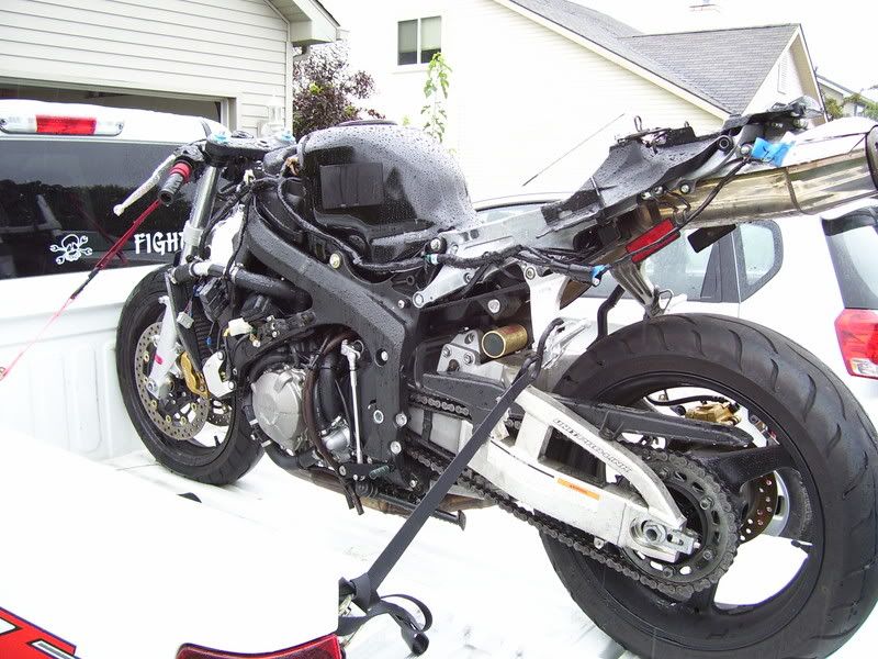

First arrived
Traded a 'busa for it
Parts

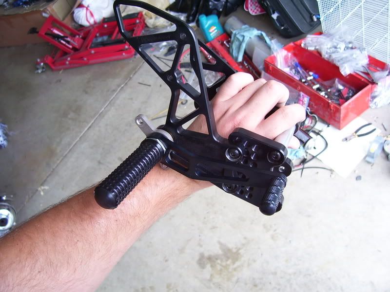

Grand Dragon Gear rearset prototype - left side - needs a different shift lever (remember, it's a -prototype!-)
Right rearset - just needed a couple washers to get it outwards
Any idea where I can get something to connect these two?

6,774 Posts
http://www.ronayers.com/fiche/200_0..._cylinder.cfm?man=ho&groupid=5250&parent=5240
or, do it Zuki style, much easier:
http://www.ronayers.com/fiche/300_0..._cylinder.cfm?man=su&groupid=5460&parent=5450
OR, make it yourself:
1. get a piece of strapping about 1.5" long X 0.5"
2. Bend into a U..to be upside down.
3. Drill hole in "bottom" of U for master rod to go through.
4. Put nut on top and bottom of rod, lock onto U.
((probably an M6))
5. Drill hole through sides of U.
6. Put end of lever between side of U
7. Insert pin through everything.
See easy.

gotta get a banjo bolt and a resevoir hose for the front master...

I'm gonna find a couple combination banjo bolt/pressure switch things because neither of my brakes has a light switch and I just recently decided I was gonna make it streetable for some stupid reason.
