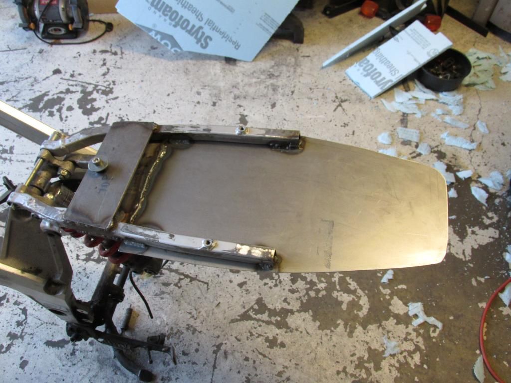

Next I went to work on the sub frame
and under tray.
And finished with the battery box and plate bracket
And this is where I'm at now. I went ahead and threw the swing arm and old wheel back on to make sure the license plate would clear and be visible.
