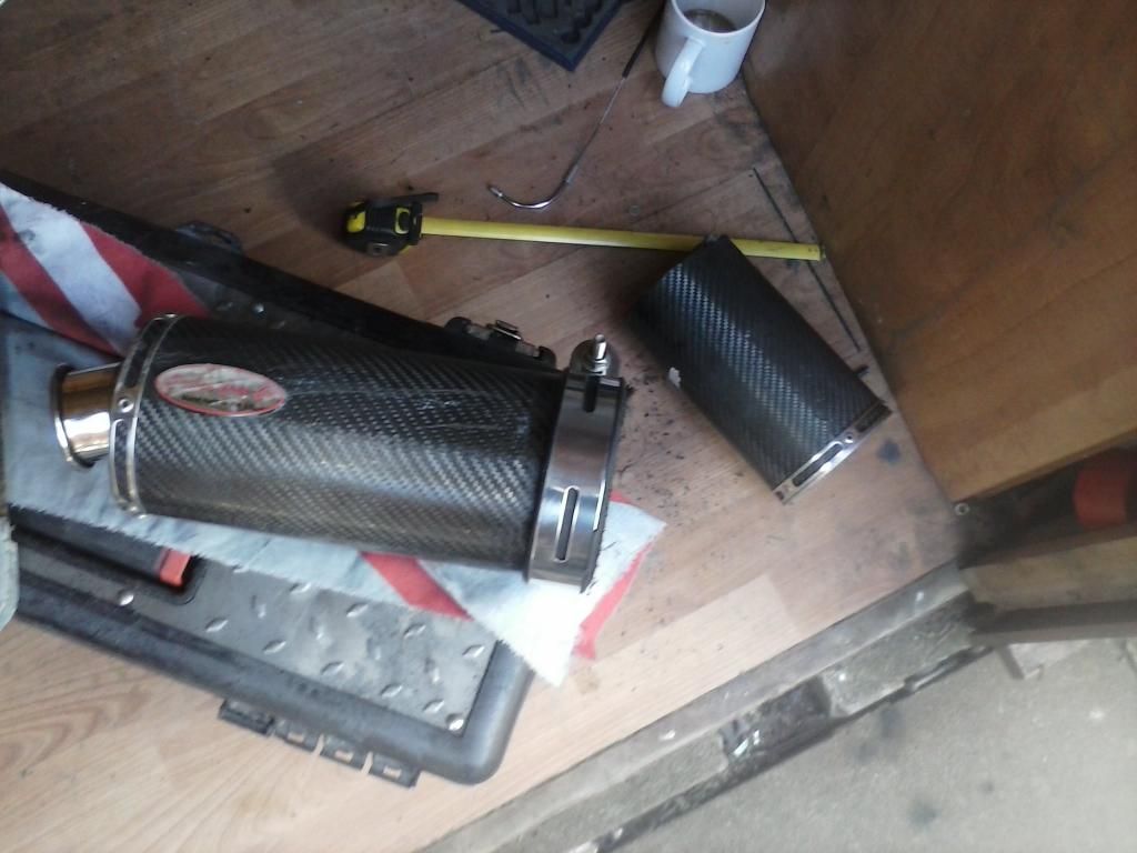

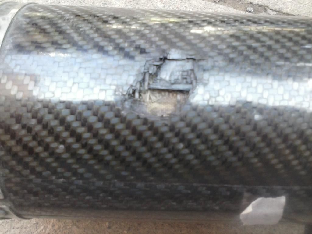

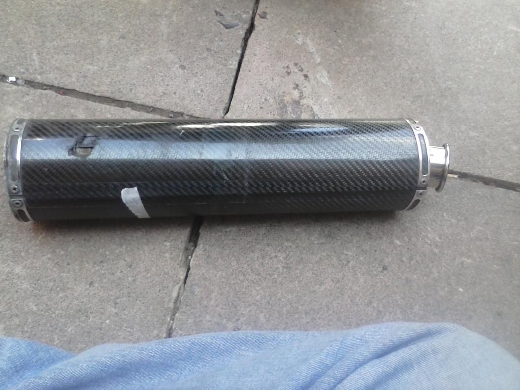

Found this horrible little bugger on my end can...
So now is the perfect time to Stubby the end can.

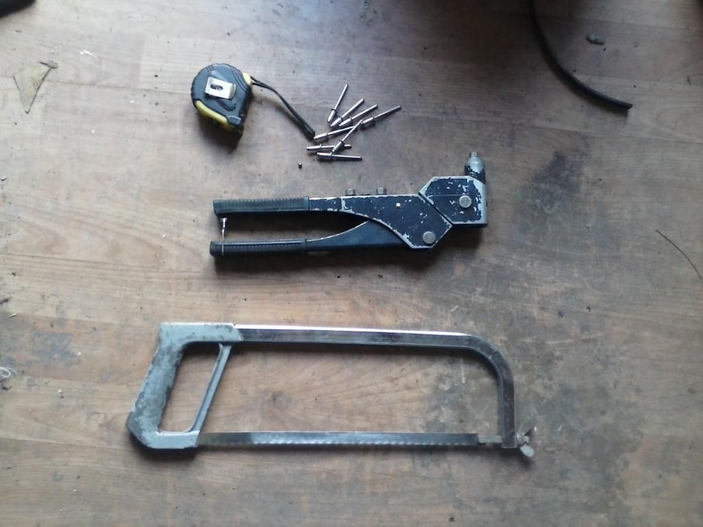

Tools used: rivet gun and rivets, hacksaw, tape measure.....and a drill but not pictured....

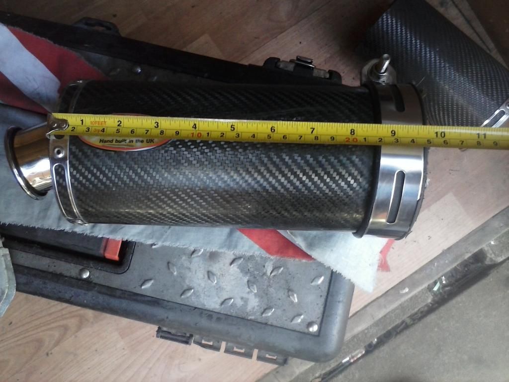

Firstly, determine how long you want the end can, i opted for a 10 inch can ( excluding ends ), mark and make the cut.
I found using the exhaust hanger bracket was ideal for insuring a straight cut.

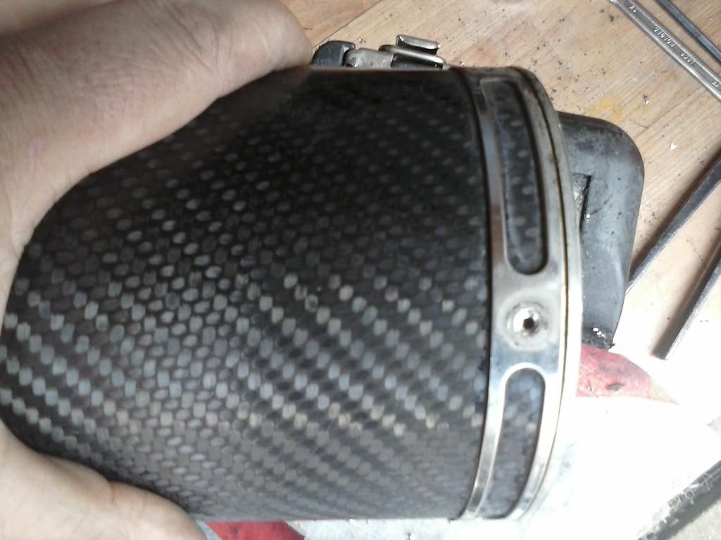

Drill out the old rivets from the back or front depending on which part you are keeping...

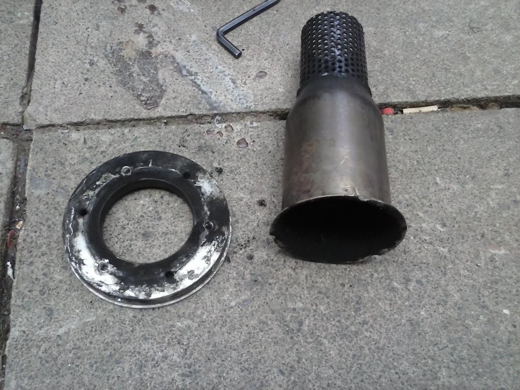

once the can is in half and the rivets from the other end are removed, remove the baffle tube discard/keep what you need to re-join the can..

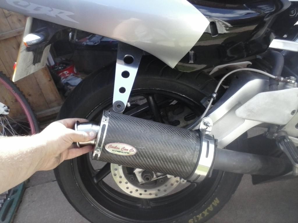

quick mock up as i am rather impatient!

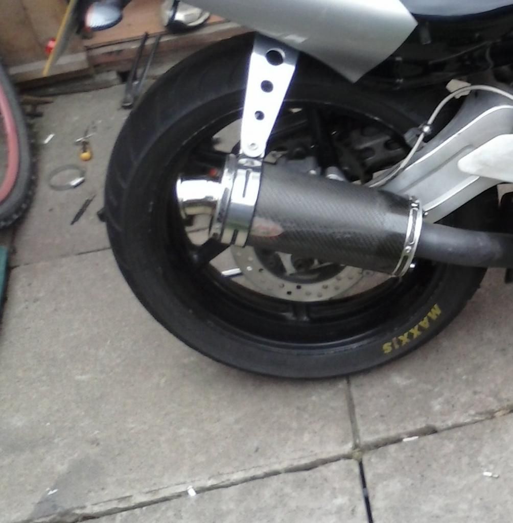

once everything is in place, re-rivet and you are done :thumbup:
Finished and looking rather sweet
