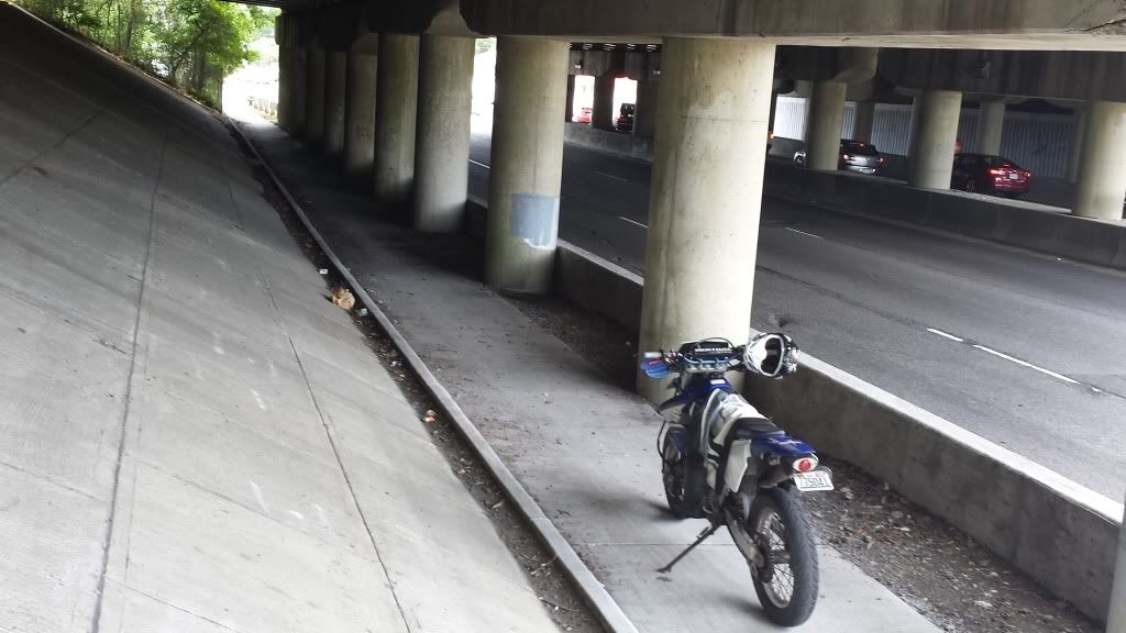

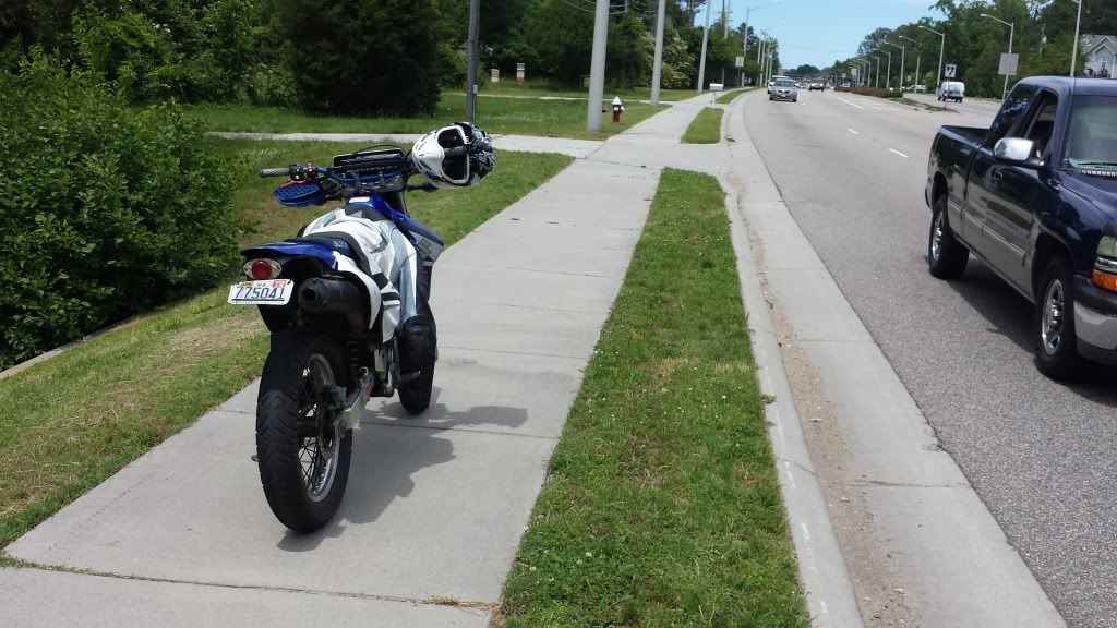

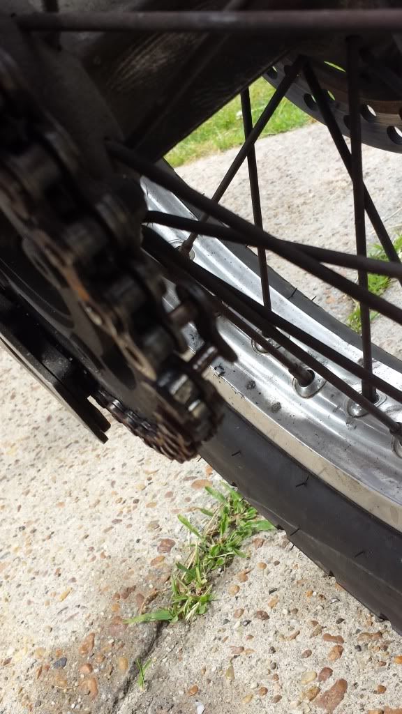

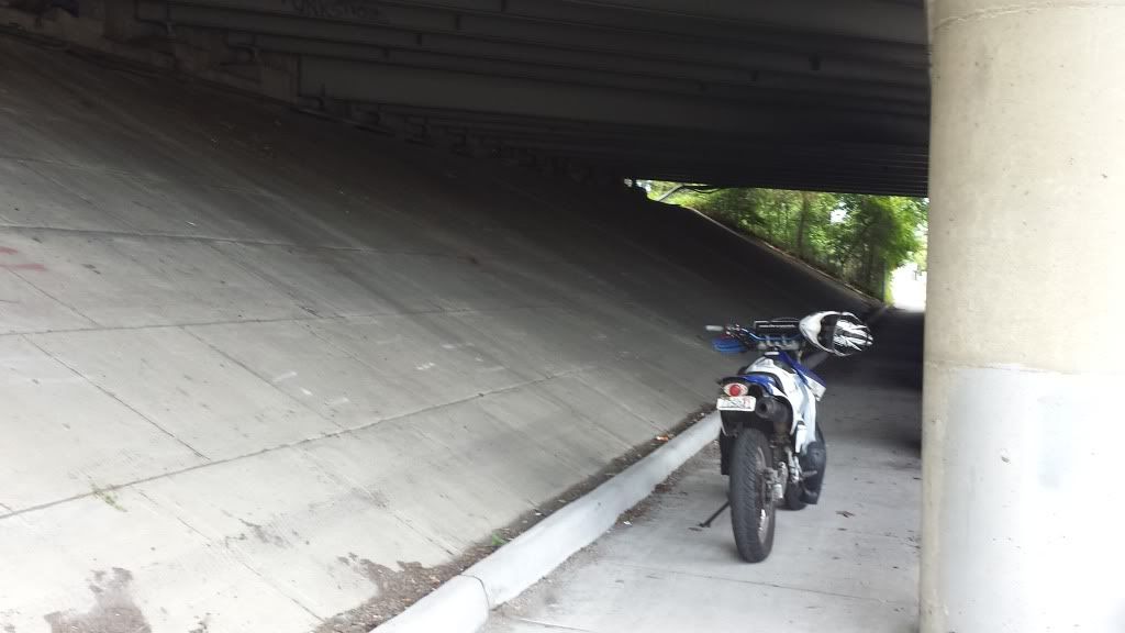

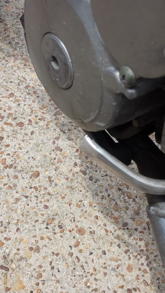

At least I caught it on video this time tho the bike started right after but when i looked if over after i turned off tge video, the master link clip had snapped (see pic) so I had to push it the 4 miles back to the house. All in all not too bad, ankle hurts but that's it
Crash video
http://youtu.be/fYh-qvMe0rI
Bike damage
Couple pics from breaks on the walk home

here's an old fart racer trick. when installing a new chain with a clip type master link, first make sure it's installed the right direction and seated in the groove. then give it a quick wipe with some brake cleaner, and glue it on with a generous daub of silicone sealer. personally i prefer black, it seems a little stronger. never lost a master link clip that was glued this way. beats the shit out of walking, or pushing.
