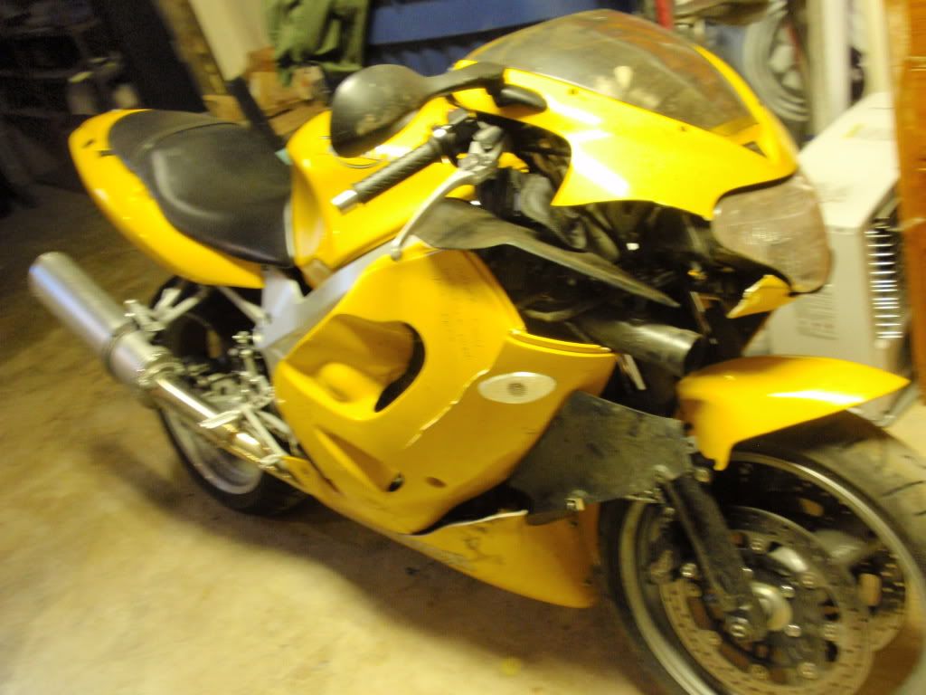

Hi all. Just wanted to intro myself! I've been perusing the site for a while, I love the beginner's section! I recently aquired a tt600 from a battle buddy when we got back from Iraq (May).
Here it was in the beginning...
When we got back, my battle buddy dropped it coming around a corner. To make a long story short, he decided he wanted to focus on his Harley and Bronco instead. So he GAVE the Triumph to me. Yeah, who passes up on a free bike? he knew I wanted one, but couldn't afford to pick one up right now. So... a few days later, I go pick it up.....
