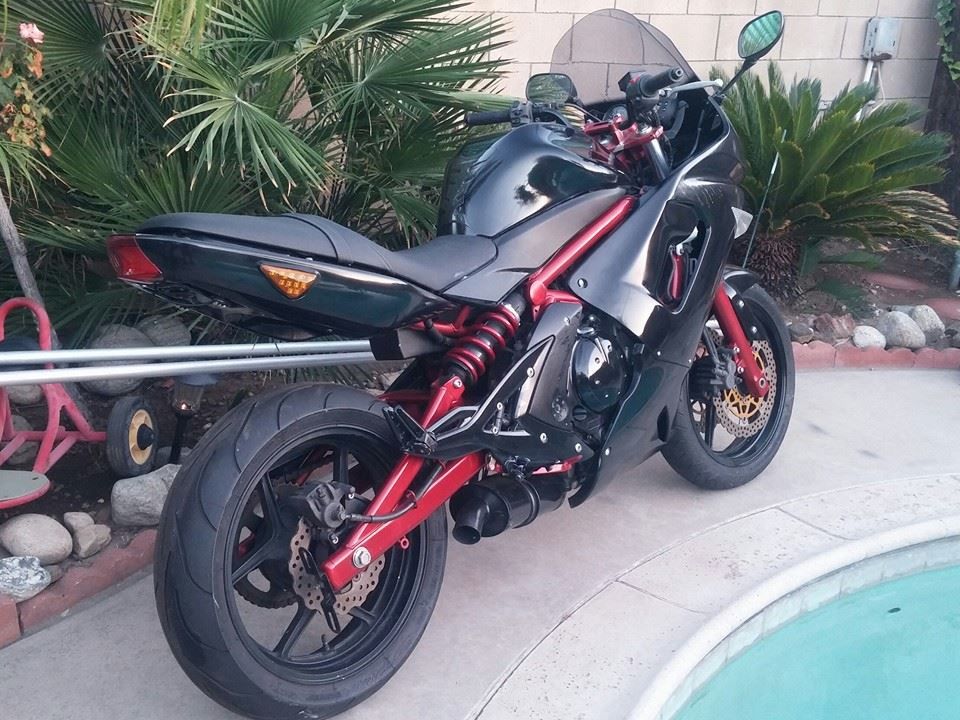

2007 Ninja 650r
(Before)
(Last WeeK)
Those are my current Projects. My priorities are 1.)Ninja 650r 2.)929rr 3.)VFR800

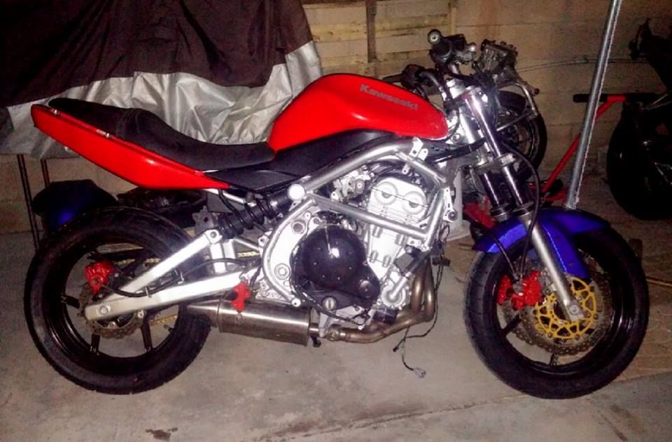

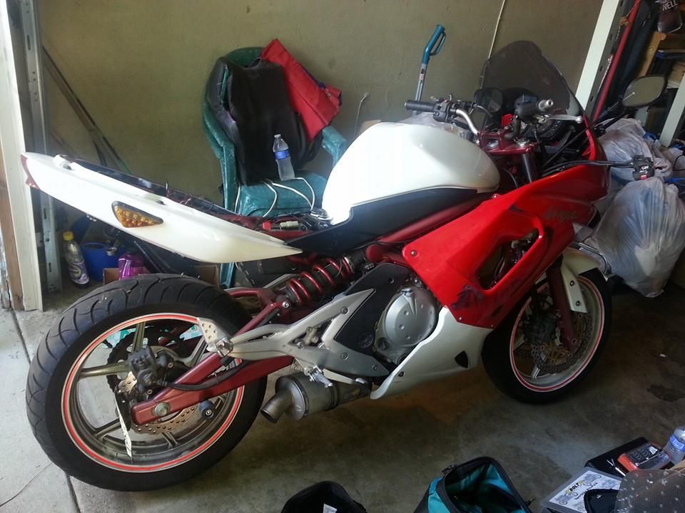

I had some difficulties with the second Ninja 650r street fighter project. I had tons of broken parts, I didn't know if the bike was running, no keys, and the frame was damaged! (see frame damage below)
Photo does not look like serious damage but the crossmember was distorted because of some cheap frame sliders the last owner used when he crashed.
So, I bought a brand new frame from Alabama!
Here is the pictures of the progress up until now.
I will take pics in a bit of where the bike is currently at. I am sorting out bracket for headlight and dash.

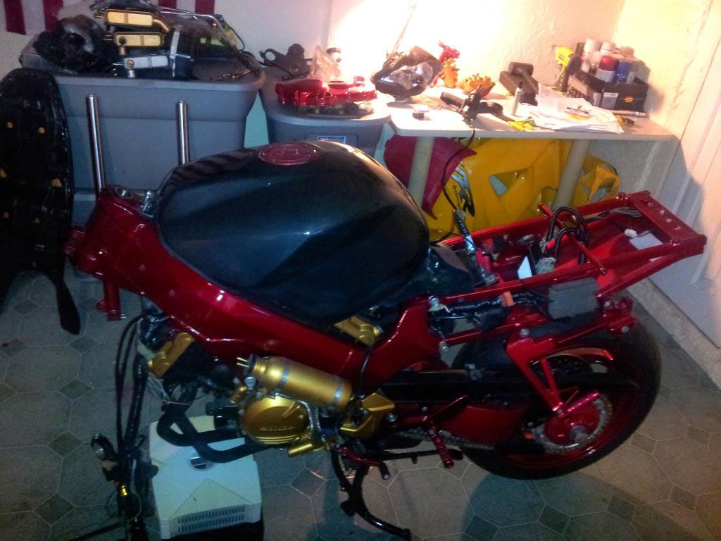

Here we go! Here are the pictures from today. I installed the radiator and finally heard the bike run! Only problem is. I see slight condensation in the oil fill window. Any ideas on how to tackle this issue? Obviously, I'm not done with paint.
The Hell You Say!!
2,956 Posts
If the bike has sat for a while without running then it is probably just normal condensation build up. Let the bike get up to operating temp and let it run for a while to burn off the moisture.
