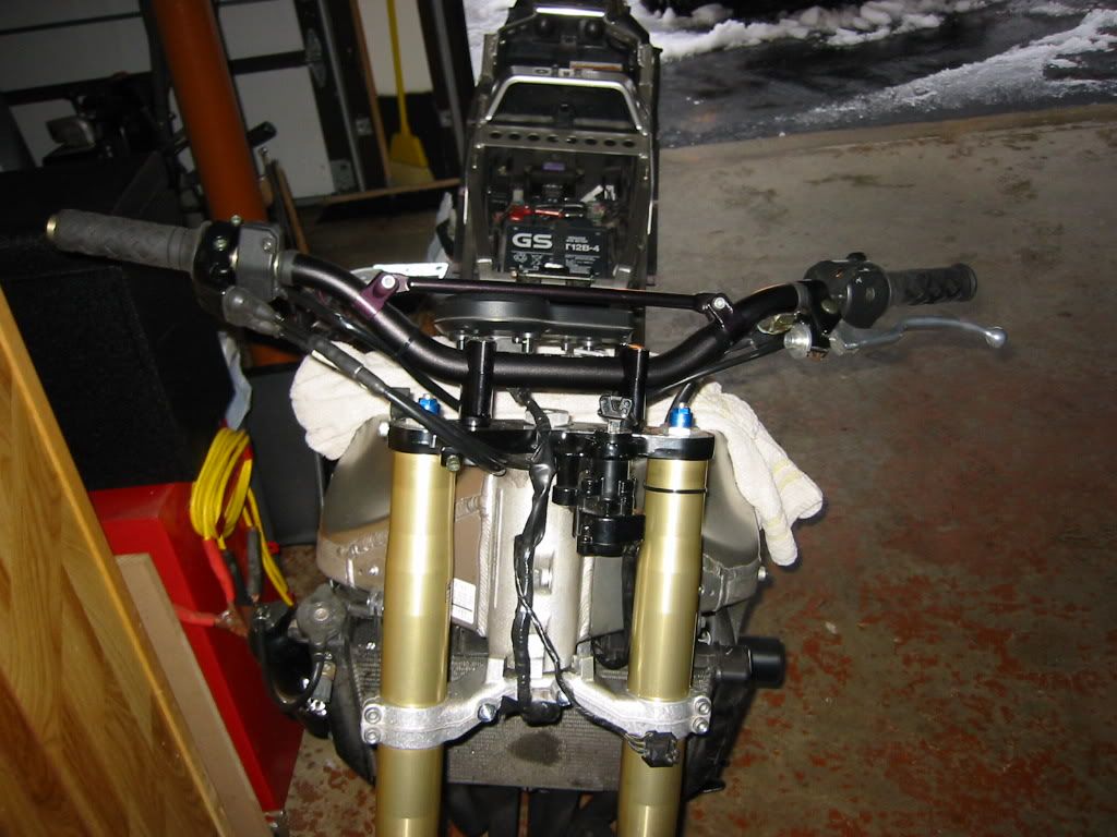

I built this fighter 2 years ago out of a 2001 Yamaha R1. I loved that bike, most everyone else hated it because they saw i when it had full fairings and was a "Pretty" red color.
I wish I had more pics, but I crashed it and got rid of it before I got a chance to take more pics.
The overflow I made some brackets and mounted up a CO2 tank. The dash I made a bracket and had it mounted under the support bar of the rethal twin walls. The paint was a matte black with a no gloss clear over it. Tell me what you think. I have a 2005 Yamaha R1 "Raven" right now and I am seriouslly considering turning it into a fighter. If I do, it won't be for a few months because I should be moving from NY to Cali within the next few months.

Looks (looked) good! Can you tell me exactly how your made that overflow? I'm looking at doing something similar but I can't figure out what to use to attach the hose. Did you have an overfill drain on it also?

For the overflow, I used the preexisting radiator holes (For the stock overflow) and built little brackets to set the bottle back and as close to the bike a s possible. I bought a CO2 bottle and unscrewed the top. Then I got a rubber plug that fit in there tight, and drilled out two holes in the rubber plug. In one I put in a hose adapter for the coolant line, and the other I put in a hose adapter for a vent. Pretty simple setup, but it worked well. I used exhaust clamps to mount it up. Wish I had better pics.
