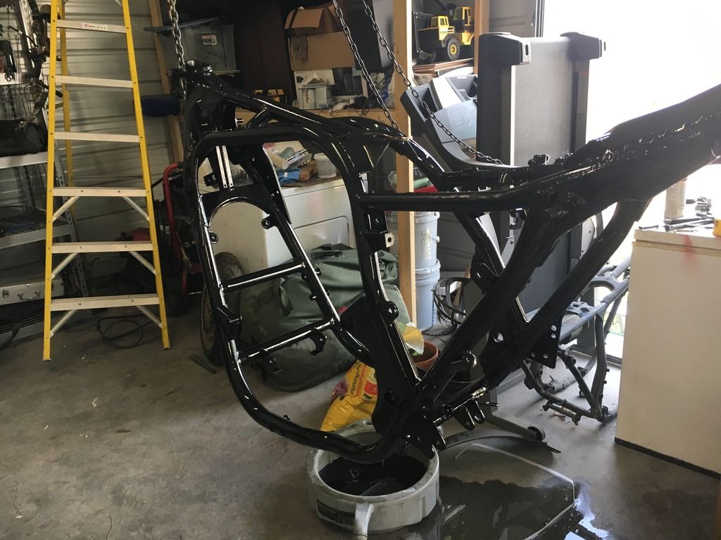

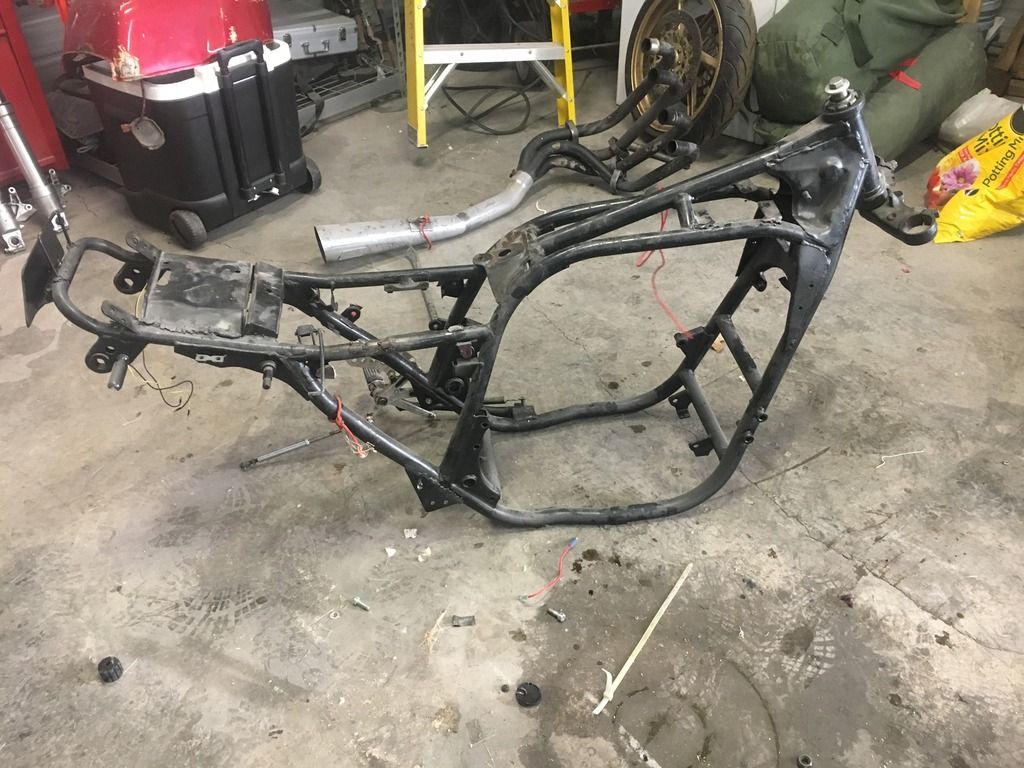

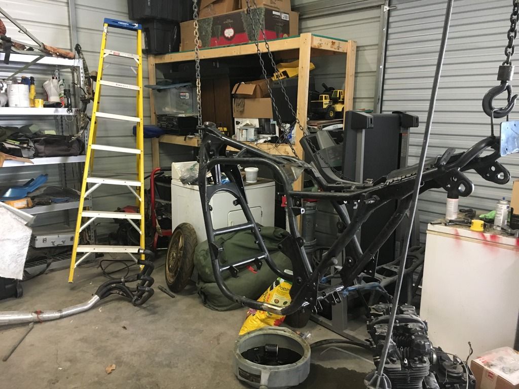

So work was done!! I already had it stripped down back to a bare frame.

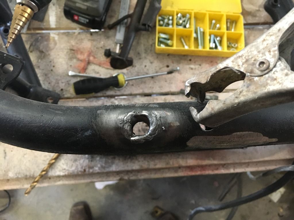

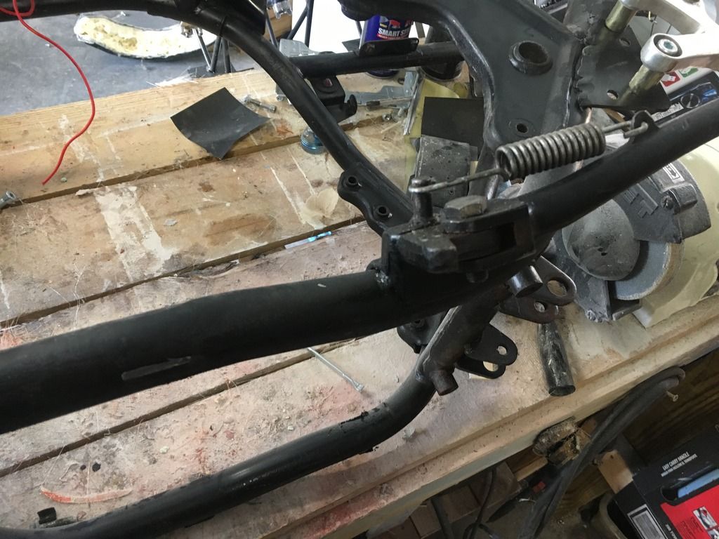

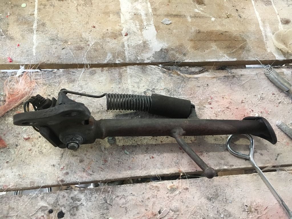

Then I set it on the work bench and started removing the factory kickstand to make room for the 900RR kickstand. It will be put farther forward on the frame to make room for the shift linkage.
Then I marked and drilled two holes then welding in some spacers for support.
Then after smoothing some things out and a good rinse to get all of the dust off I got ready for some paint.
And this is where I left off for the day

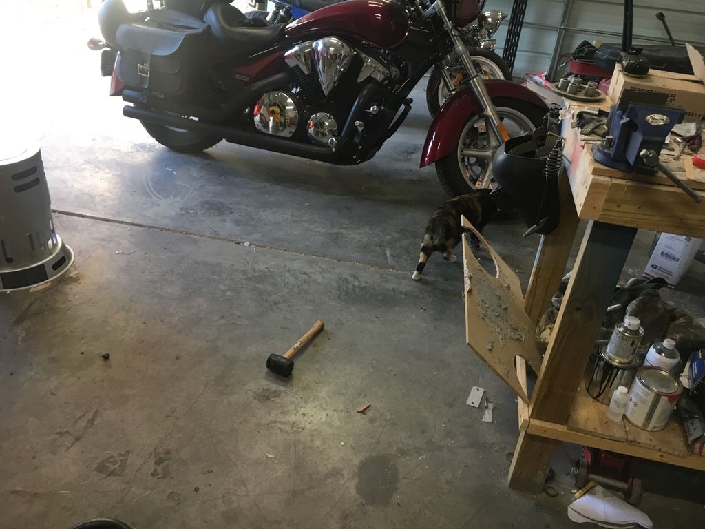

Got a few things done in the shop today. I actually got to test out my new heater since fall has finally decided to show up and its in the low 40s right now. I'm terrible at taking pics sometimes because I get so focused but I will show you what I have.

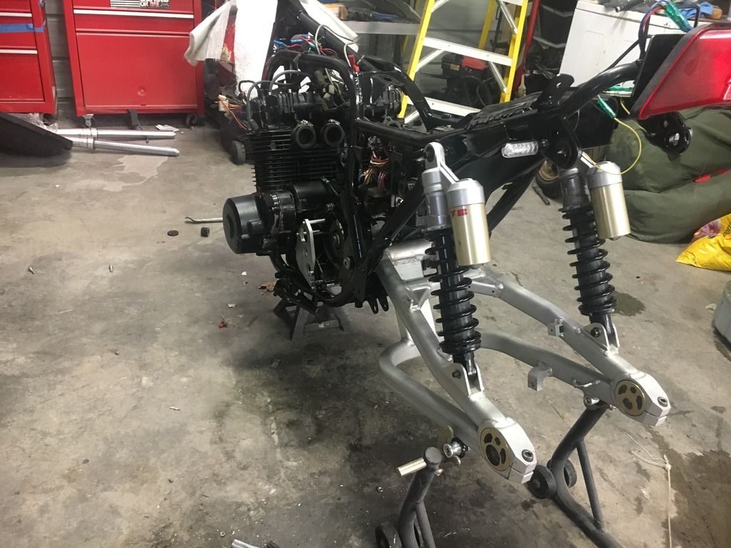

I started with cleaning the engine up:
It was pretty nasty from just sitting in the shop for a year. I got it all cleaned up and also got the swing arm as clean as I could. All I was using was some simple green, shop towels, and a wire brush.
And all back together:
And with the new kickstand bolted up:
Looks like its going to work out perfect. I wont know for sure until I get it back on the ground. I also ordered new steering bearings and one of many ELR decals

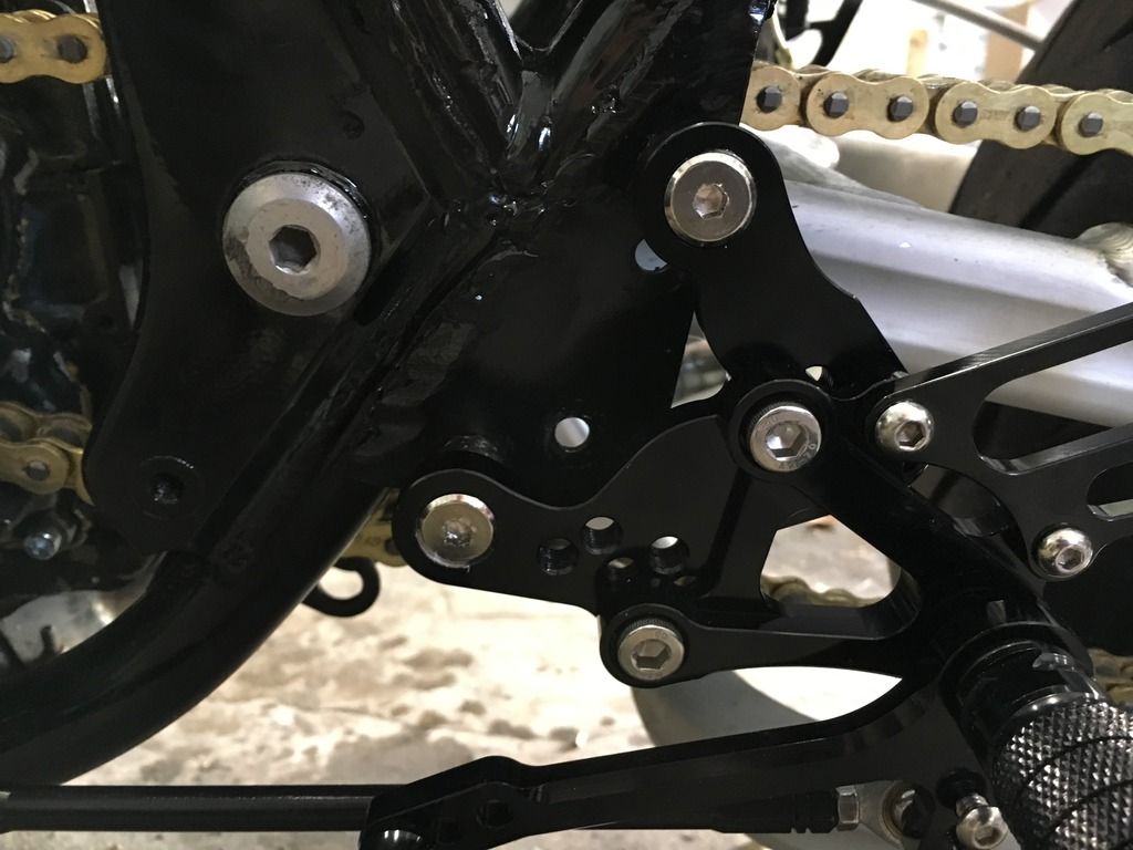

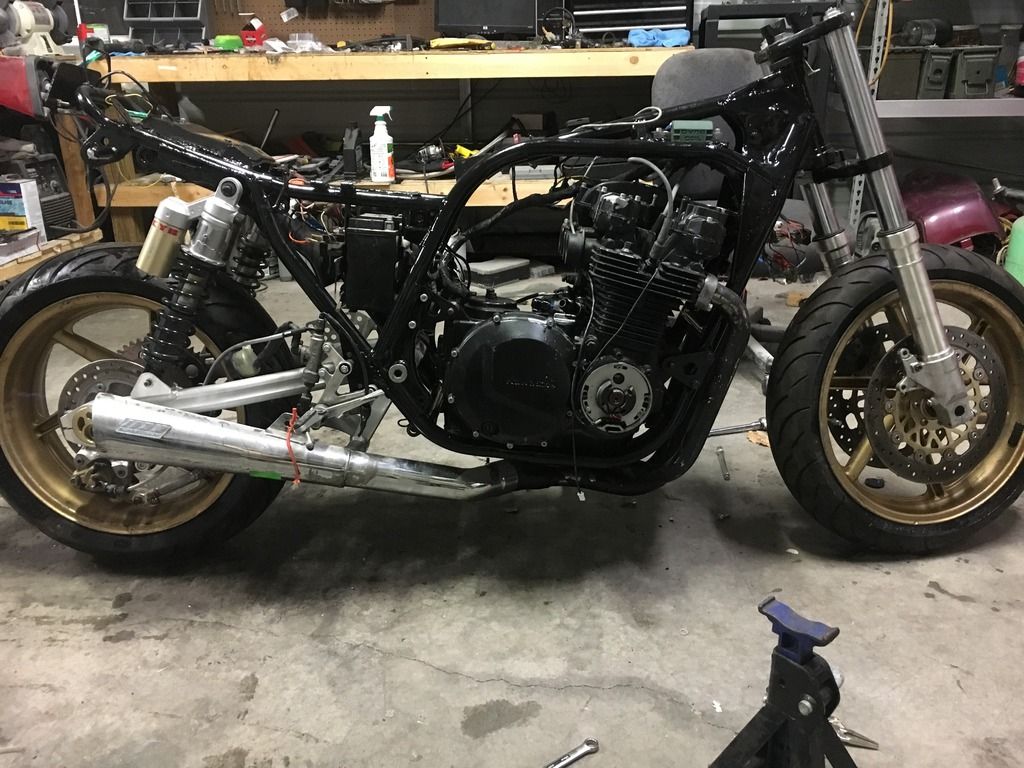

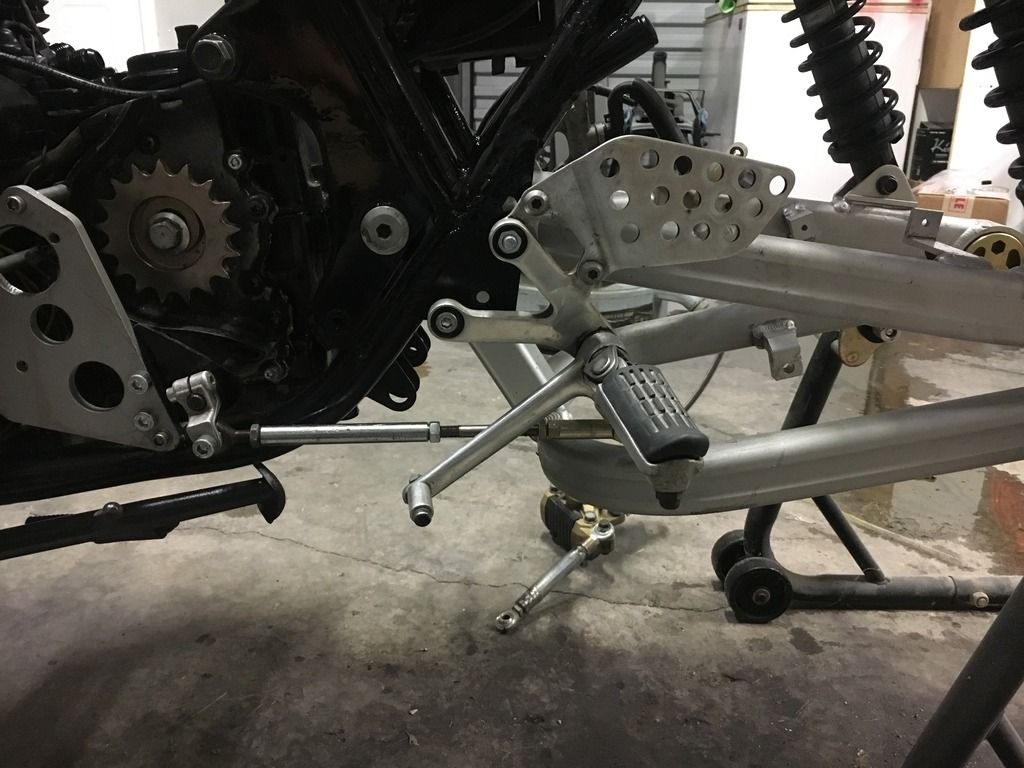

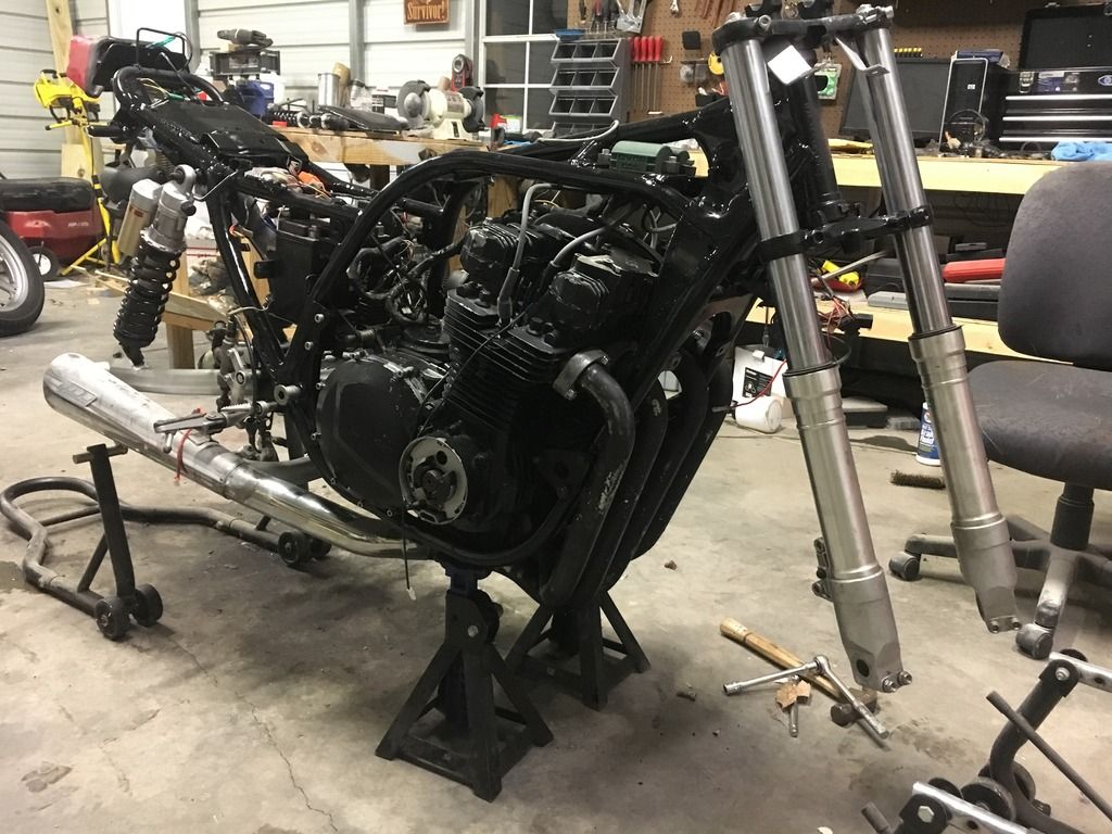

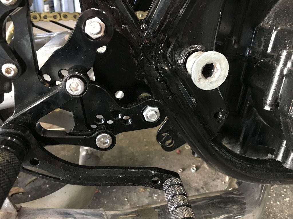

Rear sets back on
Front end and exhaust on

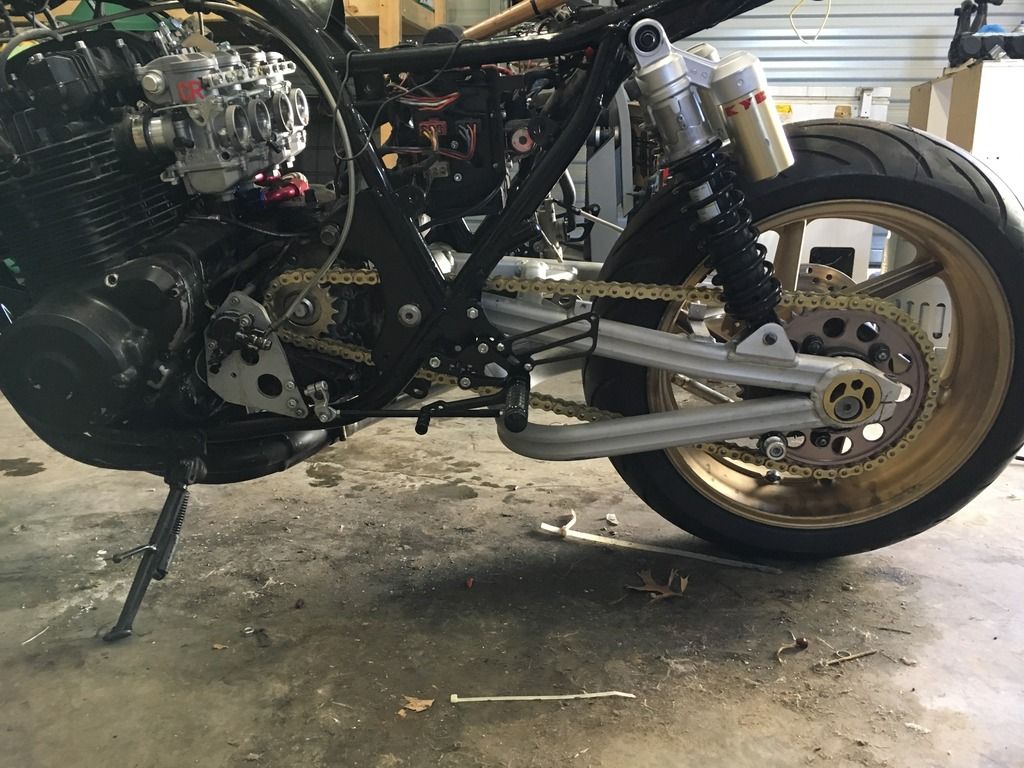

2,956 Posts
I found the slow leak in both tires. The valve cores were loose. Tightened them up and temporarily mounted the wheels to check the lean angle of the new kickstand. It worked out perfectly. Also wound up gaining about an inch with the ZRX shocks. I think the stance is pretty spot on.

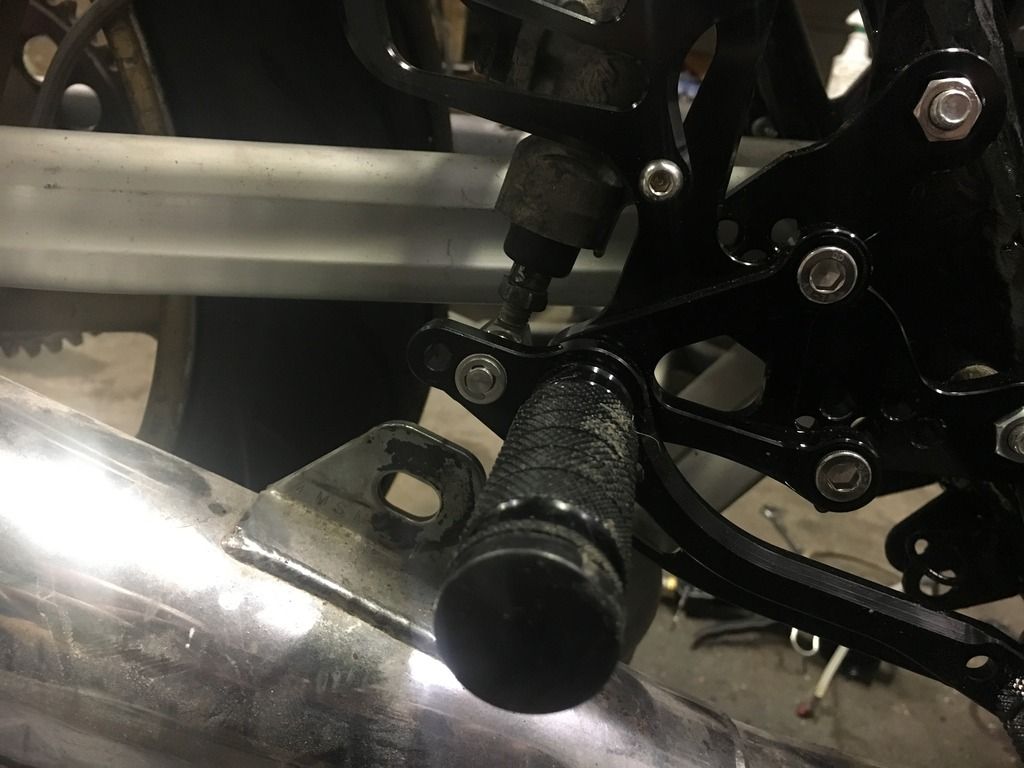

Got some work done today even though i am dealing with a semi hurt back. I got the front wheel mounted back as well as the handle bars and front brakes. I also got the rear sets mounted. They are much nicer than what I had on there

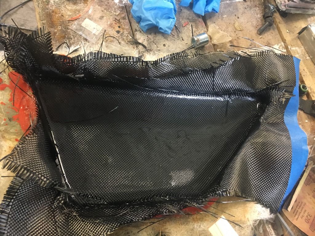

2,956 Posts

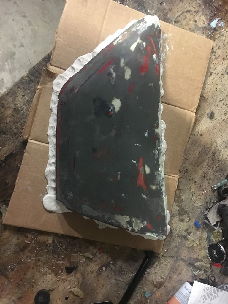

So as you can see in the picture, I did get one side cover mounted. That one is salvageable and will be used. The other one is not so it will be re done. The chain guard for the swinger showed up today. It will be prepped for molding as I plan to remake it out carbon as well. Yes I am hooked!! Also just ordered a set of race tech springs at a much higher spring rate. The stock rate is .763kg and I went up to 1.1kg per racetech recommendations.

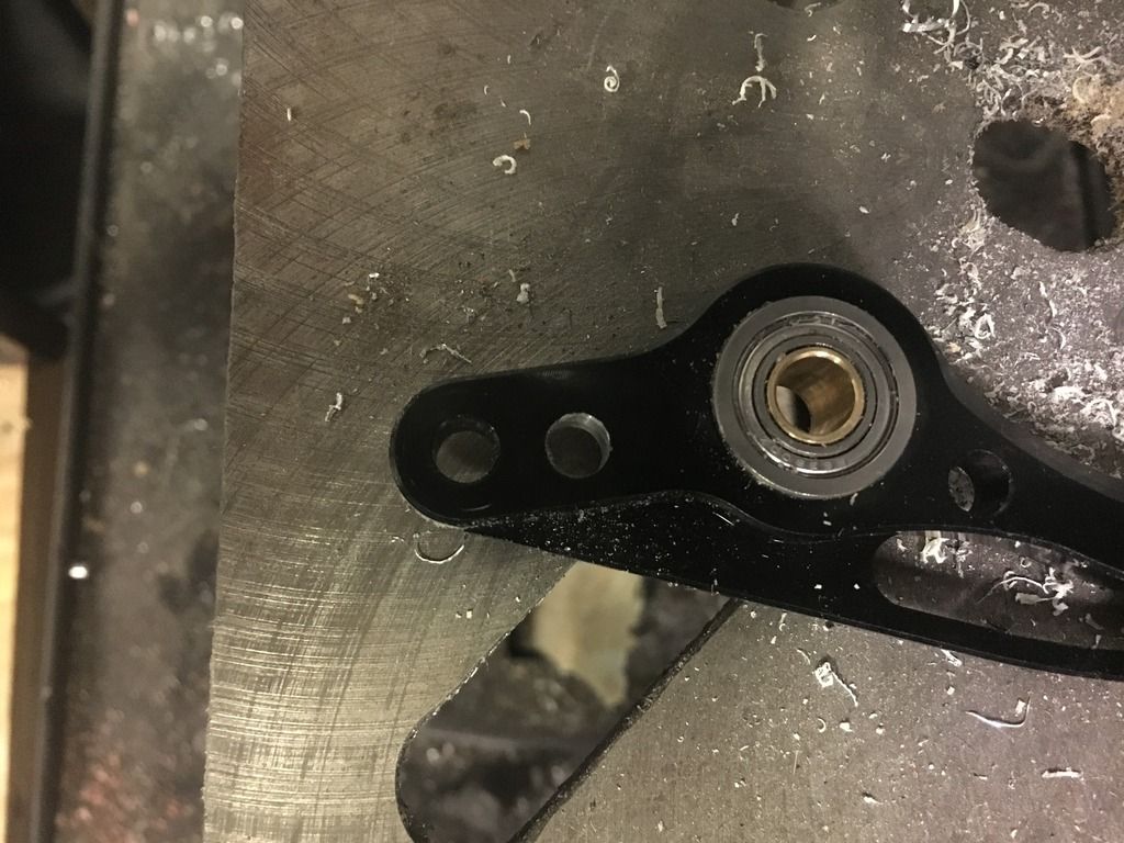

Got a bit more done tonight. My plan was to get the brakes bled but I had to take care of the rear brake pedal first. For some reason the way the pedal attached put the mc at a weird angle
So I used a very exact measuring device and drilled another hole
And now we are in business
So now the front and rear brakes are bled. Still having issues with the clutch but I believe that the slave cylinder is the issue. Even with a new set of seals I can still hear air moving in and out when I pull the lever. Off to eBay I guess

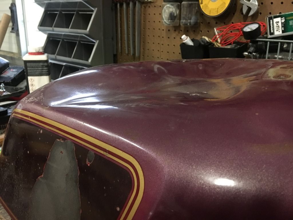

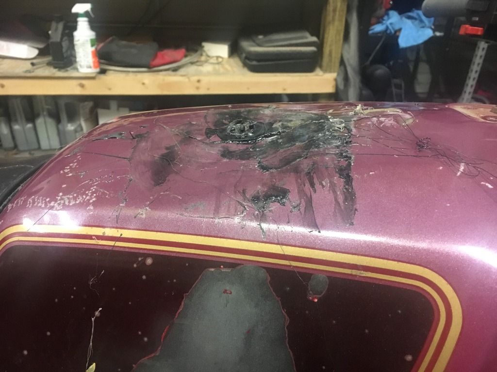

I have a working clutch now. Also almost have the dent pulled out of the tank. Gonna get some more propane after Christmas and will start on the composites

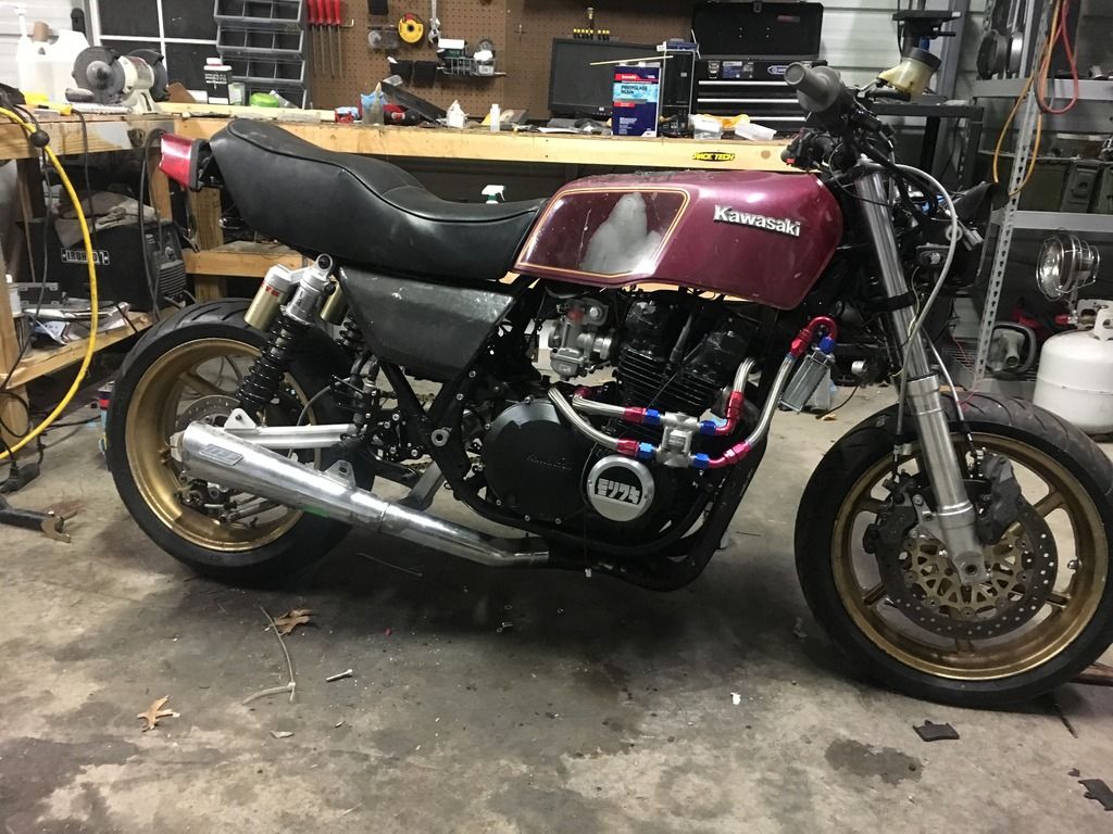

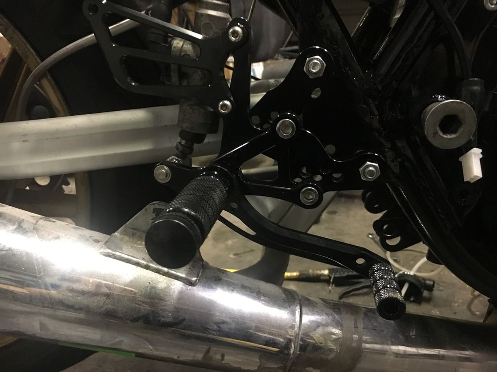

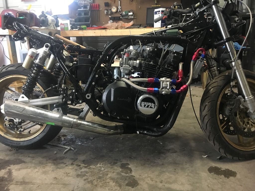

Got the chain back on as well as the oil cooler and the carbs. Also replaced the nuts on the rear sets with some nice Allen key caps
Sent from my iPhone using Tapatalk

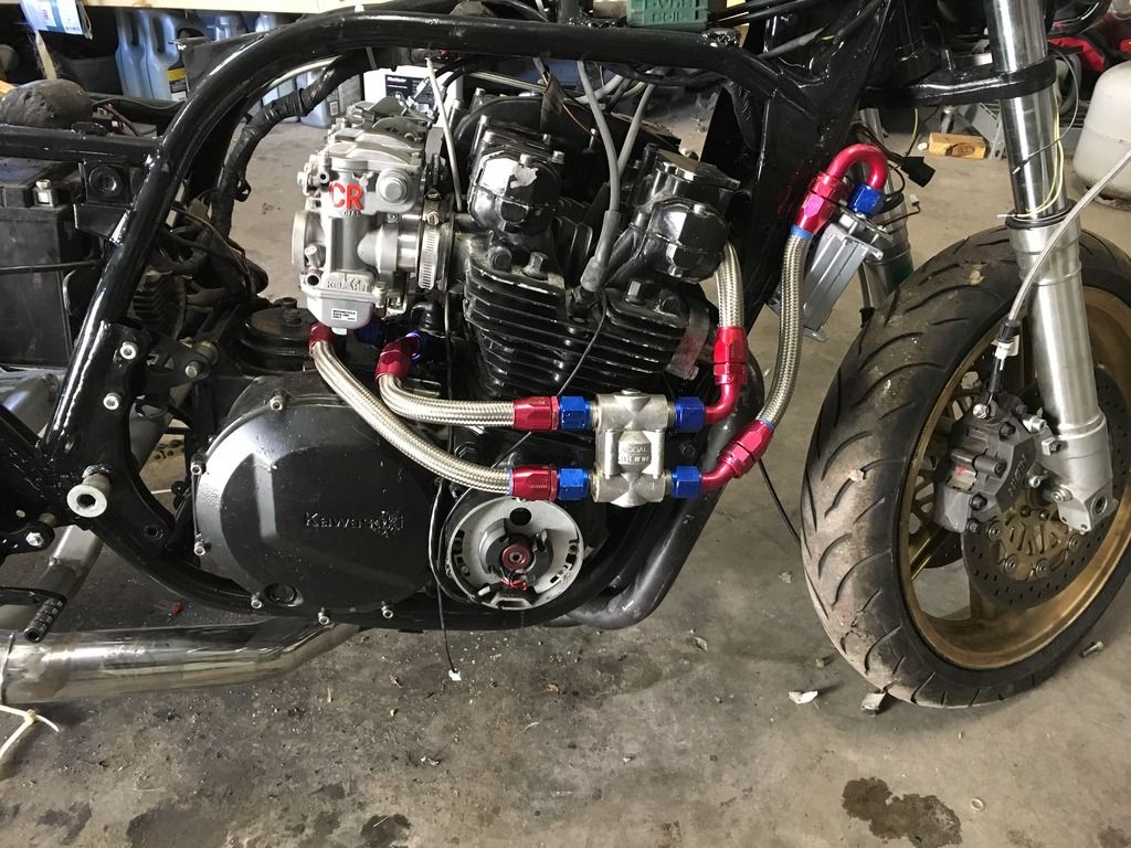

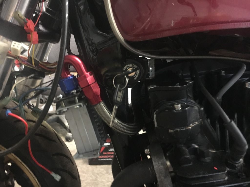

I'm thinking about getting rid of the oil cooler t stat and going with smaller braided lines. Thoughts?

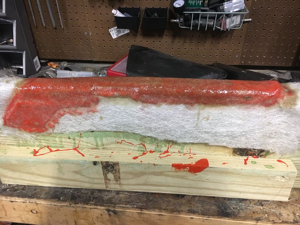

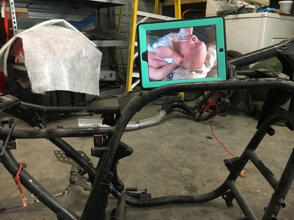

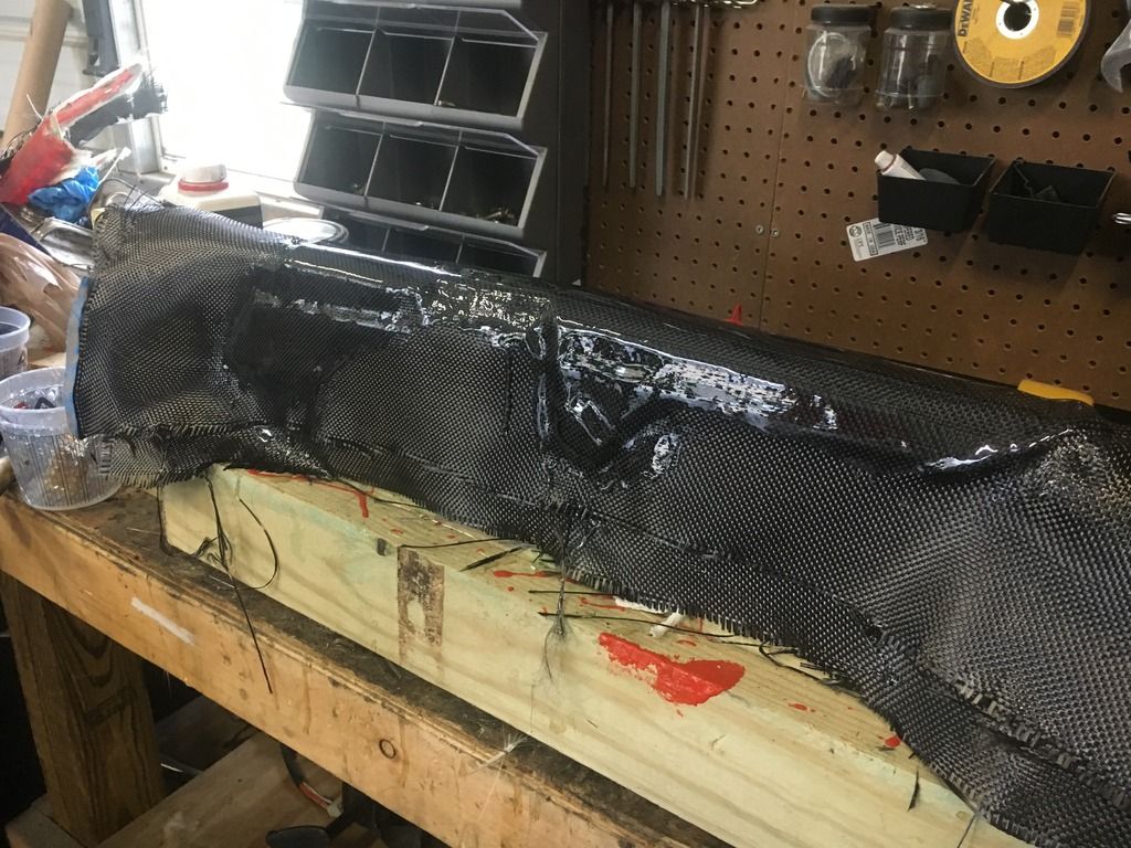

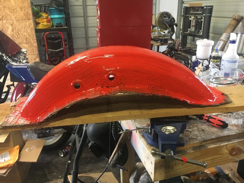

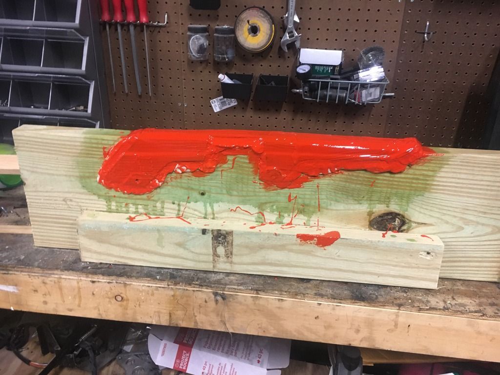

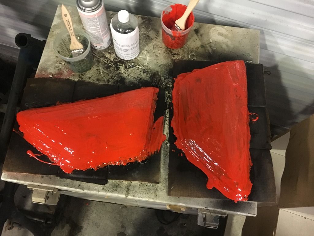

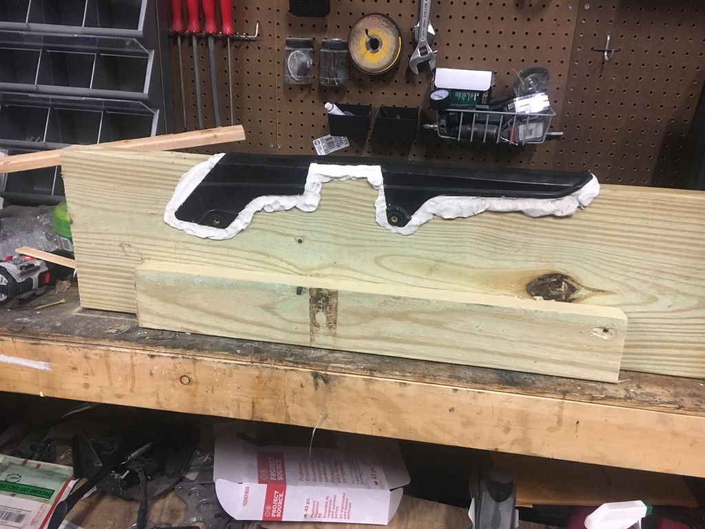

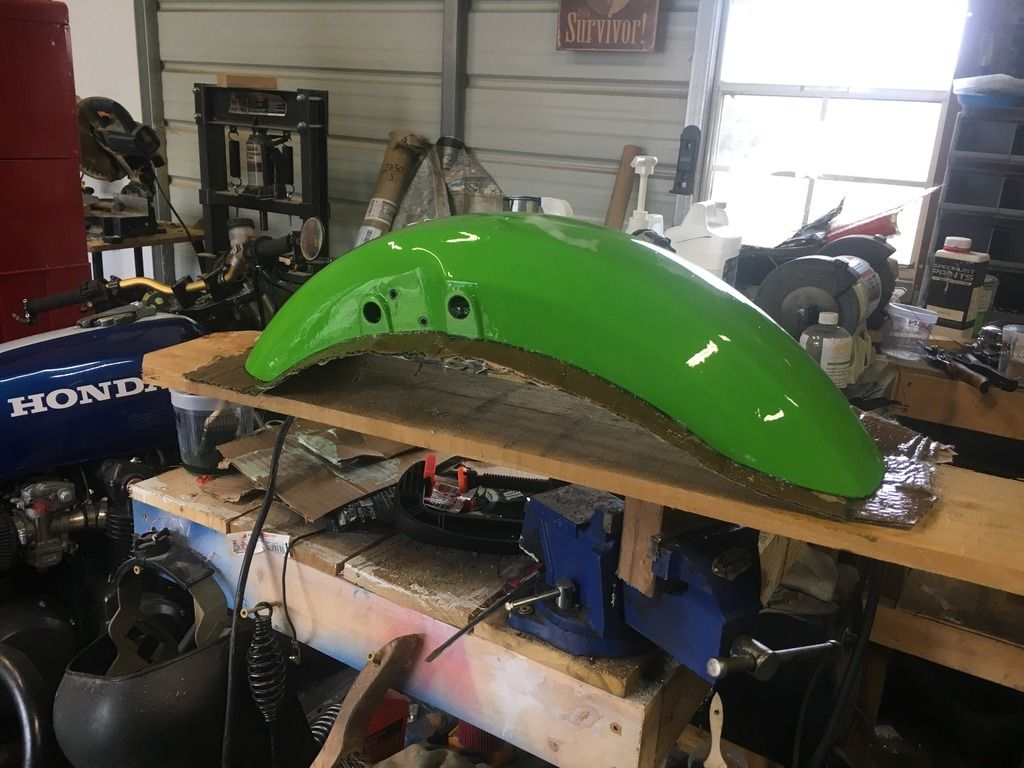

Played around with some clay
And got the chain guard gel coated. Hopefully it will cure over night so I can lay some fiberglass. Then on to carbon.
