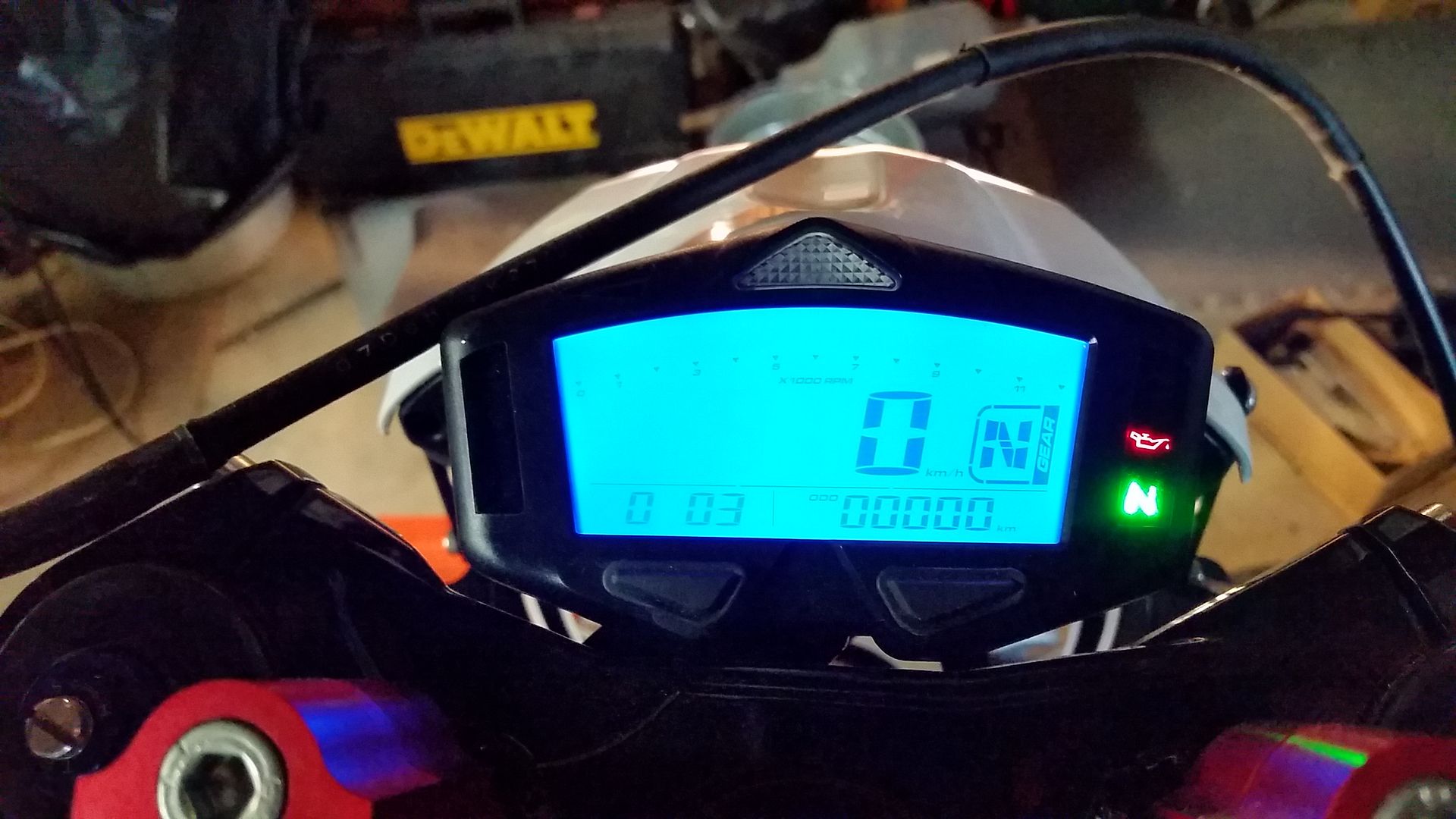

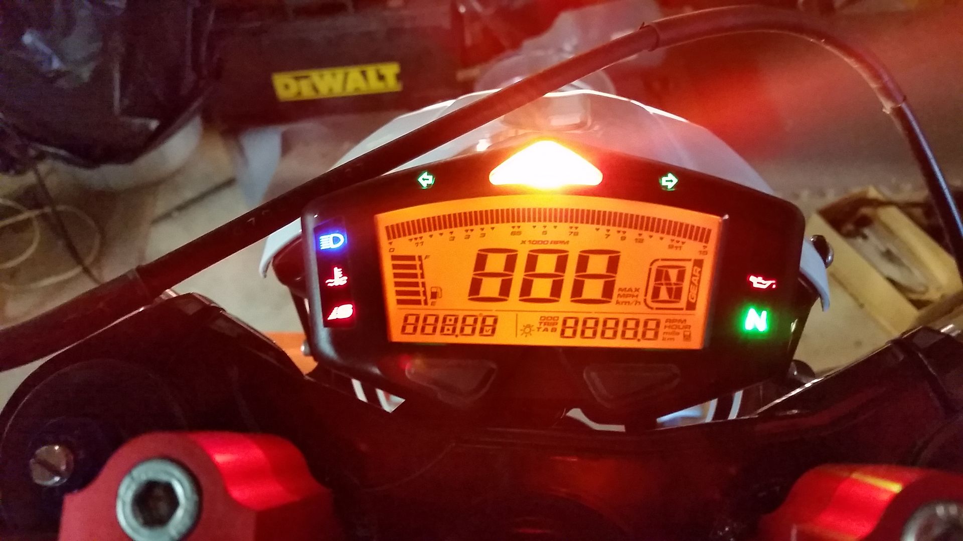

Thought I'd make a separate post about this gauge. I've installed a handful aftermarket digital gauges, and this one stands out.
This gauge was relatively simple to install, and the lights and features are really nice. All the lights are brighter than my DB02R. I have the accessory dash for the DB02R, and it was a bit of a pain to get that set up how I wanted it. The DB03R is very well integrated and simplified.
Highly recommended!

Yes, works on 2 stroke, 4 stroke, play with settings till it works. Comes with 2 options, 1 can be wrapped around a plug wire or plug to pick up spark signal, I chose option B which splices between coil and + coil wire from spark box using spade connectors. Very easy.
I had to set for 1 pulse per Rev on the positive pulse, all in the manual.
