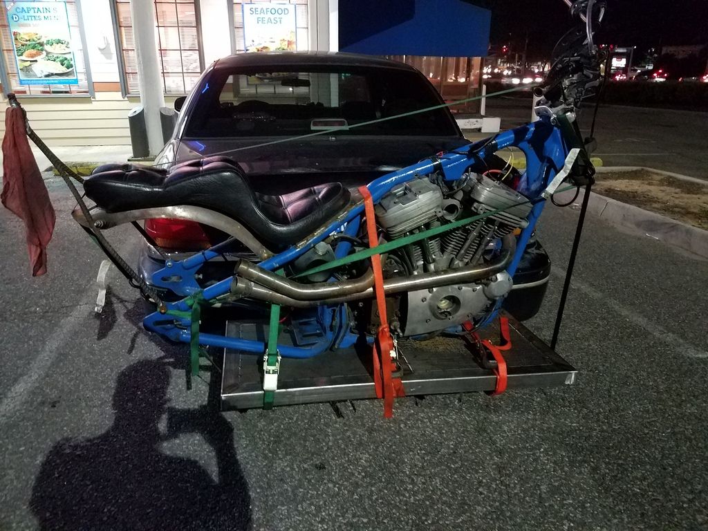

Couple months ago my sister told me my little brother was selling his bike. I'd been following his build on IG and kinda liked the direction he was headed. He just lost interest and was onto something else I was told. Well after talking with him some over the next few months, we agreed on a price, and a road trip was in order. Got up there and the bike was a good bit different than I had expected, but still we made a deal. So I strapped her to the back of the Crown Vic and headed home. Yeah, its a Harley and yes its bloody heavy. Always liked them but never had a hard desire to buy one, until now.

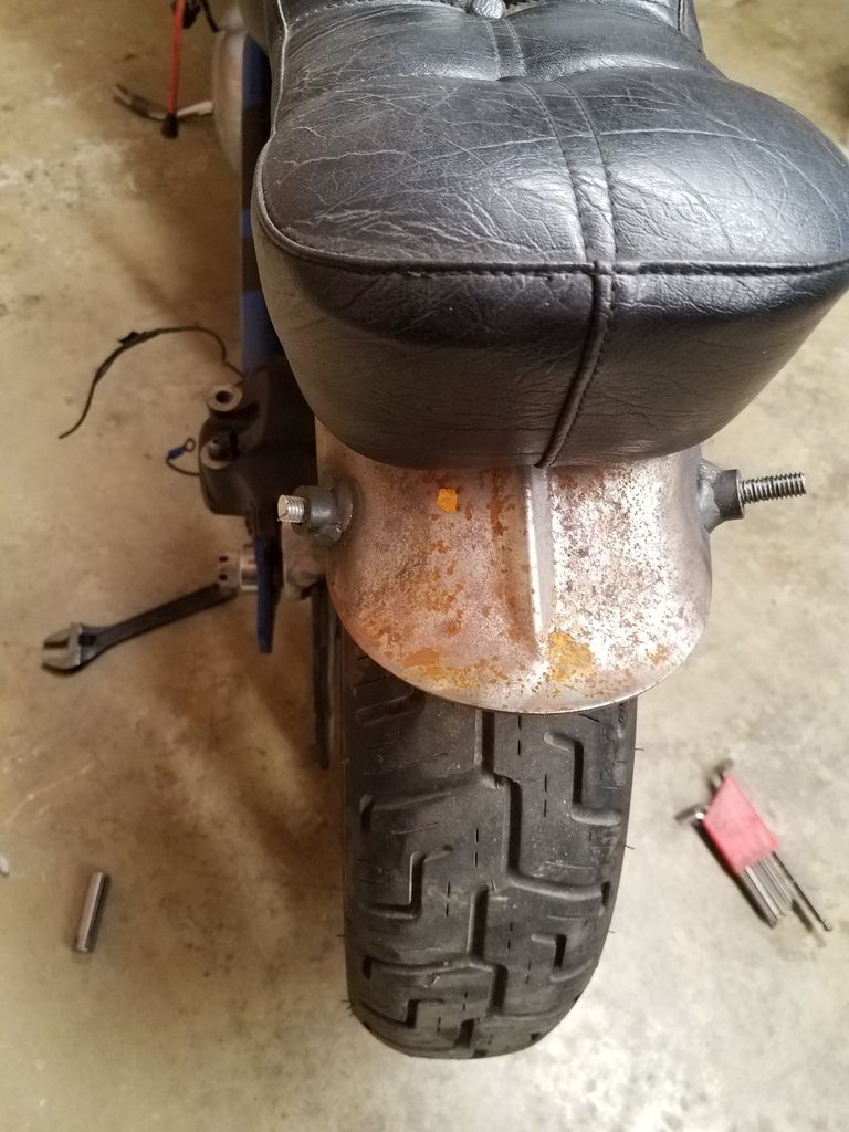

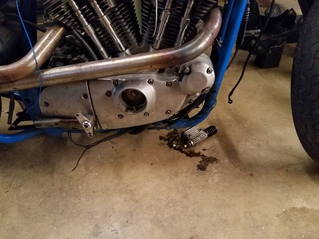

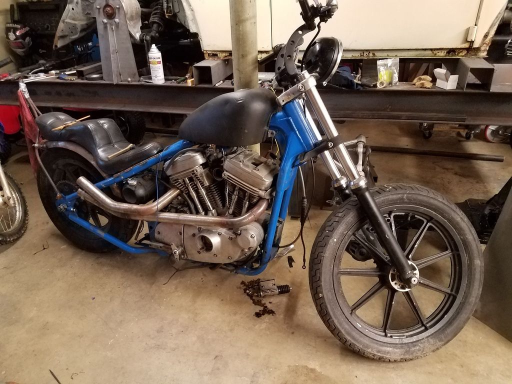

Now I got the bike home and started piecing the pieces back together. Original plan was to finish putting her back together and ride it like my brother built it. But that has changed. I did manage to get it almost together

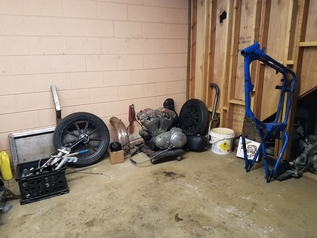

Eventually the OCD won and now I'm staring at bits and pieces. Luckily these bikes lend to all sorts of modifications so something cool may come outa this one day
