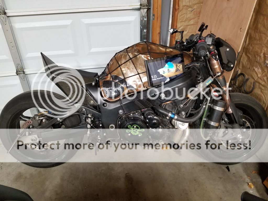

So for those of you just joining us, I bought this bike bone stock for last year's Buildoff and took it from this:
To this:
And that ^^^ is where we're starting this time.
Full specs and info can be seen in last year's thread (link in my sig), but the basics are this:
-2008 Busa
-Big turbo
-B-King trips
-Custom tail
This year the plan is to basically clean it up and squeeze a bit more power out of it. It'll be getting a redesigned tail, maybe new trips and bars, and some engine upgrades however I haven't decided how far I'm going with that this year yet. Looking at some other various bodywork... belly pan, fenders, that kinda thing. Also planning on doing a new wiring harness from scratch because clean wiring makes me moist, and hopefully by the time I do that I'll have finished designing my Keyless Ignition Module and will be able to work it into the bike. Probably doing some engine painting and frame powdercoating and whatnot too.
A little note on the internals.... was planning on bulletproofing the top and bottom end, but due to the fact that I have 5 active builds, 2 in the Buildoff, and have been living off savings since May (really since April) I'm just going to be doing the top end this year. Should hit mid-high 300's and will be shooting for as much as can be had next year (probably end up being around 460-500ish).
I'm still waiting on most of the important shit as almost everything is coming from Europe and I'm too cheap for fast shipping.

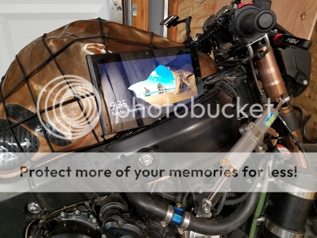

Since most of the big stuff isn't here yet, I threw in some bling I had laying around.
Trying to decide where to mount the adjuster.
Either here:
Or here:
Then I threw some different axle blocks in from a B-King swinger I have on the shelf. Because bling. Also it gets rid of the stupid license plate bracket that I've always hated.

Oh, here's the handlebar switch unit. I'll use one button for the high beam on/off through a latching relay and the other will probably end up as the starter button if it'll handle the amperage. I ditch the horn on all my bikes, and I don't use blinkers, so I don't think anything else needs to be on the bars... should keep the it all nice and clean.

Ah, progress. This build seems to be coming in waves of nothing, then lots of doing, then nothing again.
Throttle assembly came in. Giving the Chinese a shot on this before spending 5x the money on European stuff, seems to be decently made.
Pretty surprised, this thing made it all the way here from China in a week. Meanwhile my bar ends have been in transit for almost a month now.
Took the bike down to QuikCycles to pop the engine back in. Brought the turbo along with, and he gave it a prostate exam... stuck a borescope up the oil drain to check out the shaft. 'Twas time for a refresher, so apart it came and it's off for bearings and balancing.
Stuck the filter relocater on too. Old filter, just on there to plug the hole.
Then I took the now less-incomplete bike to work, I wanted to finish up an ARB compressor mount I was building this week and afterwards I figured it was time I do some fabrication on the Busa instead of just bolting pretty parts on.
Started with something easy. Don't need that annoying kickstand safety switch tab anymore...
Figured I may as well toss in that adjustable stand that's been on my shelf for months. More for the machined appearance than the adjustability.
Though now that it's on there, I think it sticks out too far when closed. The new stand is just a few degrees more bent compared to stock, and it's enough that it's kind of bothersome. Will see how it looks with all the other stuff on the bike.
Forgot to get an after pic of the kickstand + bracket after install. Nothing special, it's just smaller and blacker (giggity).
Then I fucked around with the tail again, but for real this time.
I like it here. Angle of the seat matches the front of the tank, an as a bonus the angle of the rear face kind of matches the angle of the forks. Was more concerned with the seat/tank bit as they're closer in proximity.
Made up some numbers and turned them into lines. Normally have more room to work but we had all the cold-blooded trucks stuffed into the shop tonight. You'll see why in a minute.
Turned the lines into codes.
Then turned the codes into parts.
Then the seat pan. Less pretty, but this is more intended to support my butt than to show off.
Forgot to clearance the sides so that the seat could actually fit over it, so that was done with an angle grinder and belt sander.
Then did a final test fit and glued it all together.
Was already 1am and I hadn't eaten today so I wanted to get home. Rushed through the welds and I'm not at all happy with them... thankful they'll be hidden.
