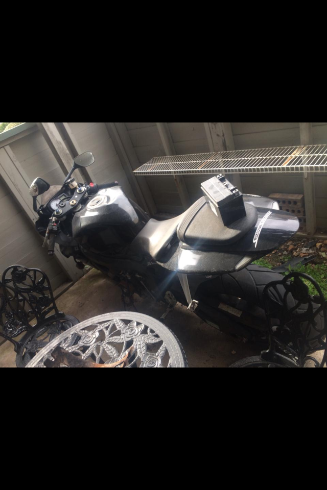

I saved the bike from a friends patio. It had been wrecked.Then someone stole his wrecked bike, wrecked it again. Then he got it back from the police and its been sitting since then.
poor thing

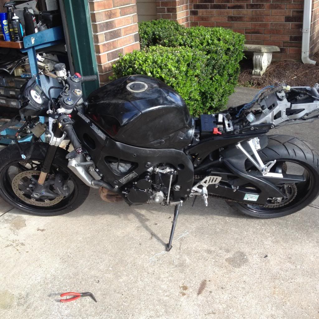

I had to replace the stator and cover. The has tank was extremely rusty,sitting for a year with that horrible e10 gas. Ospho coated the inside of the tank which worked wonderfully. Changed the oil, replaced the battery and she fired right up.
every piece of plastic left on it was broken, so i figured might as well streetfighter it.
picked up a used twobros. slipon for cheap. Got some protaper bars with some dirtbike clamps i already had. My dad machined some nice 1inches risers for them. Started to come together nicely. Can't forget the longer galfer brake lines.
hopefully put a new tail on it soon and some fresh rubbers:thumbsup:

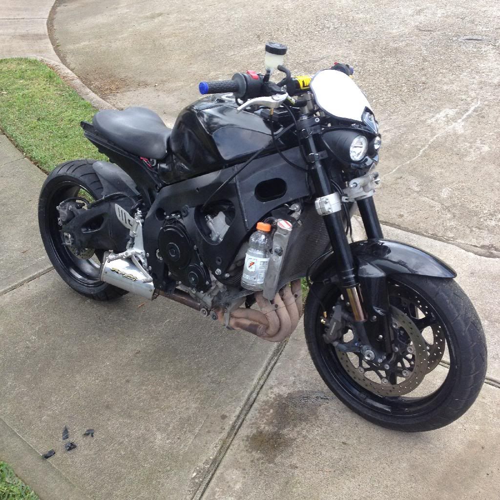

added some grip tape to the tank to help my skinny ass hold on. cant ride without jeans now, unless you want some bloody knees. my temporary light setup til i can put a different tail on it.i poked a hole in my license plate for an led.
excuse the iphone quality
ive had roadrash scrubbed with an iodine sponge before youd think id know better.:muah:
i also mounted the gauges in the tank.
